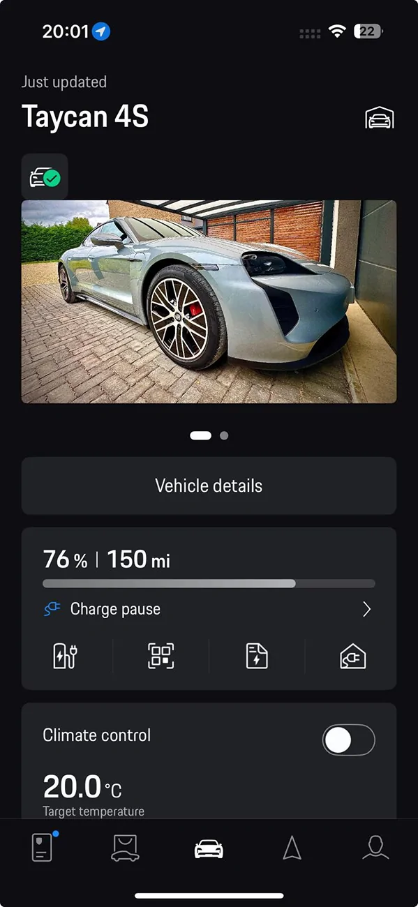

And here's an update, following on post No.27.
I went a step further, before connecting the charger, by deleting the car's Timers.

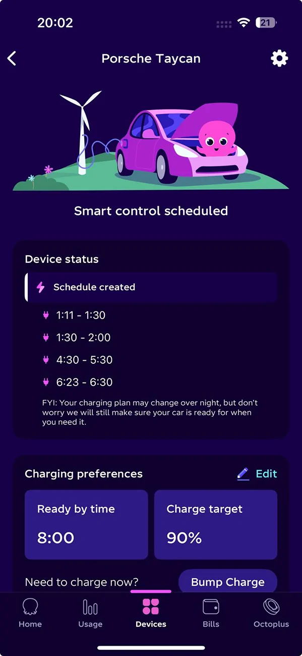

Octo then set up a charge schedule:
Timestamp 20:02
Porsche Taycan Intelligent Octopus Go 1762117137934-nd
Quick check.. the total scheduled time adds up to ca. 2 hours so it was planning to add ca. 14kW. Perfectly good plan, as the car was already at 76% at this time.
Here's the status on P Connect at the time:
Porsche Taycan Intelligent Octopus Go 1762117809215-ki
So after a handshake, it had gone into 'Charge pause' and now await 01:11 and Octopus control and to complete charging by 06:30. All good & ready!

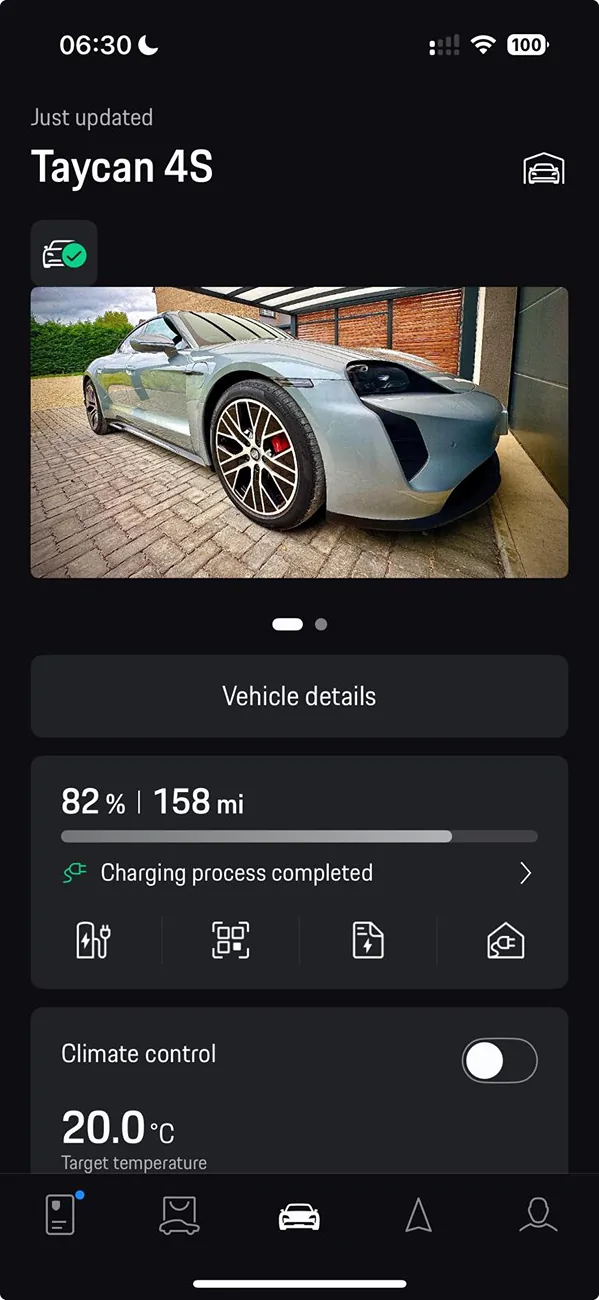

FF>> to this morning 06:30
I was pleased to note that my phone has charged from 22% to 100%.. but what about the car??
Porsche Taycan Intelligent Octopus Go 1762118284244-sk
Car has gained 6% and reports for duty - 'Charging Process completed'.

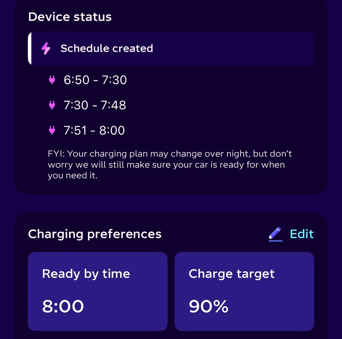

And what does the Octo app have to say about this? Interestingly, the schedule had been updated during the night and they were still trying to top it up!!
Porsche Taycan Intelligent Octopus Go 1762118652555-iu
So all smiles again - Octo are still planning to scramble to 90% by 08:00 and charging is to commence in 20 min ie by 06:50. Brilliant scheme!

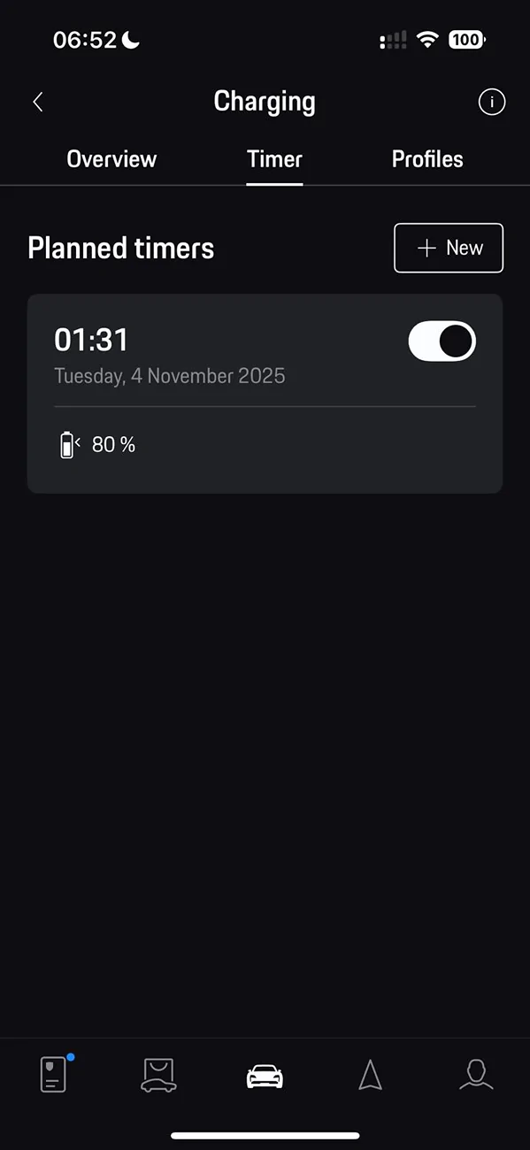

But then it didn't.
And by 06:52 I had found the issue. Which I'm not sure Octo can solve - but I'll tell them.
Here it is:
Octo adapts schedules dynamically, and often (as in these schedules above) split across numerous slots. That's how their model works, shifting grid excess efficiently. Or trying to - unless the integration with the car is problematic - which it is:
Here's what P Connect (also) showed this morning:
Porsche Taycan Intelligent Octopus Go 1762119269418-u
A very random timer, out of nowhere! Wasn't me and not the type of prank my wife would pursue. The car? Octo?
Bottom line, the integration is not up to standard.

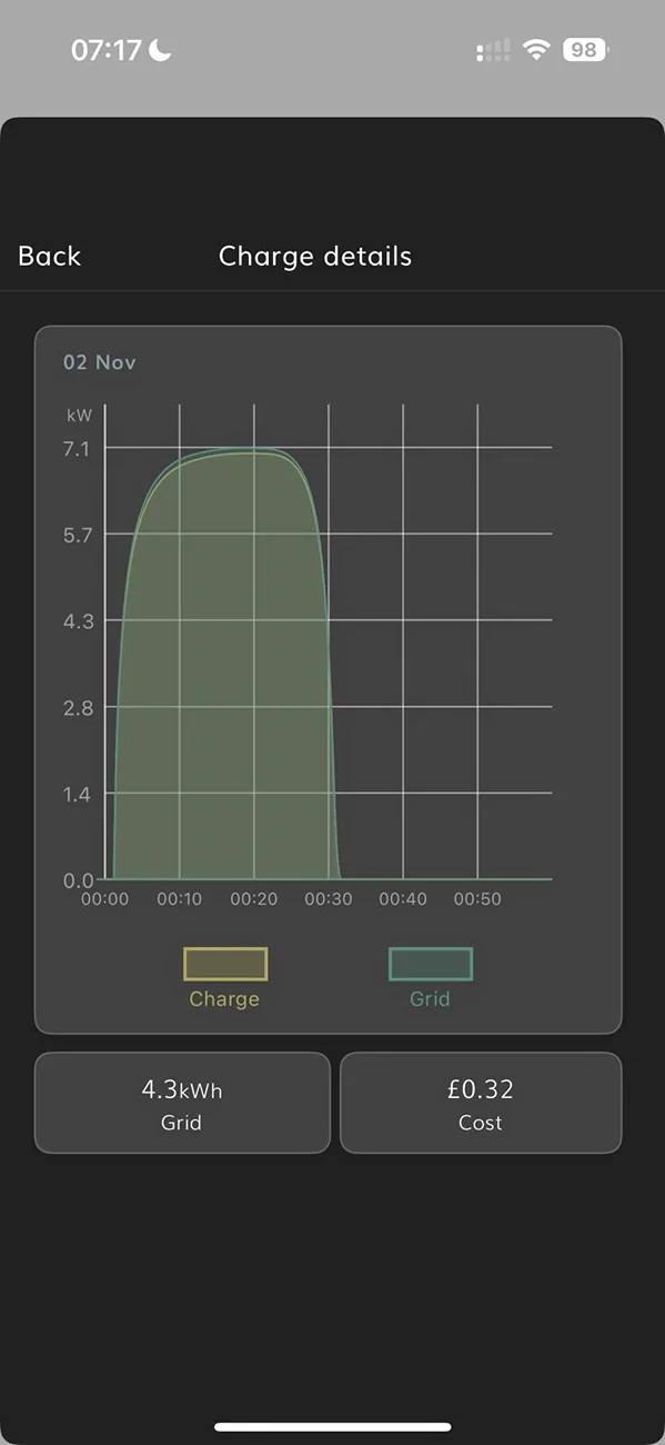

I did one more check - on the Andersen app, I found the charger was used once off last night from 00:02 to 00:32 - this lines up with the 6% charge increase overnight. It doesnt agree with the original Octo schedule, but that would have updated after I stopped keeping an eye on it last night.
Porsche Taycan Intelligent Octopus Go 1762119816582-q
So Octo had one shot at charging the car, it added 6% and then the random timer (above) appeared, after which Octo had no chance. While It had most likely continued to create new schedules each time when it could not execute its own plan, it could not get past that silly timer.
Yep, Octopus. I suspect they set a 'random' timer in order to limit the total charge, usually a few days out.
I found Octopus's integration with the Taycan to be unusable so I rely on them controlling my Zappi now; I use a single profile in the car to limit the total change.
