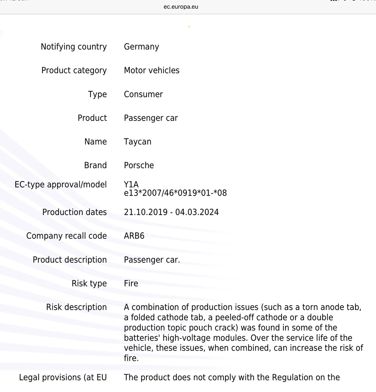

The J1.2 was not part of the recall though. But the problem was known at Porsche for a long time.
ARB6/ARB7 is just one of the recalls, there are others as well.
The ARB6/7 was a software update for all the earlier cars to make the monitoring of modules tighter, it applies to all the pre-FL cars not part of the actual recalls that had known defects.

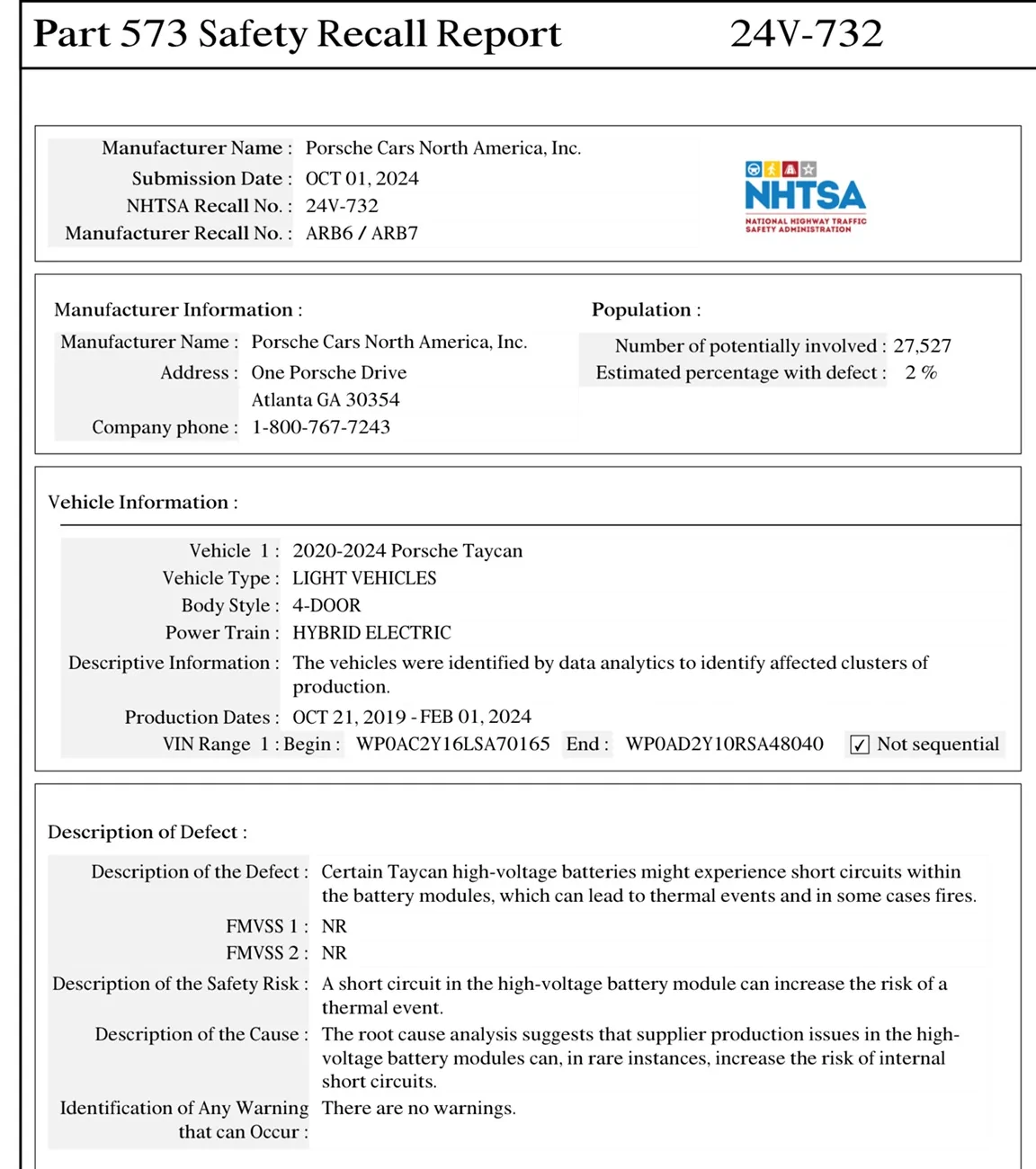

The cars that were 100% considered problematic are outlined here:
https://static.nhtsa.gov/odi/rcl/2023/RCLRPT-23V840-4026.PDF
Here:
https://static.nhtsa.gov/odi/rcl/2024/RCLRPT-24V215-9738.PDF
And here:
https://static.nhtsa.gov/odi/rcl/2024/RCLRPT-24V217-1217.PDF
You can see it's a pretty low number of the overall population, and pretty much non-existent in 2nd half 2023 already. This is because the issue was pretty much fixed in 2023, but of course the older stock wasn't, and some of it found it's way into cars produced late 2023 and early 2024.
This also agrees with the information I have from inside Porsche...

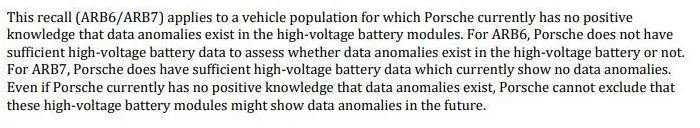

Initial Porsche recalls were based upon analysis of a sample of logs. The sw accuracy is unclear.
In the end, by the final recall, Porsche could not convince UK, EU and USA regulators that the entire j1.1 production run was not at risk. Those guys need more than anecdotal hearsay.
