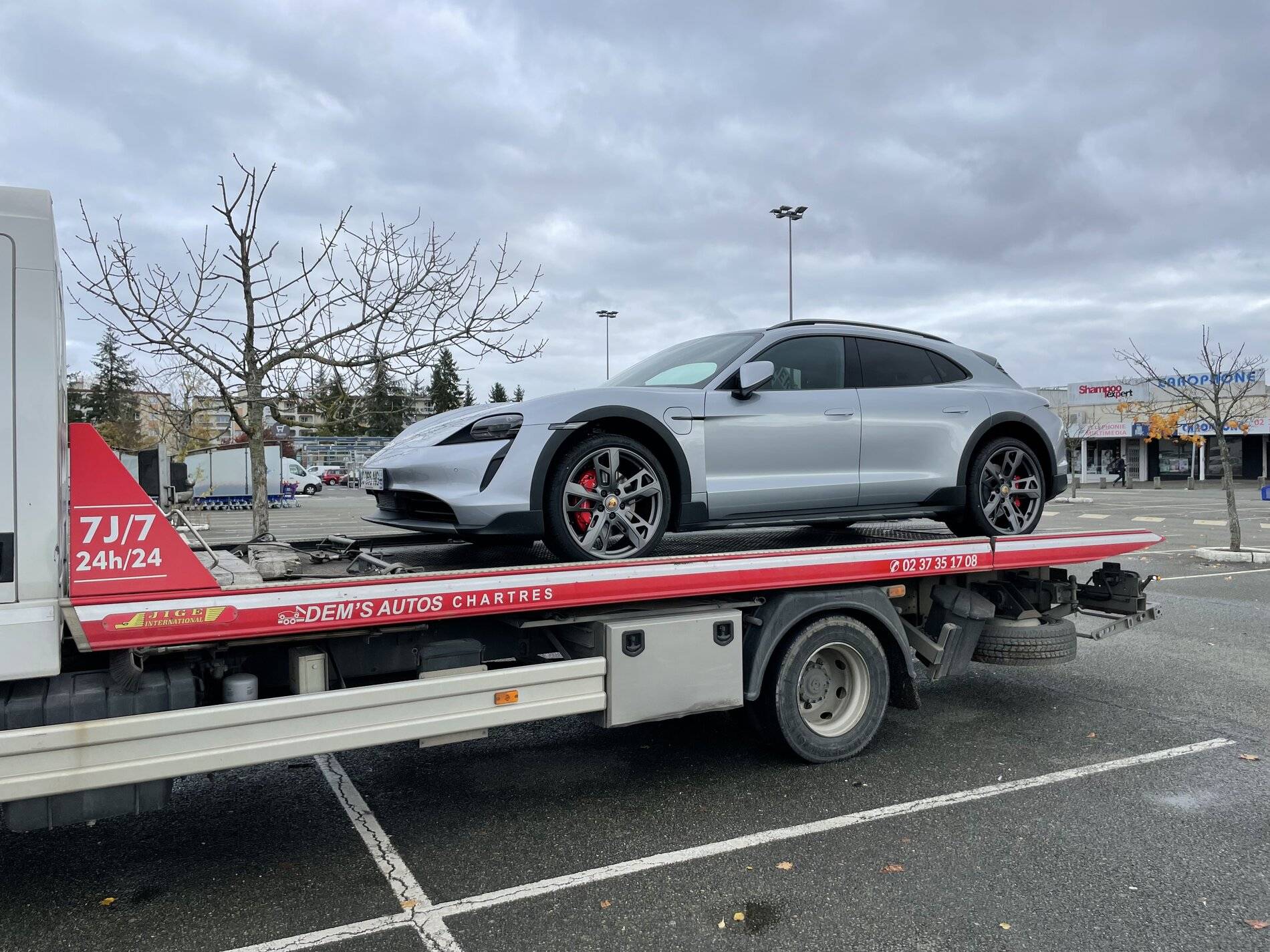

Just had my MY22 CT4S towed today on the way back from my first trip. Communication error… the other cars had no problem with the same IONITY chargers. Only had the car for 2 weeks so I consider selling it now … can’t imagine having to face the same issue on random trips. My wife is so p…d off to have to ride back home in a taxi. Too bad it was an amazing ride for a couple of weeks.

Thanks I wish I had seen this video before calling the tow truck. The thing is I had the same issue with the TOTAL stations - could this video apply to ANY network ? The day before I had no issues with other IONITY charging stations.

Yes it can be the same with all the CCS DC chargers. The two small connectors ar the top of the plug are prone to get a bad connection and then charging will give error messages unforunately.
So Total, Ionity, She’ll Allego etc etc May have the same problems.

Well I guess it was more serious than that. The dealer could not get it charged. New charging parts in order. A few weeks without the car I guess.
