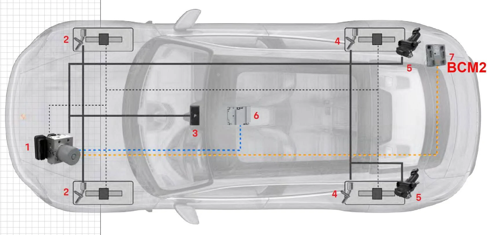

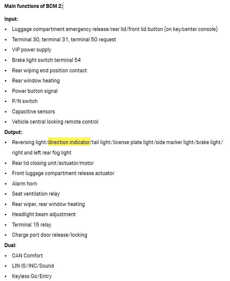

For those interested, BCM2 controls a bunch of things:
Porsche Taycan Looking for BCM2 (Rear BCM) connector pinouts 1716535605971-3u

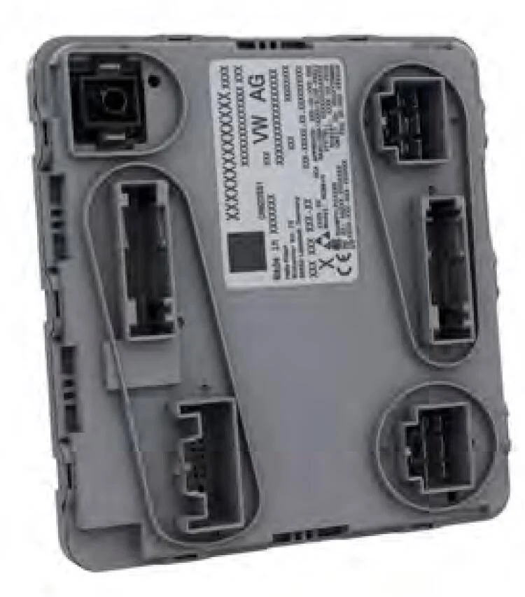

It looks like this:
Porsche Taycan Looking for BCM2 (Rear BCM) connector pinouts 1716535644192-ku

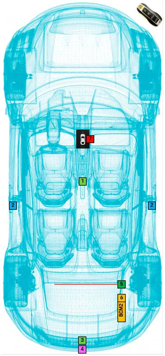

and it lives in the rear right part of your trunk
Porsche Taycan Looking for BCM2 (Rear BCM) connector pinouts 1716535718751-v7
Porsche Taycan Looking for BCM2 (Rear BCM) connector pinouts 1716535747695-m3
