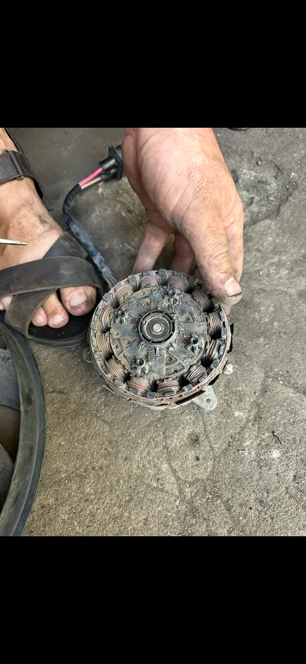

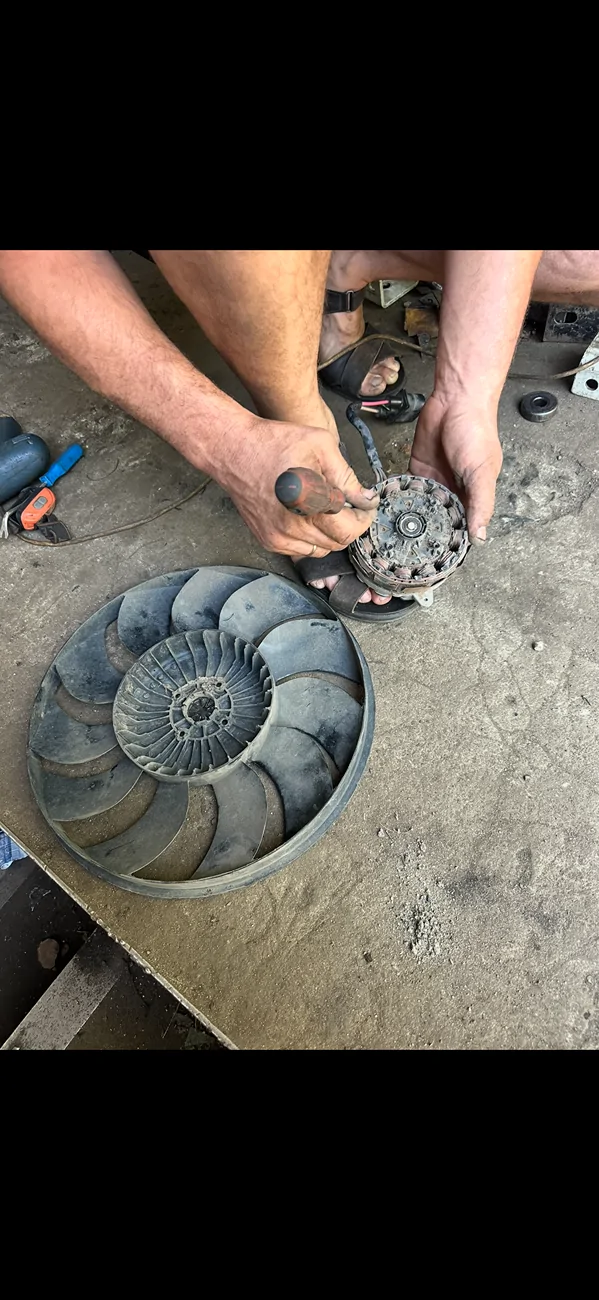

Ser
Aug 6, 2026
Europe
porshe taycan 4s
Assuming this is during AC charging it is definitely unusual. Normally you would only expect to hear the fans during >150 kW DC charging and then only when the battery itself is very warm.
Usually due to either high ambient outside temperatures or after a high-speed run and then stopping to immediately DC charge.
Here is what info would be helpful:
  1. What temperature is your battery (from the dashboard) when AC charging and the fans are on?
  2. What is the ambient air temperature?
  3. Is this after a high-speed drive immediately beforehand?
My fan turned on even when charging from 220V and a regular 16A charger (3 kW).
Also, on my 4S, at 91,000 km, the fan near the passenger side jammed. Here's a photo.
And yes, we managed to remove the fan without removing the bumper.
But we had to remove the headlight.
