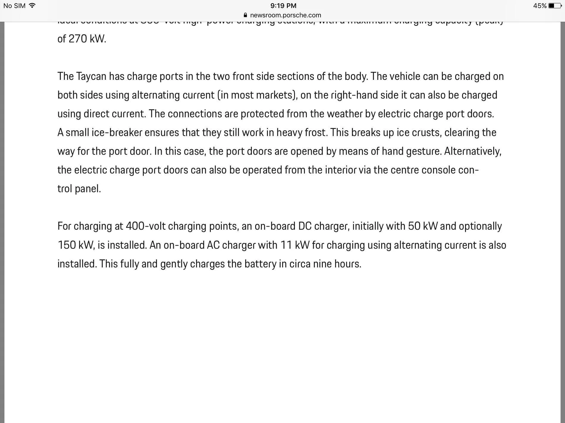

Wonder if the 22 kw might be accomplished by using both charging ports, Porsche says both can be used for AC charging
I recall reading and hearing from Calvin Kim that at least for the power ports are interlocked to prevent both from being opened. That of course cannot be done for the manual ports. I know that the Zero E-Motorcycle can have two level 2 chargers connected simultaneously for more power.

not the Taycan, you can use only 1 x 11 kw like the Model 3 from Tesla. You need 7-8 hours for full charging at home.

Correct, when one charge port is connected the other charge port door is locked. The is a safety feature of the car. It cannot charge faster that 11Kw currently. I really don’t think 22Kw charging will be available for at least a year.

Please don't anyone in the USA get too excited about the charging rate mentioned by @Stefan and @Gogs above of 11kW as that is a European special requiring 3 phase power not available in the USA. We get 9.6kW Level 2 charging, still over night. ;)
About 9hrs if you somehow needed a full charge from near 0%.

I have a home AC station that charges my Tesla SP100D with 16KW and my office Renault Zoe with 22KW. On the same station, the Taycan charges at 9.6KW/h.

I've read numerous articles and technical specs, however, I'm still confused: Is the current version of the Taycan limited to 9.6 kW charging in case AC is delivered to the car or does it charge at 11 kW? Some articles state, that the current onboard charger can do 9.6 kW at maximum, which would mean, that even with 3 phase AC current, the Taycan would only charge at 9.6 kW. Is this correct?
I do understand, that as soon as we talk DC (= the rectifier being outside the car) everything changes.
Could somebody shed some light into this for me? :)
In the UK, with 3 phase AC you can get it charging at its max of 11Kw. The normal house is the UK is single phase, unless you live in a mansion with a lift! You might have 3 phase. So single phase is 7Kw and you will charge at that at home. The 22Kw potential onboard charger would be useful at commercial 22Kw AC chargers as you’ll get fully charged in 4.5 hours give it take. So for me, I don’t really care about 22Kw on board charging as in public spaces I’ll be plugging into CCS DC 50Kw mostly.
