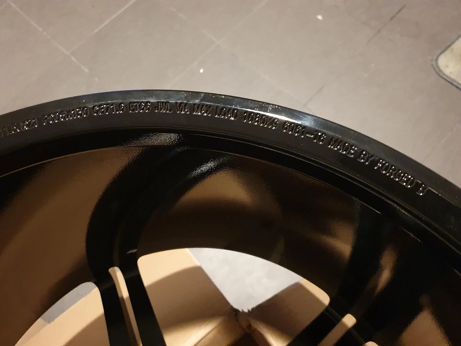

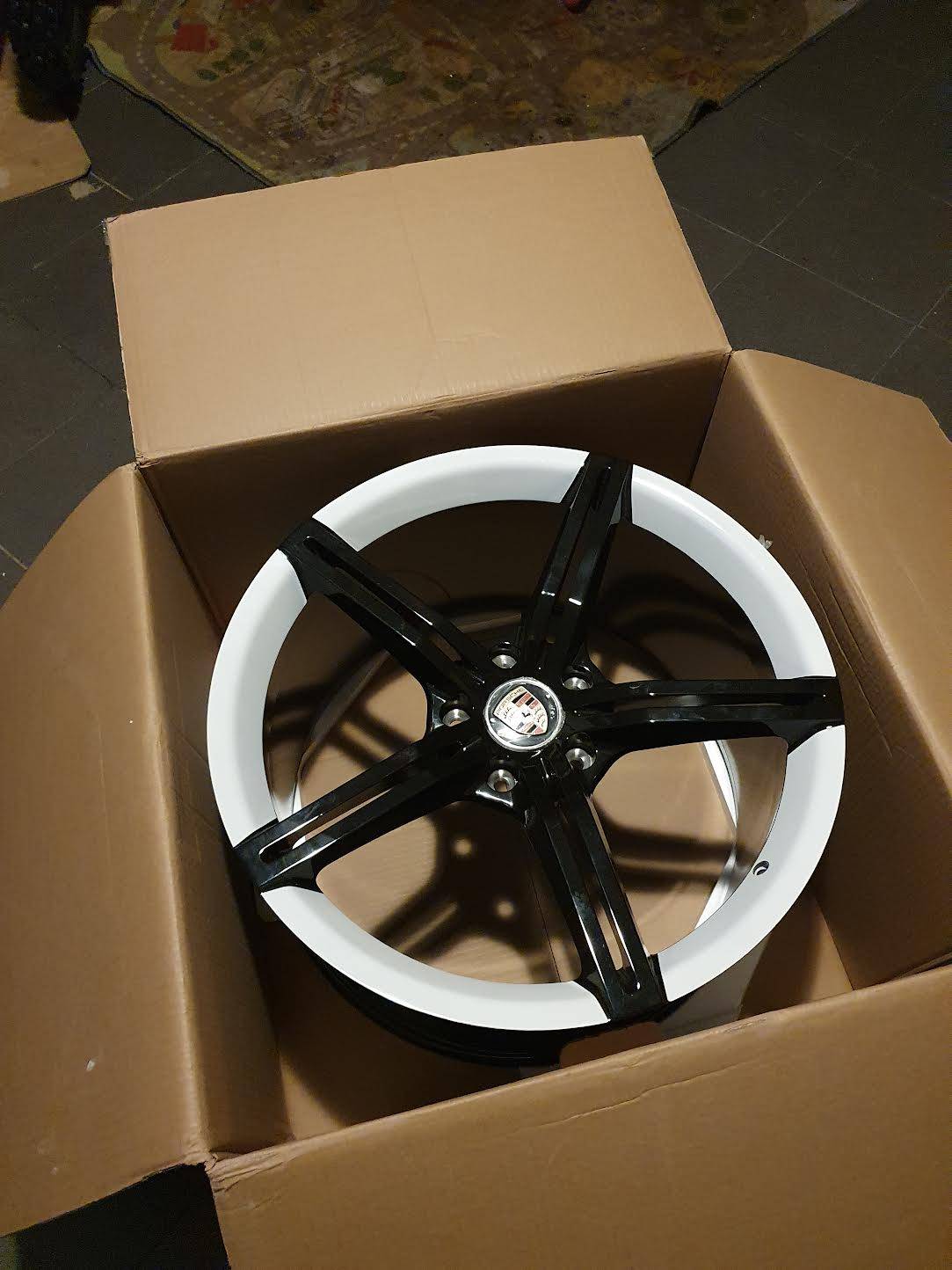

I bought these, made in Italy. ”Looks and feels ok.
Where should I start looking for any problems? (Or will they just crack when I start using launch control?)
How did the rims end up? Do you like them? I literally cannot find anyone selling mission e wheels for less than 6k so I’m considering going to aftermarket route as well thanks
