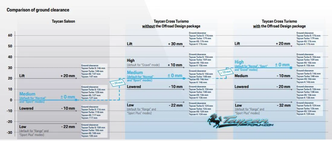

Say there existed a RWD Cross Turismo that were otherwise identical to the RWD sedan model (HV battery capacity, ride height). That imaginary RWDCT would have slightly lower range due to its bodyshape’s effect on aerodynamics.

It’s heavier, higher, and with the trunk worse aerodynamics than the RWD sedan.

CT is not as aerodynamic as the sedan. So, if everything else was equal, it still wouldn’t be as efficient as the sedan.
