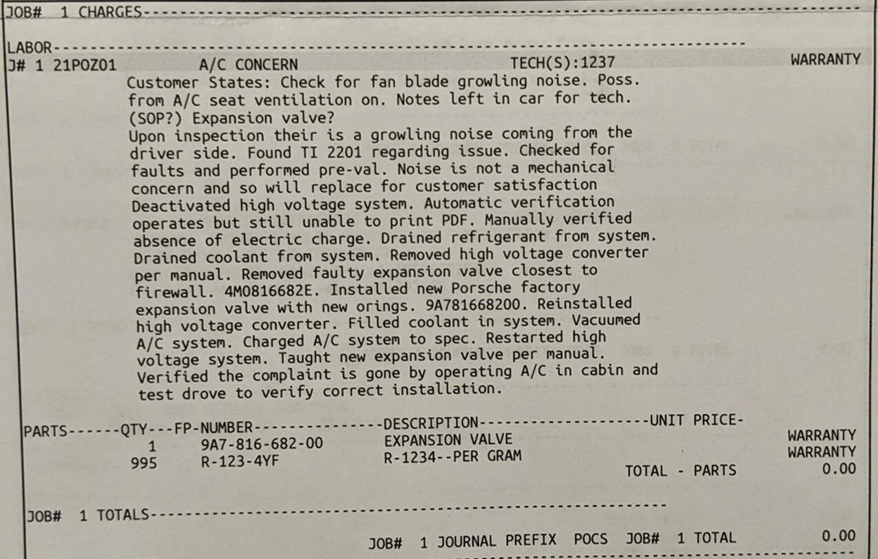

I started hearing the same growling sound behind the dash soon after taking delivery in June 2022 (my RWD was built in April 2022). The sound didn't stop when I turned off the seat ventilation, but it did stop when I turned off the A/C. The dealership looked at it and said it's an expansion valve failure. They ordered a new part (# 9A7-816-682-00) on September 27, 2022. So, I'm driving a noisy Taycan (not sure why yours is stuck in the shop, OP). When the part comes in, I'll drive back to the dealer and get a loaner. I hope this helps.
It's fixed! It took a lot of effort to repair. My 2022 RWD was in the shop for two weeks to replace the expansion valve, and I got a Cayenne for a loaner. The effort is summarized below:
