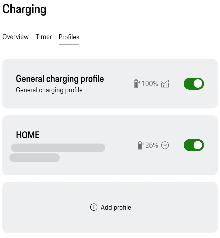

Here's what I have and why:
Porsche Taycan Navigation charging recommendations - oddities 1697914929199
The General profile is set to charge to 100% with "optimized" charging.
The "Home" profile is set to timer based charging with a minimum of 25% and prefered hours between 11:00 PM and 5:00 AM when I pay $0.08/KWh.
Upshot is, if we plug in at home, the car tries to charge immediatly to 25% then waits until electricity is chaper. If we plug in anywhere else it charges to 100%

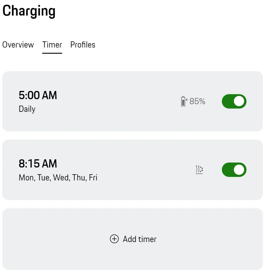

Timer 1 is set to charge to 85% with the charge being done by 5:00 AM when power costs increase. Could be set to a later time, but if it's going to take more than six hours to reach 85% it will start charging earlier rather than after 5:00.
Timer 2 is the one that pre conditions the car about the time my wife leaves for work.

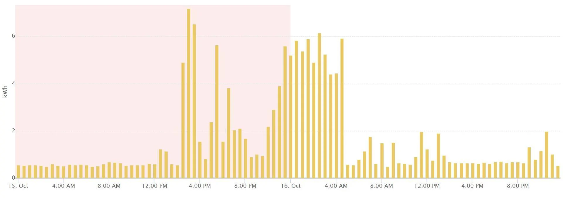

You can see it working in the graph of our electric consumption when we came home with a 12% state of charge after our robotics weekend last Sunday.
Porsche Taycan Navigation charging recommendations - oddities 1697916221214
You can see that we plugged in at 2:00 and the car charged to 25% and stopped. Then at about 11:00 it started charging the rest of the way to 85% finishing at 5:00 AM.
If it had been a weekday, the EVSE would have locked out the charge until 8:00 PM (we pay a surcharge between 3 PM and 8 PM M-F) so the peak for the 12% to 25% charge would have been later.
The only thing I'd like to change is that I'd like to be able to set the minimum charge for a profile to less than 25%. In theory, the EVSE and car should be capable of going from 10% to 85% in the six hour overnight window. The fact that it charged to 25% at $0.10/KWh cost me about 25 cents.
