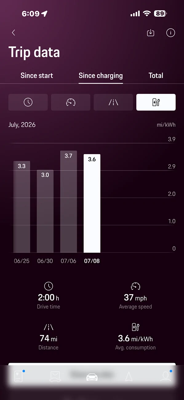

The update occurred around July 3–4, 2026. The trips on July 6 and July 9 didn’t have the same start and end points, but efficiency did improve by about 0.2–0.3 mi/kWh on those drives.
