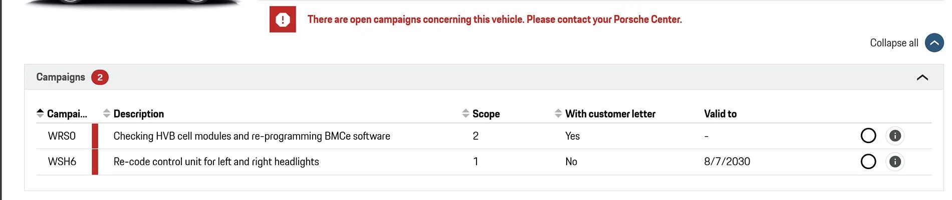

Shug
Harry
Oct 2, 2024
269
106
Manchester
Taycan 4S, Cayenne Turbo, Cayman
I had a cell replaced in the main battery earlier in the year.
Tomorrow they are repeating the battery test and also applying the WRS0.
Hoping for a range increase too.
Currently I see 240 miles range at 100% on my 4S
I have to drive quite a few hundred miles later this week, will report back if there are any real changes.

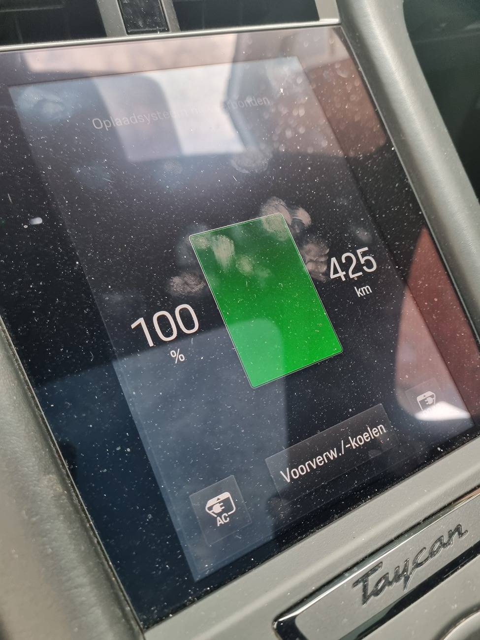

For reference.
The GuessOMeter (DerekS, 2022) @DerekS shows a solid 400km+ on the Taycan CT TS (fully loaded).
Range mode on, A/C off.
However, reality no way I reach that as I simply drive it fast way too often.
But 425 on the GOM is not a bad number.
60k km service done today. Without flaws. Good to go again.

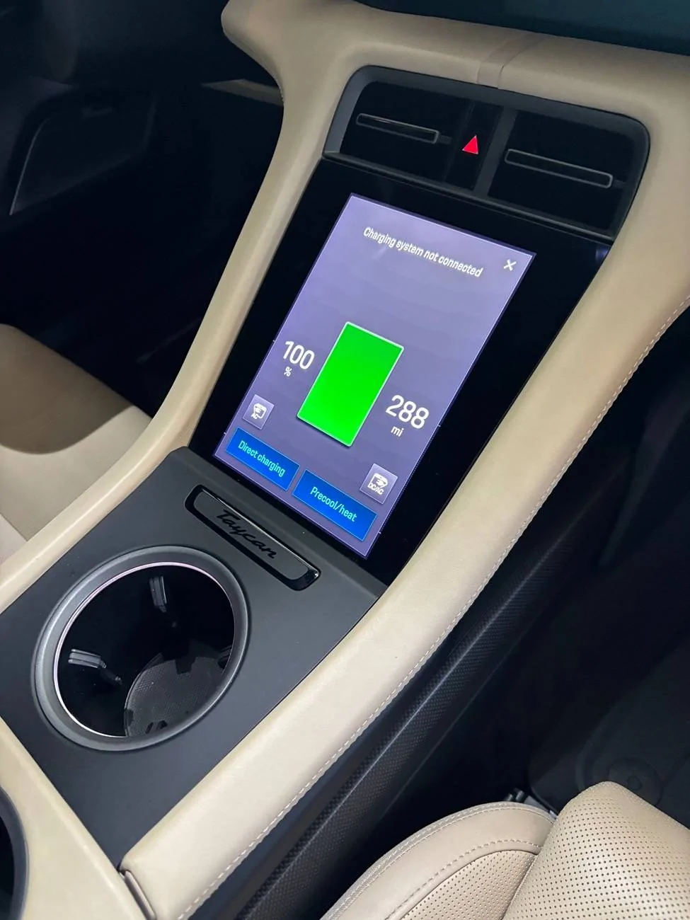

In normal mode my turbo sedan is showing 309 at 100%. Just got it back from the dealer with the supposed J1.2 battery (not sure I believe that I have that battery though).
