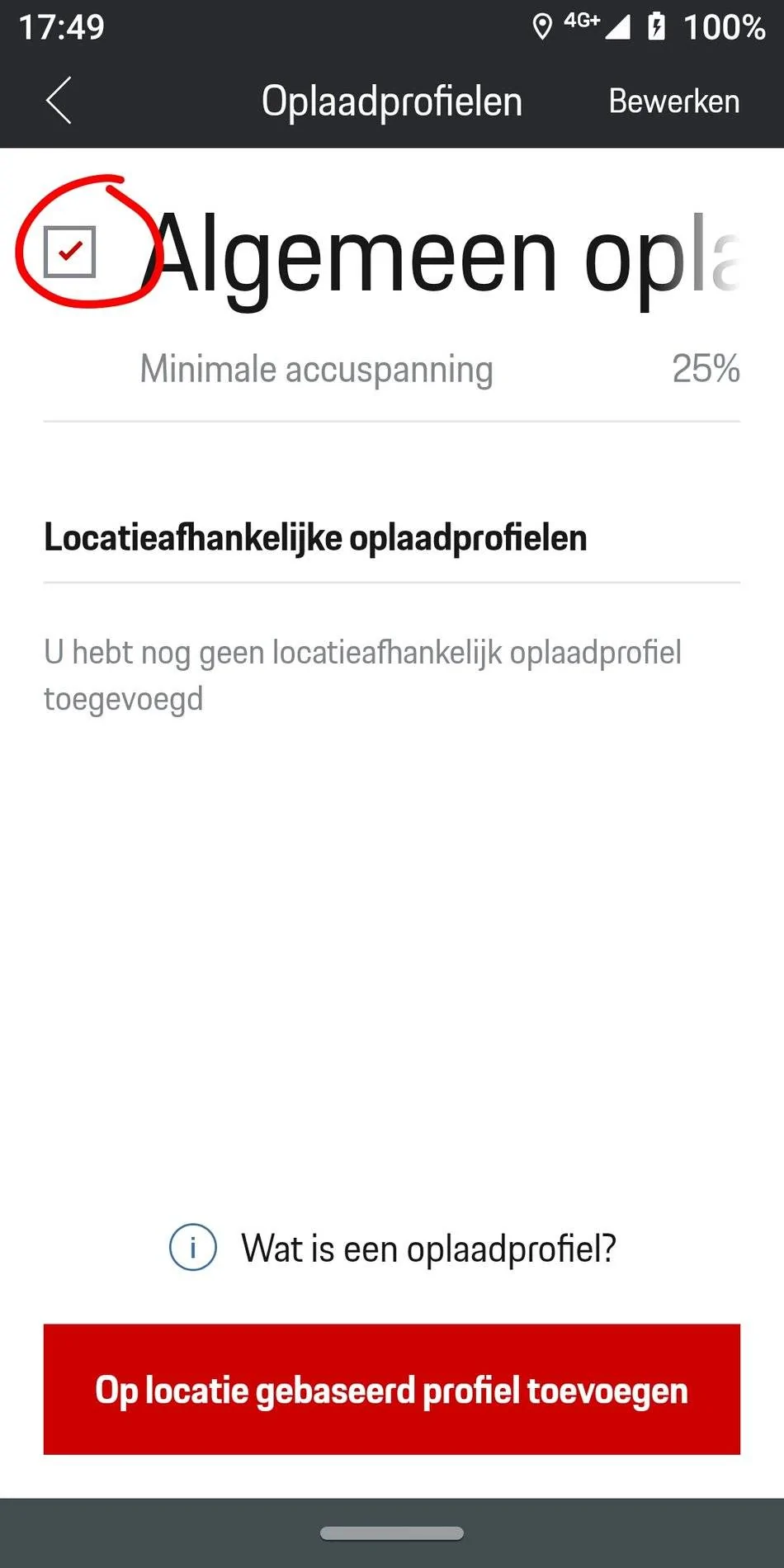

A lot
You can activate a general profile (check it) where you can set the prefered time to charge:
Porsche Taycan No scheduled charging 2020-06-22_17.52.14

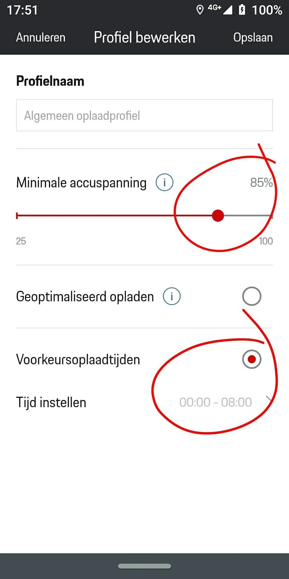

Dont forget to set the minimum charge level and check the desired time:
Porsche Taycan No scheduled charging 2020-06-22_17.53.35
