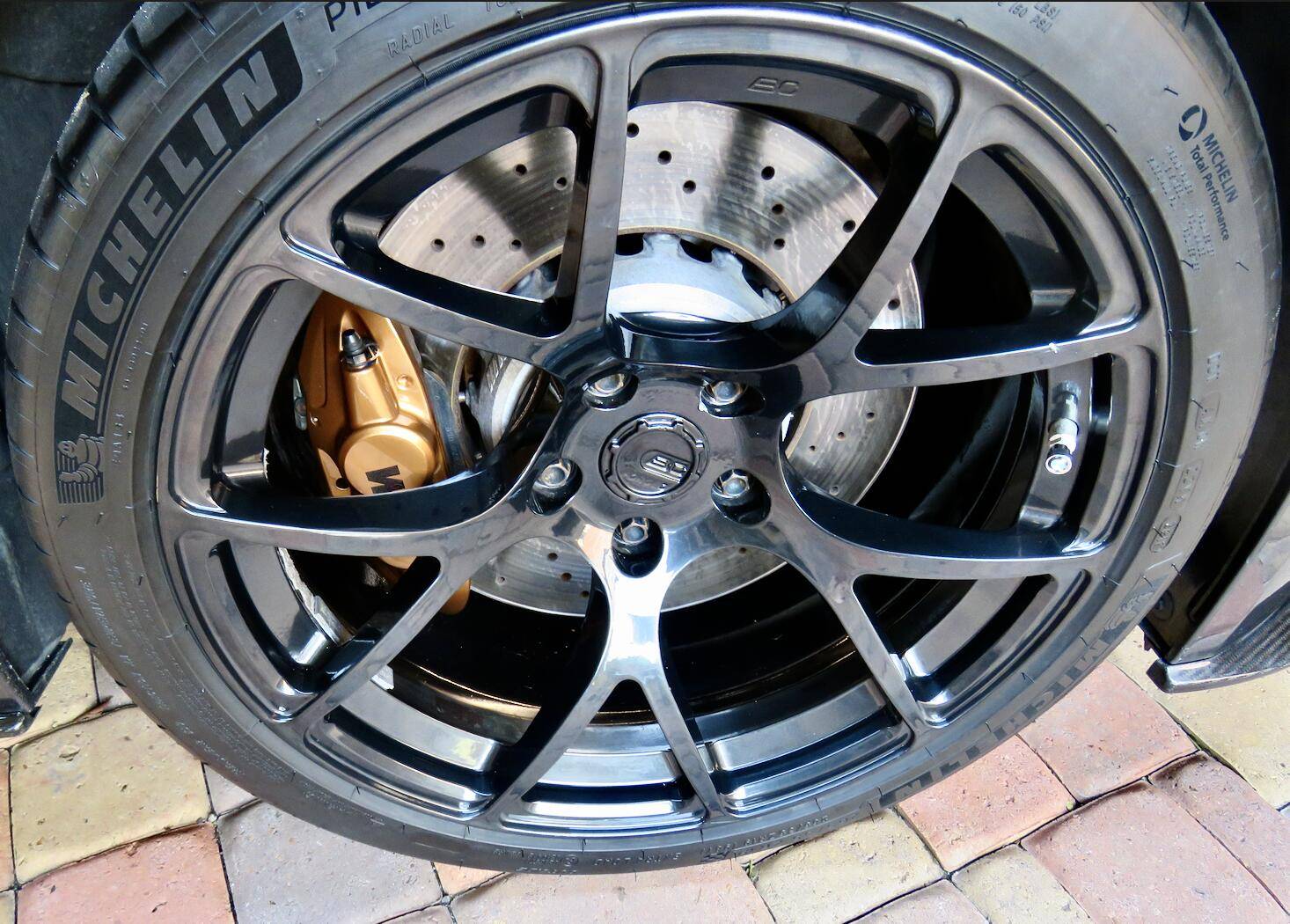

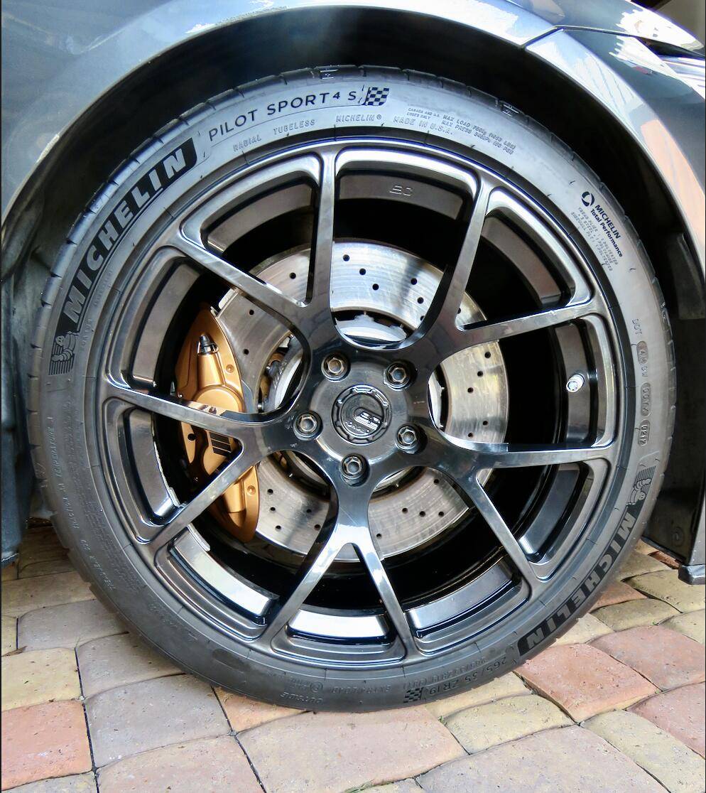

Last time I had this done it was for my M4 Convertible in 2015-2016 - apologies but for the life of me I cannot recall what the cost was but not cheap i.e. I want to say around $1000 but maybe less.
No issues if done correctly and will last the lifetime of the car i.e. powder coated and baked properly etc - the paint job is rel. expensive as of course it has to be done to withstand the very high temps calipers experience in use.
Any proper Pro shop (either in-house or w/ a 3rd party affiliated paint shop) will have done this many, many times - just find a good place - if you don't have one already I'm sure fellow Floridians here can suggest some to you (or touch base with you local Porsche club etc).
Of course you can purchase painted calipers but prob the most expensive route and if you are after a custom color then getting them painted is likely the only option but also cheaper!
Couple of pics of the M4 calipers - unique color to echo the interior leather :)!

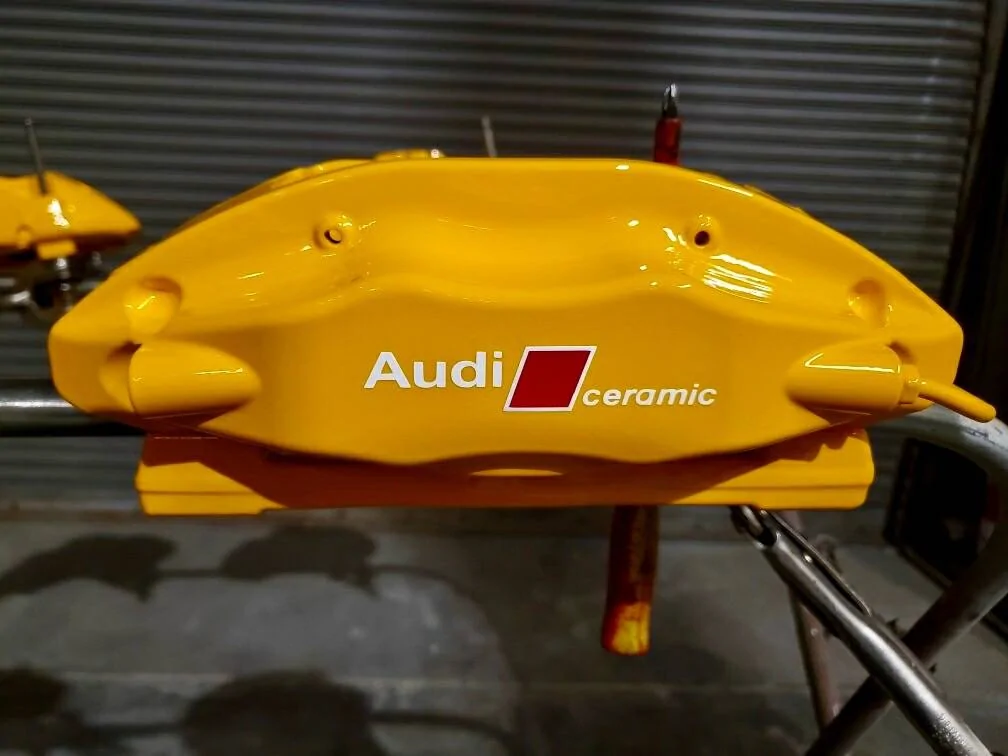

Ive done both methods.
Paint - budget $1K
- not nearly as difficult and as is always the case with paint, prep is what will determine the finish.
- I have both DIY and paid (hence the budget above). If you DIY, patience and a couple of days will get you the results you want.
- the gold above can be done, to get it perfect, you will want to lean towards a two stage (silver base and then color top coat).
- DYI is messy and if you arent that hands on type person, dont do it. Pay someone. For me, its part of the fun of owning these things.
Here is an example of two stage finished in paint:
Porsche Taycan Painting Brake Calipers...Need Advice View recent photos

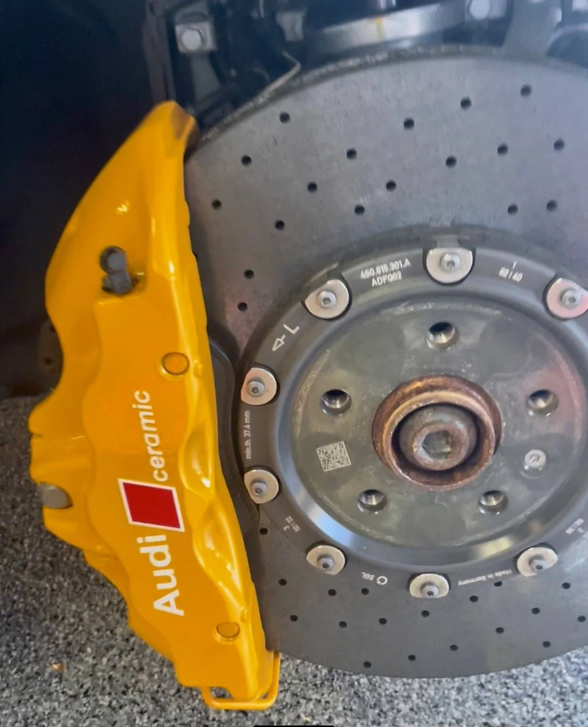

Powder - budget $2K
- they all need to be removed from the car
- you will need a rebuild kit because they need to be broken down in terms of removal of the pistons and cups etc
- powder coating is THICK. Most manufacturers use paint, not powder. You will be best with a single stage, and a spray clear coat rather than a powder clear.
- get this right and it will be bulletproof, but plan on doubling your costs (as noted above)
Here is an example of that finish:
Porsche Taycan Painting Brake Calipers...Need Advice IMG_1930
Porsche Taycan Painting Brake Calipers...Need Advice imagejpeg_1
