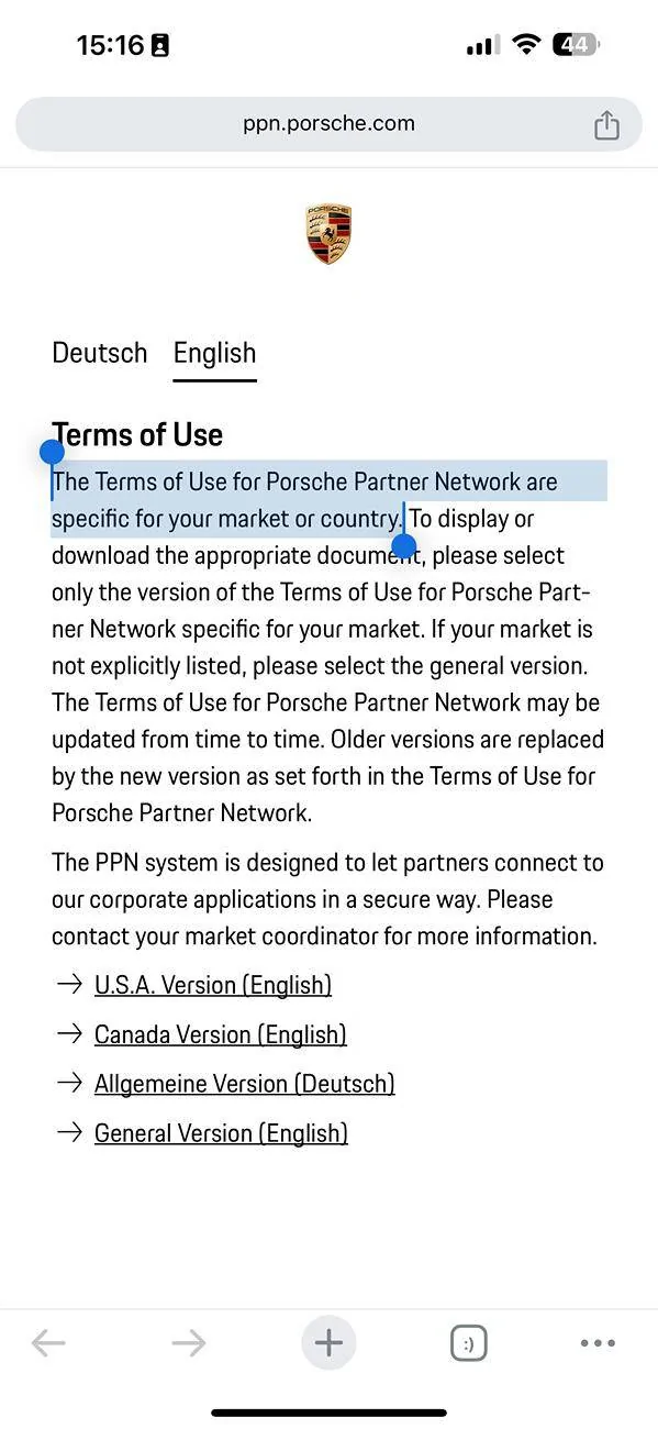

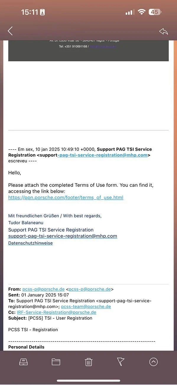

I thought you got PPN access.
Yes, I have requested access twice. The first time I sent the terms of use with my details, it seems that the form with the terms of use was not correct because the terms of use I sent in the first place were the U.S.A version, and they sent me a link. to choose the terms of use related to my country, fill it out again and resend it and I already resent it yesterday, now I'm waiting for them to send me access. The Terms of Use for Porsche Partner Network are specific to your market or country.

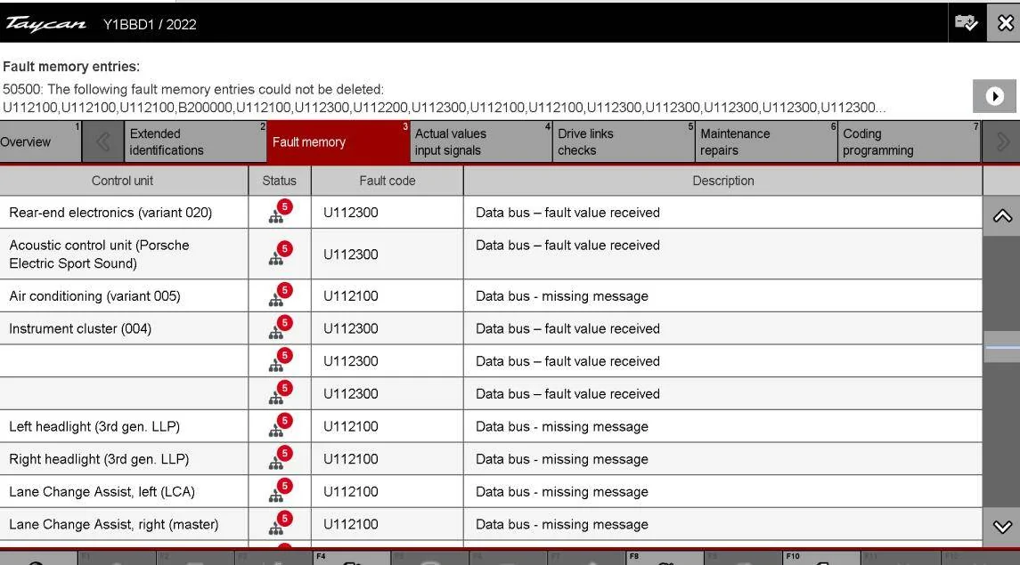

I was seeing the errors here, and thinking there is some chance that these communication problems between the modules are related to the replacement of the 12 V battery, this is because I have information that the 12 V battery was replaced by the Porche dealership 1,500 km ago, the battery you may not have or may cause a strange power cycle, low battery voltage ..etc… changing the battery may cause errors … (U1122300 and U112100 are generic non-signal and message missing errors…) literally and almost all modules will present these two errors…

It seems incredible but all the modules affected by some error are located in the panel area (Ac control module, chassis drive assistant, bcm1, ESP 9 Bosh, Dash Board LG, windshield wipers) and as incredible as it may seem I have both blind radars spot the left and right with the databus message missing error, two rear view mirror sensors…,) …I assume that something must be wrong nearby, under or on the side of the car's dashboard…The big question I ask here is where and how to start,,,?

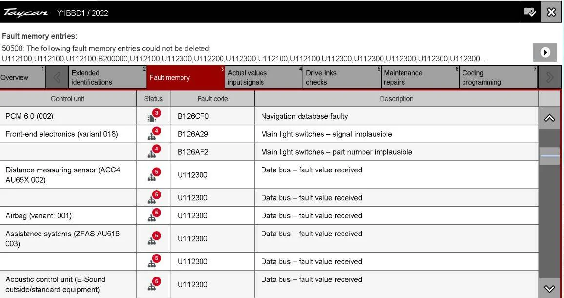

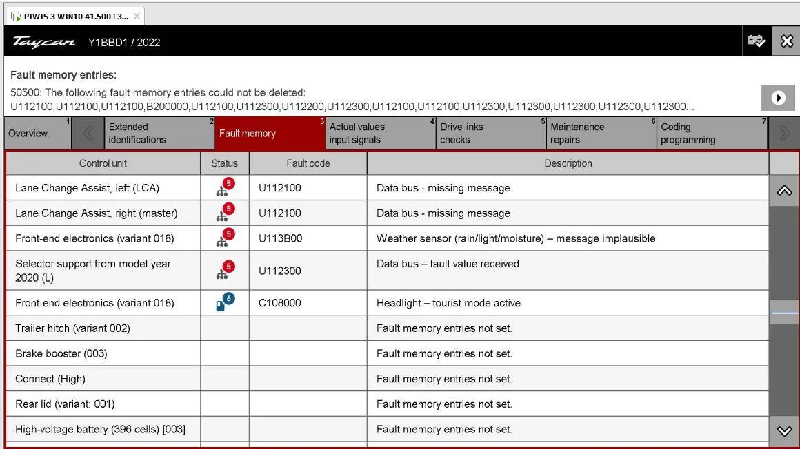

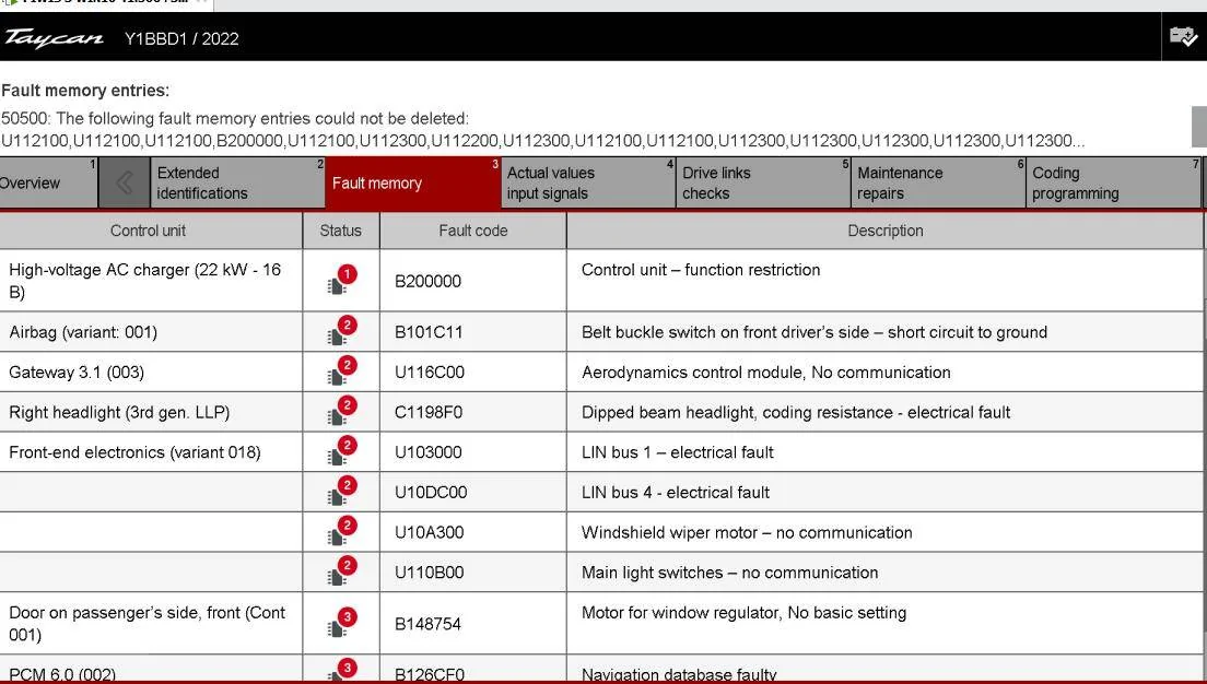

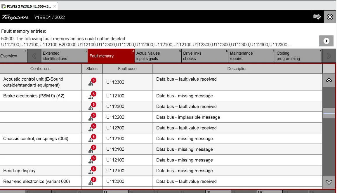

After this diagnosis that I will leave here, it is almost certain that the problem in the car is the CAN BUS (Can lines) Can high or Can Low one of them for sure or a short between Can low and Can high.....!
