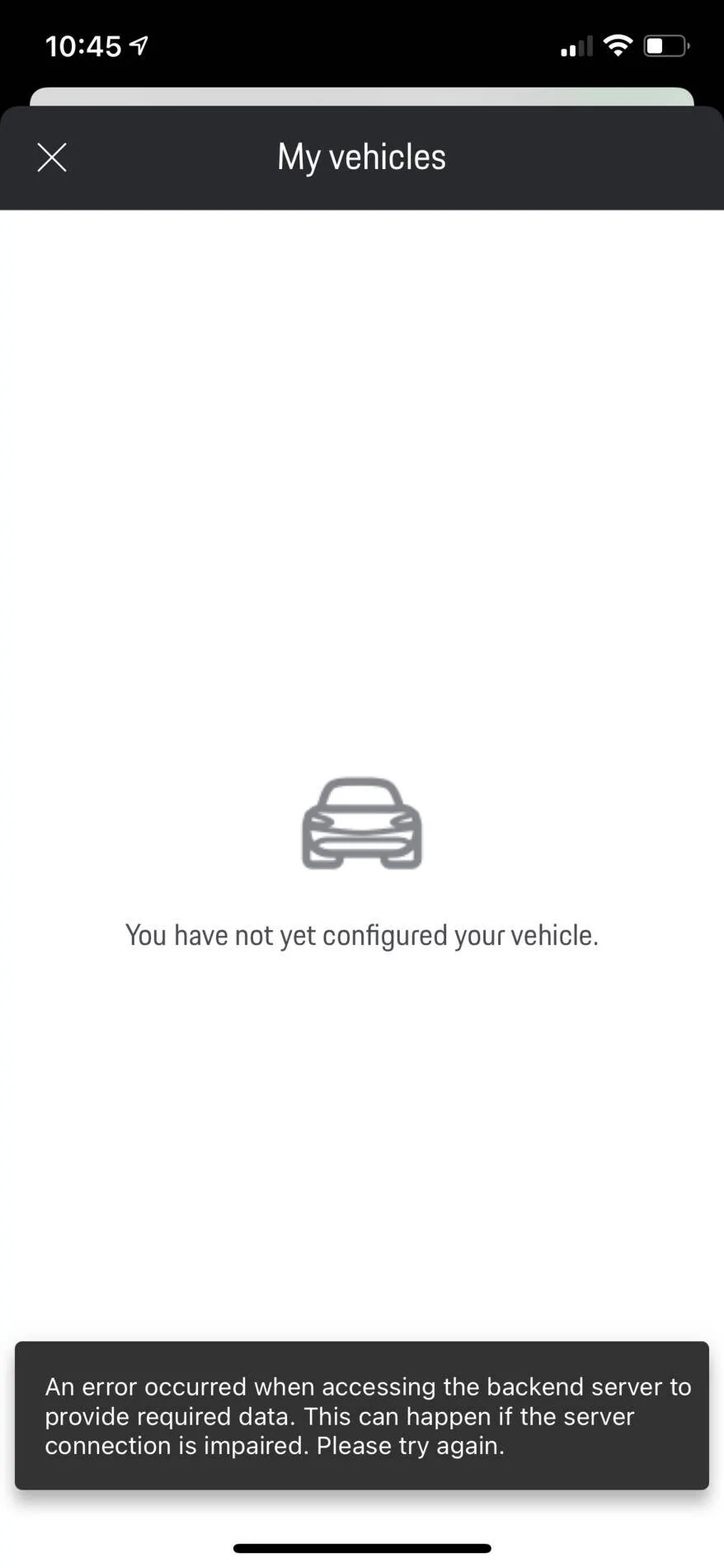

I’m a little late to this thread but noticed that I just took a similar road trip through Kentucky and had a tough time with the EA charging stations. First off my Taycan is a 2021 delivered in May and I can’t find the plug and charge option anywhere on the vehicle or the NA app. Do you have any idea whether you had to have the dealer set that up on a software update or did it just appear and work for you? Would love to figure this out to avoid another trip like I just took…..Charging NA app
