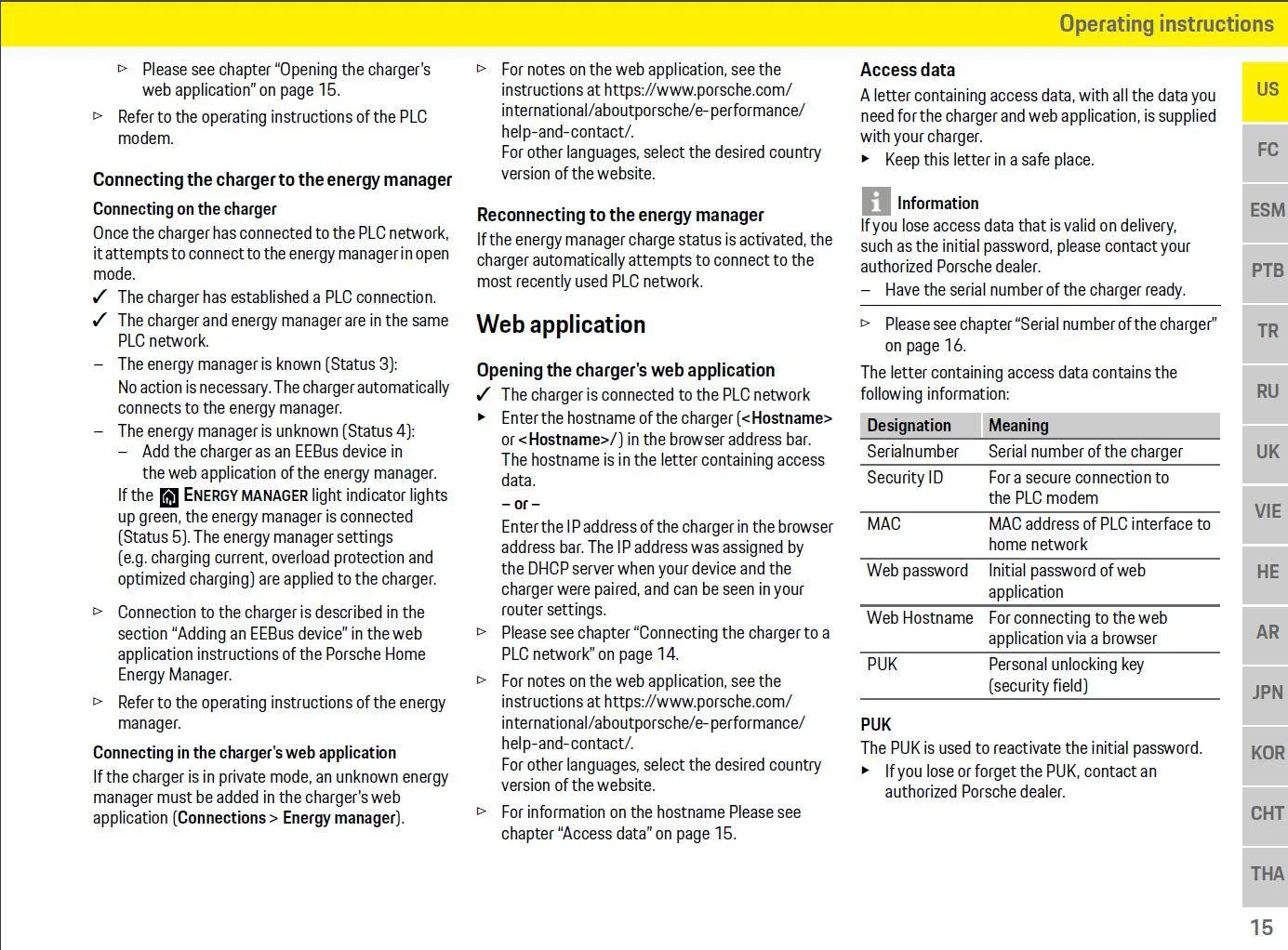

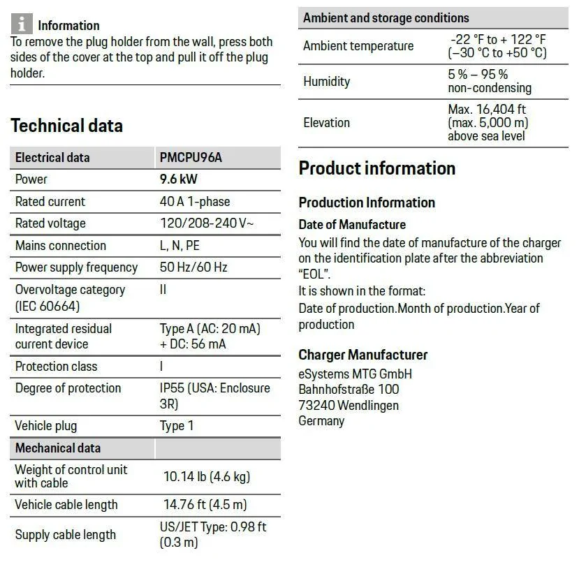

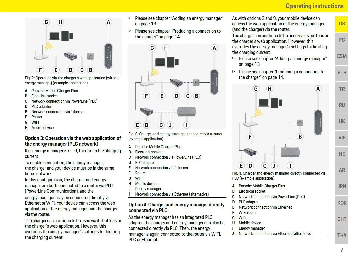

Attached HEM config doc and some PMC+ docs (file is 25Mb which I can't upload) which might help.

Thanks Winge. Seeing the HEM manual very useful. Confirms that for my new Taycan Porsche HEM will do everything I want, it’s just my feeling that a SMAPPEE system might be better future-proofing (especially when I buy second EV) and the total investment for purchase and installation is only a couple of hundred dollars more. Would love reassurance that I would not be losing anything with Taycan and SMAPPEE.
