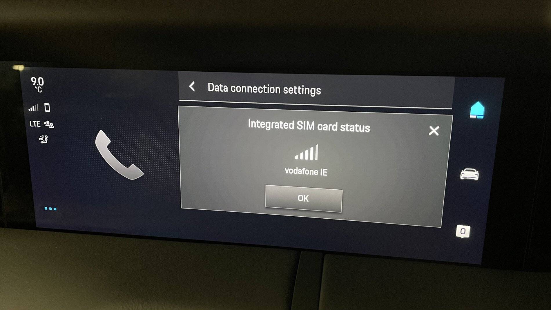

I suspect the SIM connects to Vodafone (as per PVTS+).
You can tell for sure by going into Devices -> Hit the three dots -> Data connection settings.
That will show you the current network and signal strength. This can be handy when abroad too to see what network its using.
Porsche Taycan Porsche Connect App rant IMG_0085
