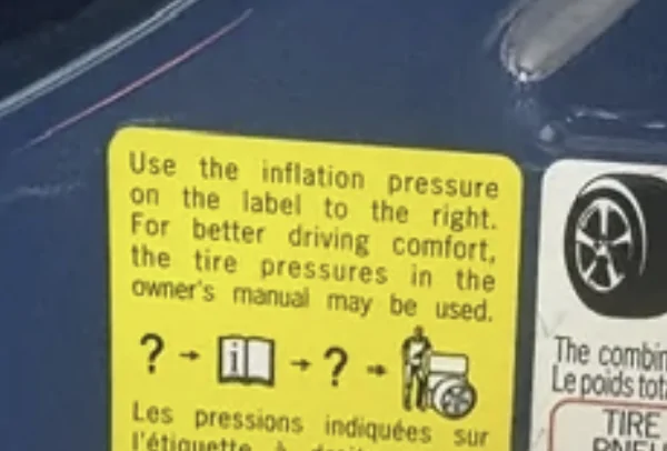

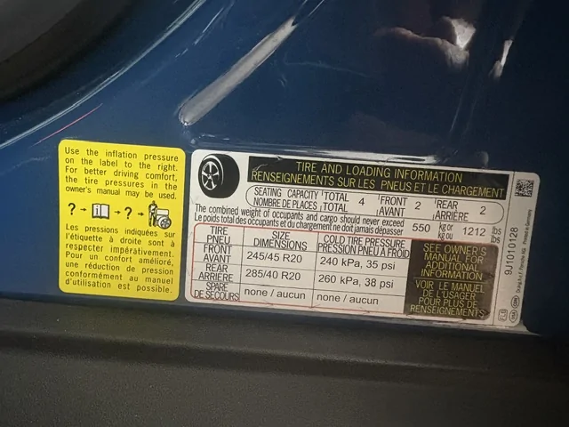

Unless I missed a second tag, the tag on door frame of my US 2022 4S has VIN and vehicle weights only, nothing about tire pressures. I looked at online manual for 2022 and do not see anything about door tag overriding tire pressures in the manual.
It's ridiculous something so important is so difficult to pin down, am I right? This is what I see on my frame. It contradicts the online manual, ChatGPT, and what the guy at Discount Tire told me. On another forum I believe I read the online manual OVERIDES the car's spec plate because they are always looking to update with the best information. What to believe??
This is a 2022 base model. No frills.
Porsche Taycan Proper Pressure for Michelin PS4? IMG_7224
772
4,648
3,767
My car does have a similar tag. Tire pressures on the tag slightly different than the manual. I use the manual.
