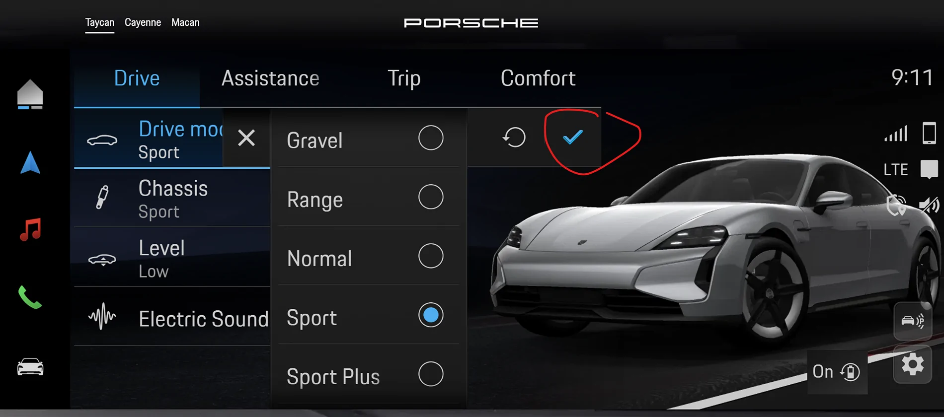

This is how it works:
J1.2 Eliminated Individual Mode.
Without Sports Chrono you only have Sport Mode.
Without Sports Chrono if you have Air Suspension you still get Sports Plus chassis setup.
You can customize Sport Mode and Save.
You can adjust Normal mode but cannot Save.
