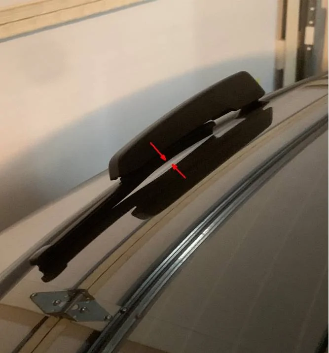

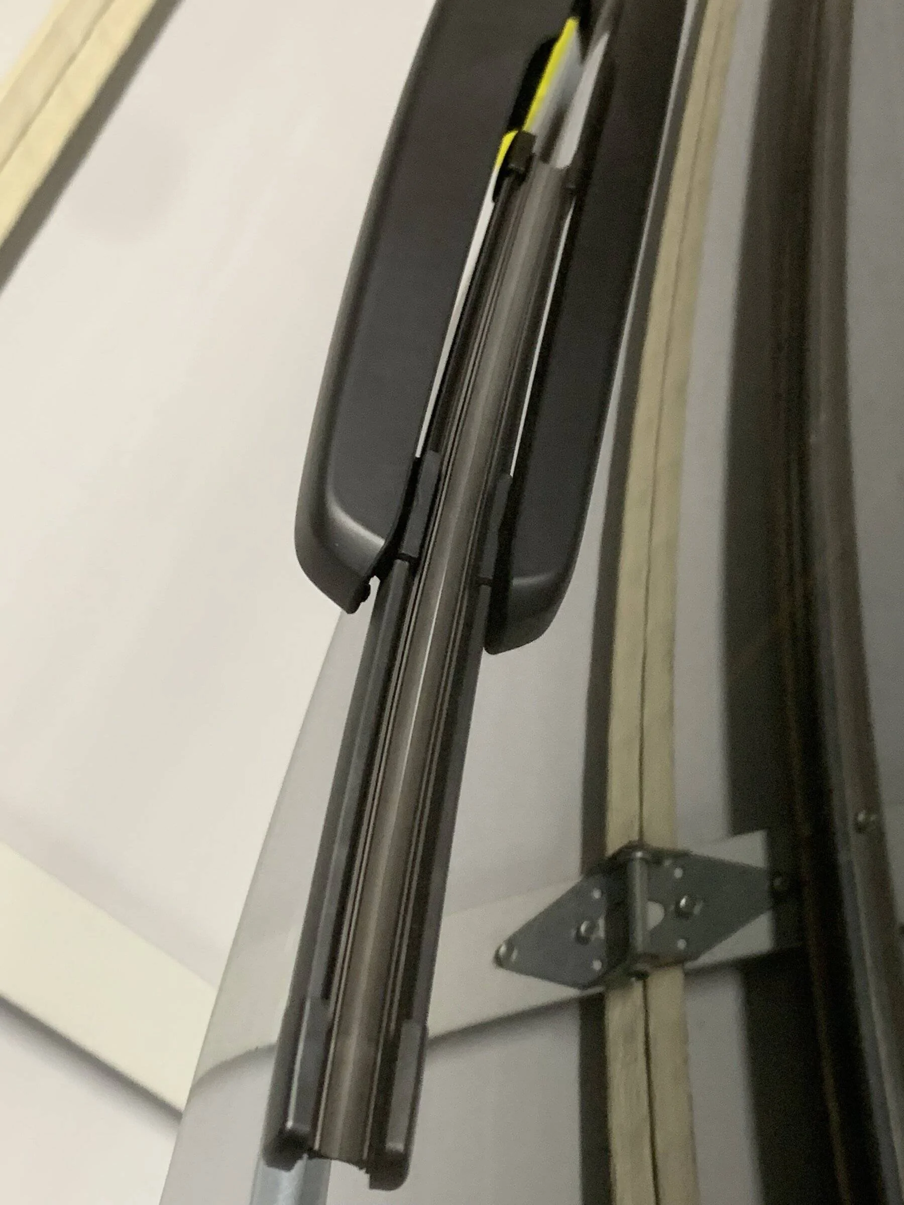

I just took delvery of a CT4 and really like the extra visibility over the Coupe. I had the 4S coupe for a year and the visibility was dreadful.
However, the rear wiper on my CT4 doesn't have enough pressure to provide a clear wipe of the window. It's 1-2 mms off the screen in the middle of the wiper in the default position.
Are others getting a clear screen with the rear wiper? My dealer is 80 miles away so not ideal having to take it back to get it adjusted.

Compromised blade material? Debris?

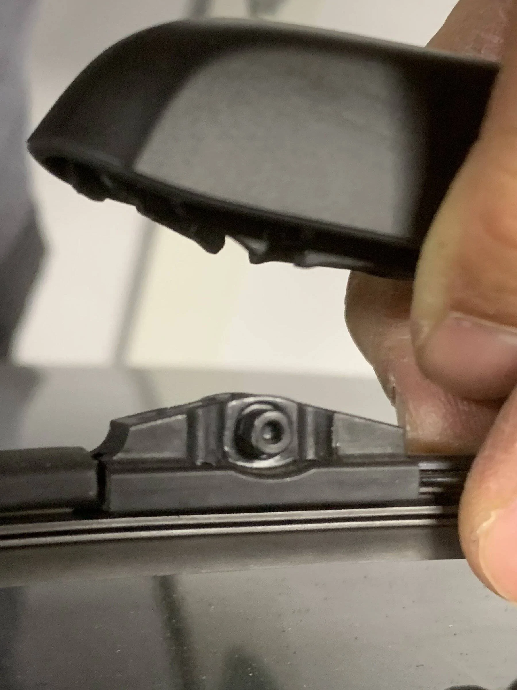

Came across this thread after having similar issues. Rear wiper was not installed properly and would not articulate on it's pivot. Just had to pop it off by pulling down and push it back in.
Porsche Taycan Rear Wiper IMG_7270not

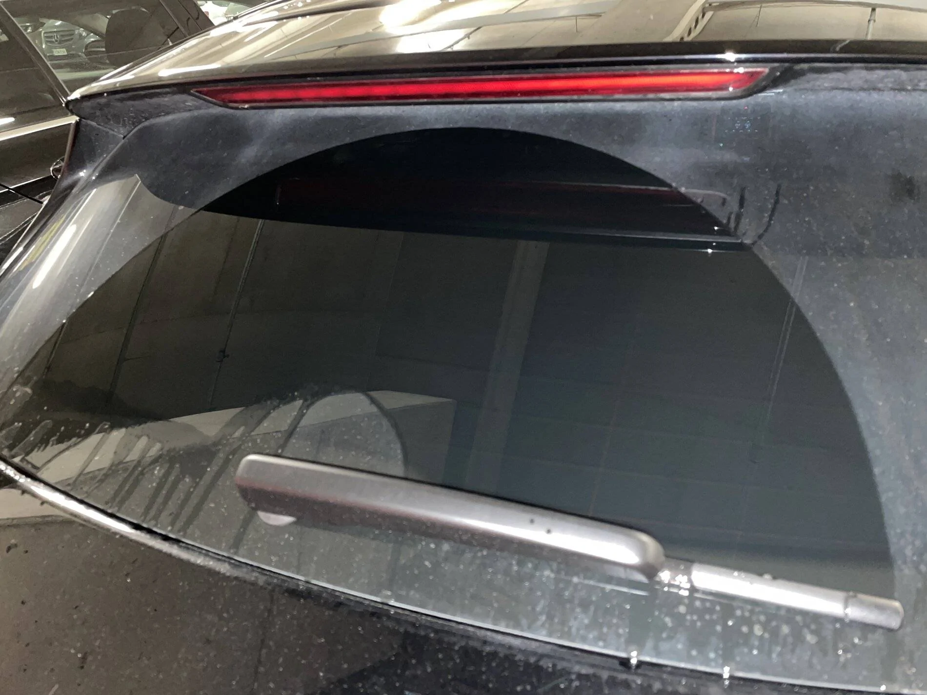

All fixed:
Porsche Taycan Rear Wiper IMG_7275
OP's issue could be fixed by removing the wiper and checking the tension spring in the arm and/or flexing the wiper blade back to take some of the pretension curve out of it.

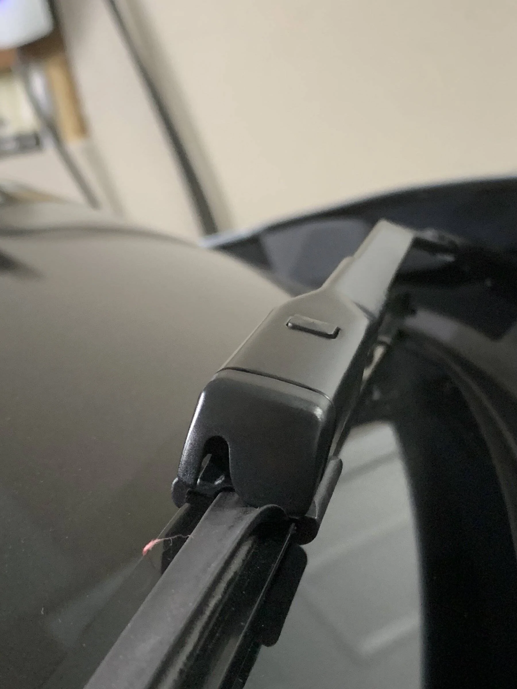

Seems like the wiper guy on the production line was having a bad day with my car. One of the front wipers was assembled backwards too. See the rubber the pinched air deflector...
Porsche Taycan Rear Wiper IMG_7273

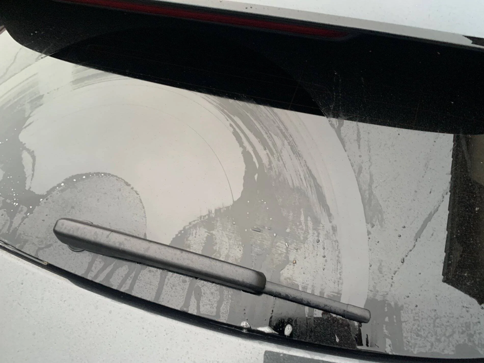

After around 10 months and 8,000 miles my rear wiper blade has become very noisy an very irritating suddenly. Struggling to find anywhere the correct model/fitment for a replacement and dealer is 100 mile round trip. Does anyone know the correct fitment please? All I've got so far is it's 10" from measuring it!

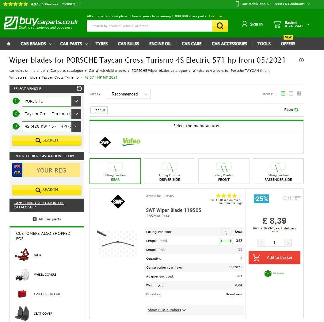

Should be simple to source online - check the size (obviously) and the brand is probably BOSCH (but any of the correct fitment will do - Valeo, Michelin etc).
This link should pull back a rear wiper - https://www.buycarparts.co.uk/porsc...blades?sort_supplier[0]=30&criteria[100][1]=H

This link should pull back a rear wiper - https://www.buycarparts.co.uk/porsche/taycan-cross-turismo/145139/10233/wiper-blades?sort_supplier[0]=30&criteria[100][1]=H
Can't your dealer post one to you (at a price of course)?
Thanks for the link - tried all the usual suspects such as Euro & GSF and some of the wiper blade websites but none listed for CT4S rear! Will order one of these and in the meantime try and clean the blade!
