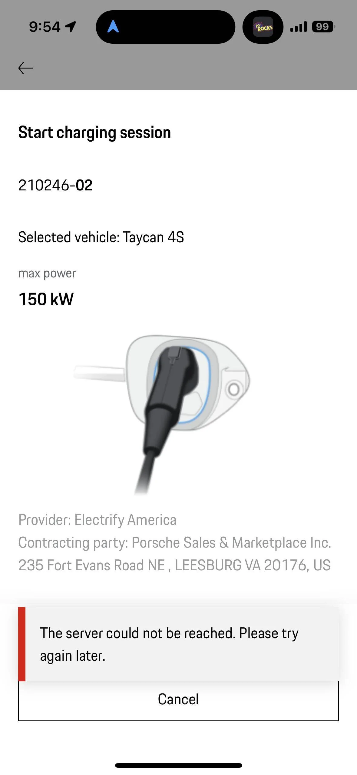

Lol. Since having constant failures with P&C I've tried the MyPorsche app which gives me an error: "The server could not be reached. Please try again later."
THIS CHARGING THING SUCKS AND SHOULD GET FIXED!

I get that error too from time to time when I use the MyPorsche app. I kill the app on my phone and restart it. That usually fixes the error for me. It's a shit software experience but at least there are some workarounds.
