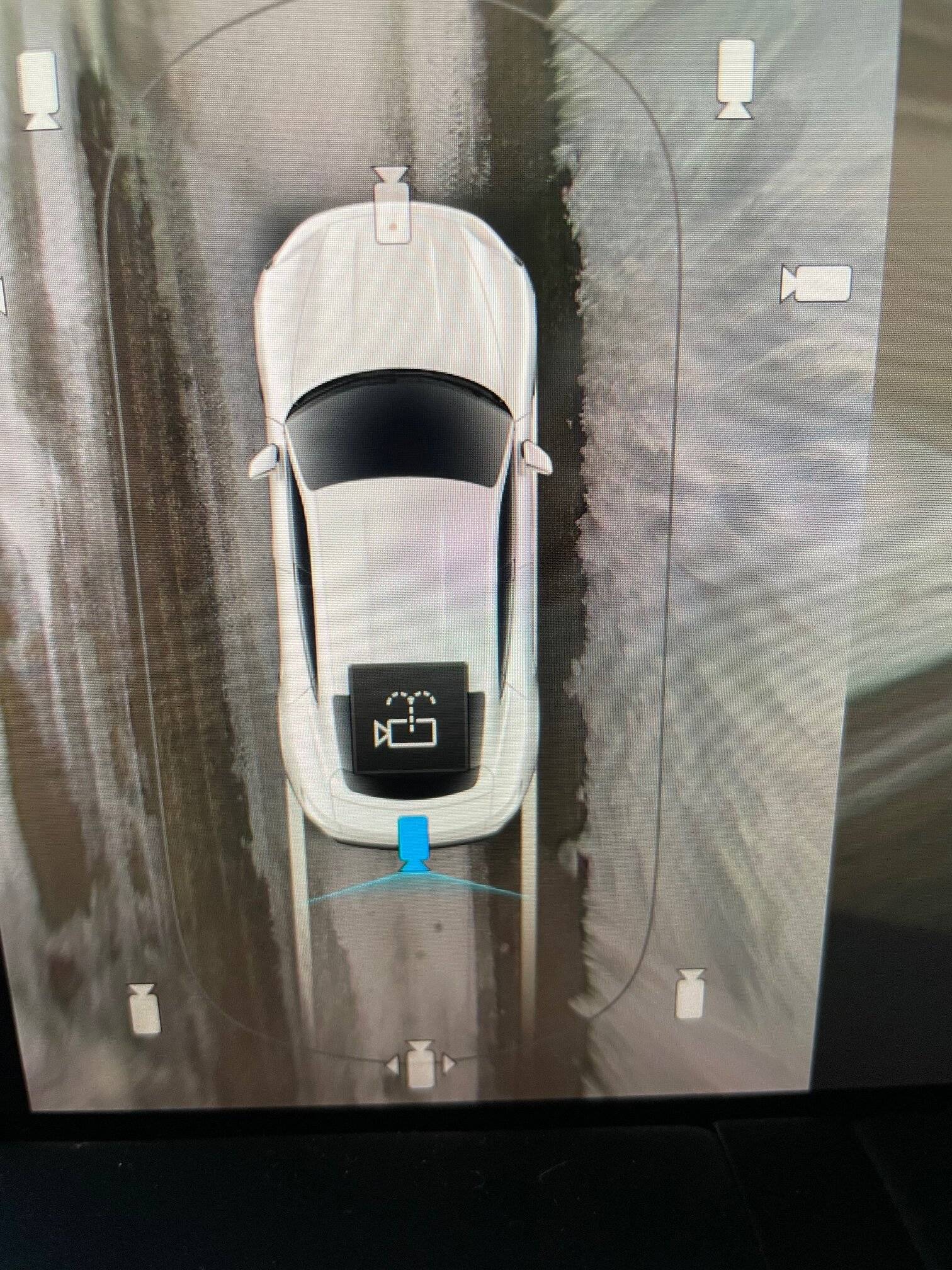

Can someone tell me where the button for the rear camera wash is?
It's on the screen above the back-up camera icon when you are in Parking mode. Will snap a picture later

Either put the car in R or press the Park Assist button. The cameras front, rear / side are displayed. The rear also has a washer icon - tap that and the magic will happen.

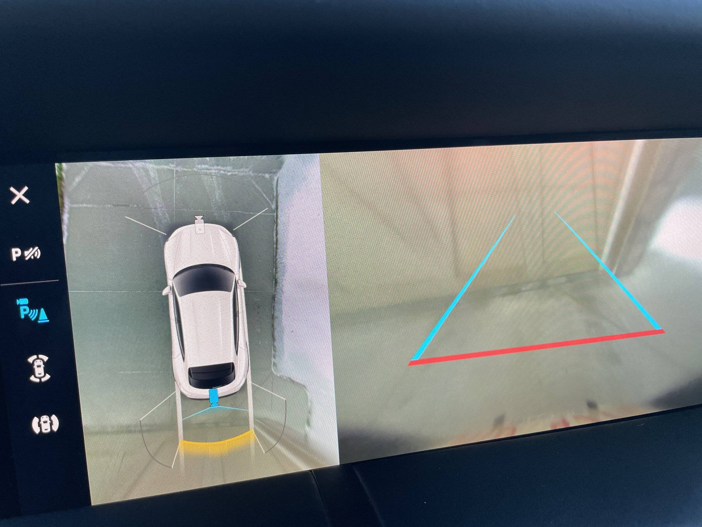

svp6
Oct 6, 2019
512
598
MN
4S
It is visible only when you put your car in reverse. In park / neutral I get the same picture as yours.

I was in reverse. I know it was there before because I remember looking for it when I got the car. My Macan didn’t have one so I always had to wipe the camera off so I was happy the taycan had one.

Thanks. Mine seams to have disappeared.
That picture suggests you have a cross turismo? If so then the rear camera wash is activated by the rear screen wash (push the stalk towards the dashboard).

Yes it's a Cross Turismo and I can get the camera to wash if I wash the rear glass. I just don't always like to wash the back glass as it makes a mess of the back of the car and my Macan rear wiper arm clogged up with dirt and didn't wipe the glass. so I hated to use it.
I guess the CT doesn't have the wash icon in the screen.
