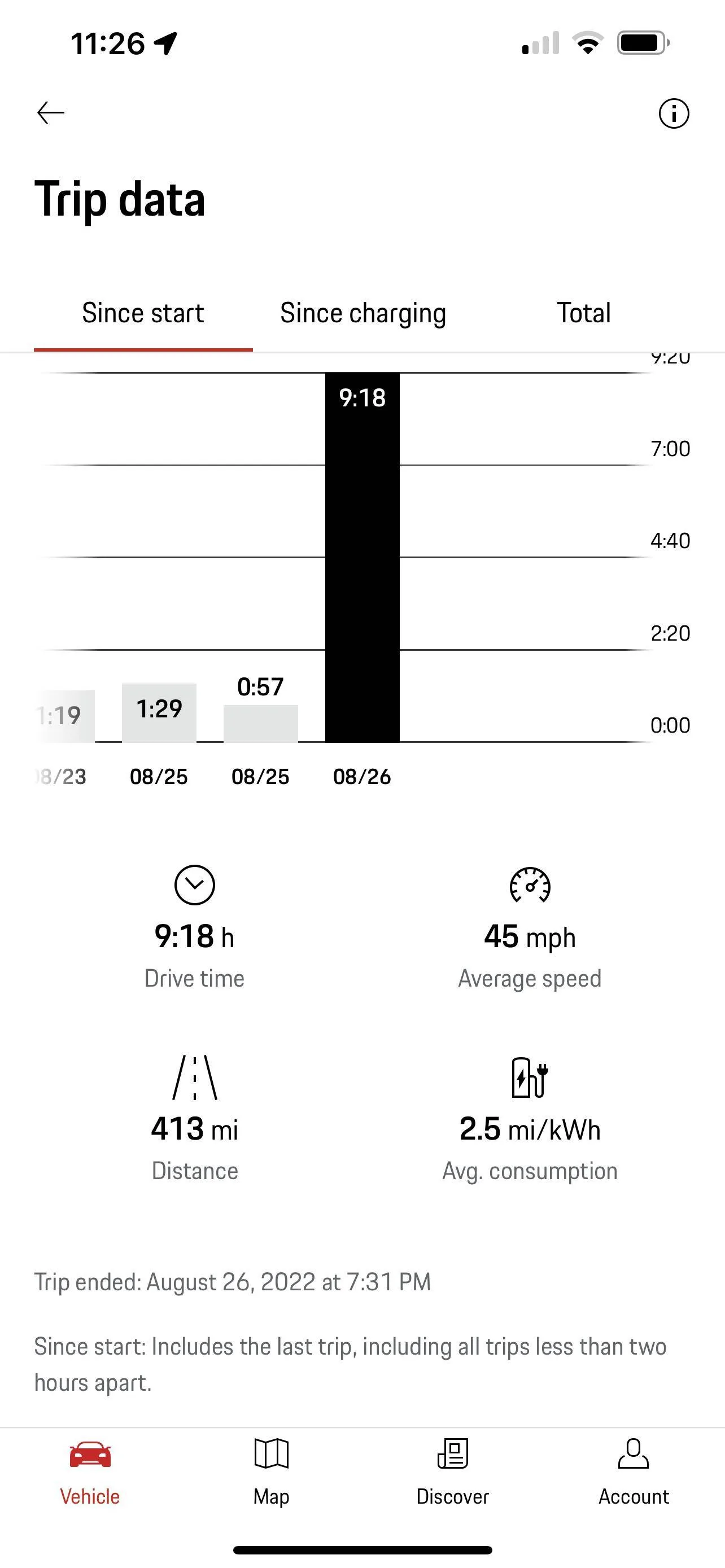

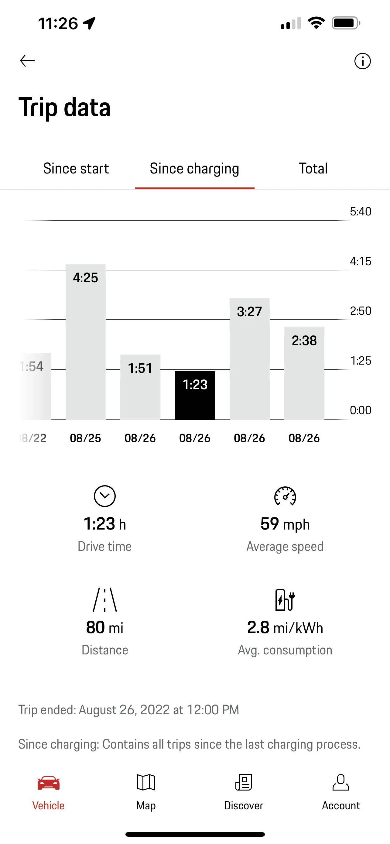

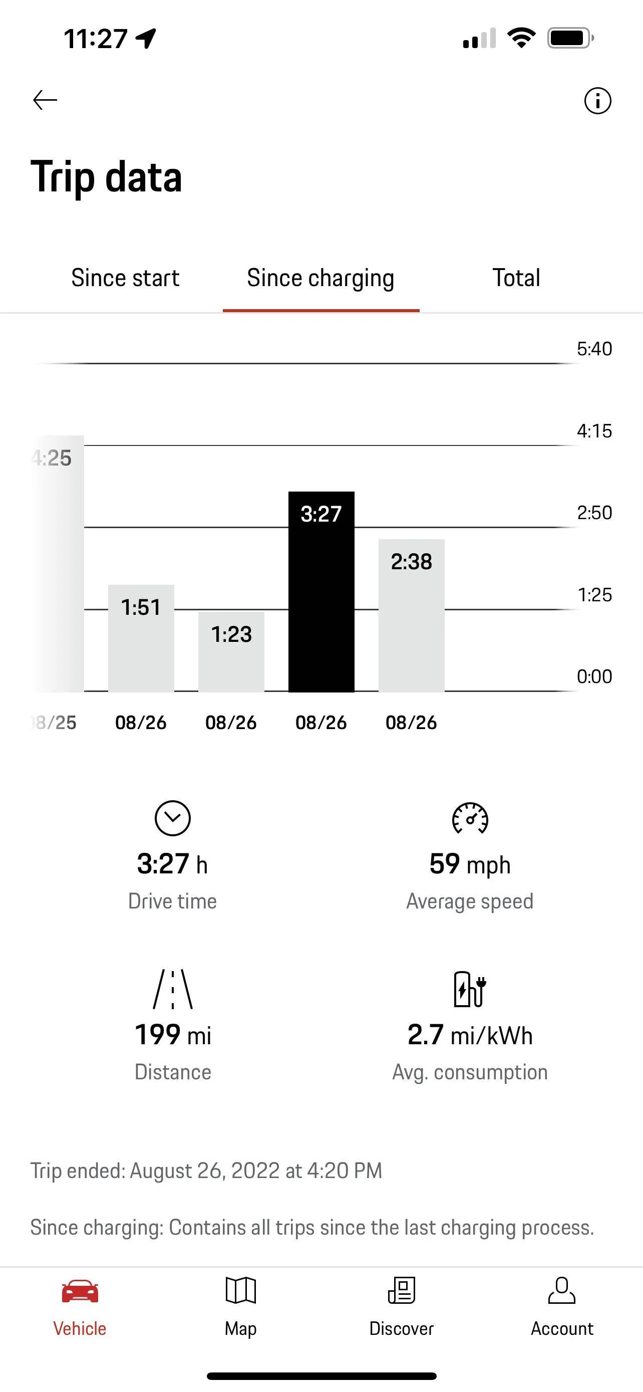

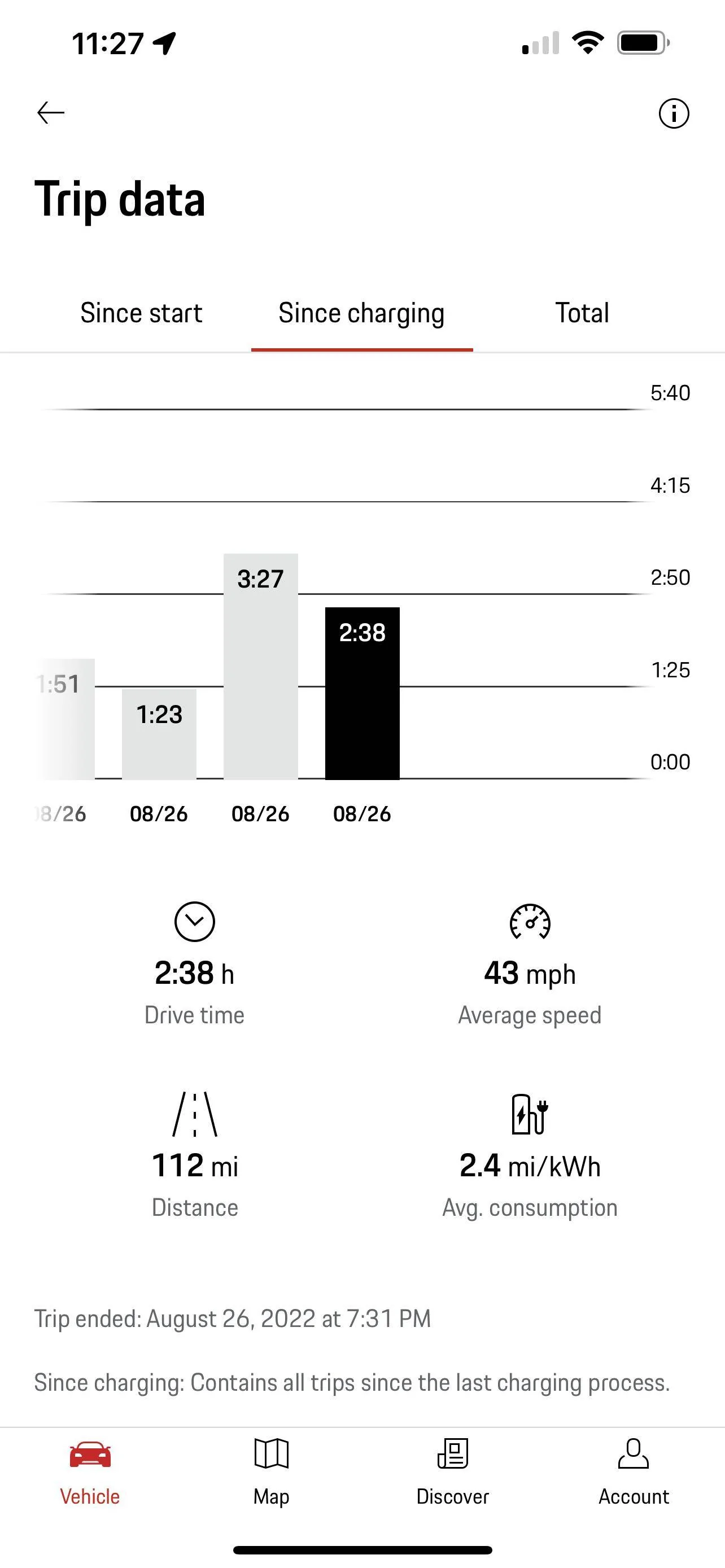

Trip finished. I learned a lot on this longer trip:
1. I personally found range mode to be absolutely fine. No material downside to using it from my perspective other than it turns off passenger control screen.
2. On the east coast, EA charging stations were fine. Biggest problem was drivers whose cars didn’t need 350 kWh charging taking those spots instead of the 150 kWh spots. First few times I let it go and didn’t say anything. Last time I asked politely and found out that it was a rental and they didn’t know. They moved for me. A LOT of education needs to be done, and the labeling and signage at the chargers is awful. They should just make all of them 350 kWh so that it doesn’t matter where you charge.
3. I finally figured out how to use the free Porsche charging BUT it kept giving me slower charging rates, so I turned it off and paid the $10 to charge fast. Anybody know why that is?
4. The range predictions and consumption is much more predictable in Taycan than in Tesla. I feel a far higher degree of confidence, and would have no issues in trusting 10% remaining at arrival.
5. The user determined settings seemed to have a far lower impact on consumption than all of the factors that are out of your control. Moral of the story? Don’t sweat it. I wouldn’t “waste” energy on things you are not using (e.g., rear climate control, sport sound, etc.), but the rest is fine.
6. Speed, while relevant, seems to have a much lower impact on consumption than speed had in my Tesla Model X. In the Model X, range would plummet/consumption skyrocket when you exceed 70 mph. In Taycan, it did not seem to hit a cliff ( speeds of 90 to 105 didn’t seem to have a huge impact). Maybe Taycan has better high speed aero?
7. Here are my stats. They total day graph is misleading because day started with running errands around Syracuse. Driving went generally from more conservative at beginning of day with less traffic to more aggressive in terms of speed and settings combined with more intervals of super heavy traffic.
