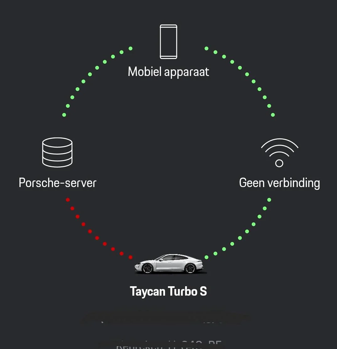

A lot
Porsche Taycan What is the PCM HotSpot for anyway? 2020-08-28_19.27.06
It's quite handy when the Porsche server can't connect to the car.
My phone connects to it when I want to send charge profiles/nav routes to the car when I'm at home.
It works most of the time.
PS Sometimes it says "no connection" but in reality it has.
Only if it connects to the Porsche server directly the symbol on the left upper corner turns green.

Clear story, thx.
1. Charge profiles.
2. Connect app (see previous pic)
3. Cuz the app says so (red line between Porsche server and car).
4. Yes cuz my phone also acts like a hotspot for my MiBox which is streaming IPTV.
But maybe you are on to something cuz I haven't managed to send profiles to the car at work (I can't connect to the car, either through the Porsche server nor the hotspot of the car).
I can follow my charging status though.
Well, not every minute but every 2 hours I guess.
Maybe you can do something with this info.

Re #4: I expect your phone CAN provide a HotSpot, but not AT THE SAME TIME its connected to the car's Hotspot, right? You running the MiBox while you are in the car?
I have never found that connectivity graphic (Porsche Connect) to be particularly insightful. It only serves to confuse me and I'm not sure how accurate it is. It sort of begs the question about how it could possibly know what the connectivity state of the car is when it can't connect to the car (or the servers).
I would be willing to bet that you always need to have the Porsche Servers somewhere in the "middle". Your car needs to be connected to the internet via its LTE connection...and your phone needs to connect to the internet via its cellular connection. Your car talks to the servers via its connection and your phone talks to the servers via its connection. The servers then become responsible to move data back and forth between the phone and the car.
Its also possible that a phone could maintain LTE/GSM connectivity at the same time its connected to a WiFi hotspot which has no Internet Connectivity. I could see some real problems with this though and I don't think I've ever seen it implemented in that way.

I do understand what you're saying about the traffic.
But it's kinda hard to prove cuz one way or another, there's always a connection to the car when I'm home.
So, let's say it works instead of how it works.
At least for me it works, it's kinda hard to prove though, other than writing down my experience so far.
Like you say and like I said earlier, the app sometimes says it has no connection but it clearly has...
Not a reliable picture to prove your or my point. ¯\_(ツ)_/¯
