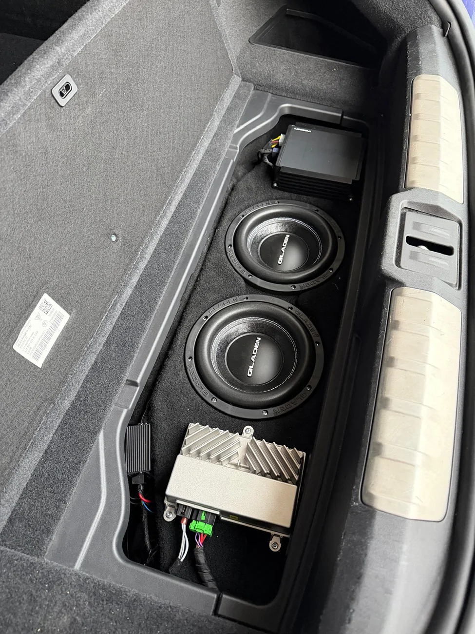

I decided that the bass provided by the Bose system wasn't sufficient. I contacted a local shop and booked an appointment for mid-September. On the morning of the appointment, the shop informed me that they didn't have the components I requested (JL Audio 6" box x 2, JL Audio 500W amp).
I went to the shop, and after exploring other options, the technician started to disassemble the car. However, after 2 hours, they mentioned they couldn't find a suitable location for a 12V power source and were hesitant to connect it to the 12V battery. After a few more hours, I left the shop without any upgrades.
I then called around and found another shop willing to perform the installation.
The new setup included 2x Gladen SQX08 subwoofers in a custom MDF box, a Gladen RC600.1 amplifier, and a Mosconi Atomo 4 to 6 DSP (not necessary, but I wanted to adjust the factory sound curve for the sub). Power was sourced from the power distribution unit at the back of the car.
This upgrade transformed the car's bass quality, and I wish the previous owner had opted for the Burmester system. I'm extremely satisfied and recommend this modification to anyone feeling that the Bose system lacks bass.

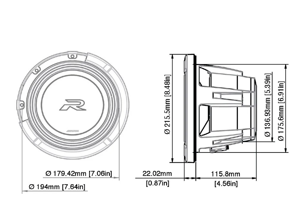

Hi guys,
Does anybody know how deep the Bose subwoofer enclosure is?
I have an 8" Alpine Type R subwoofer sitting in the garage unused and I might try this in the enclosure if it will fit. It has a 115mm mounting depth as per the diagram below.
I also have an Audiocontrol ACM 1.300 micro mono amplifier (which will do a genuine 300w RMS into 2ohm) which I could use to feed the sub a bit more power from the factory signal whilst keeping everything nice and compact/discreet.
Cheers
