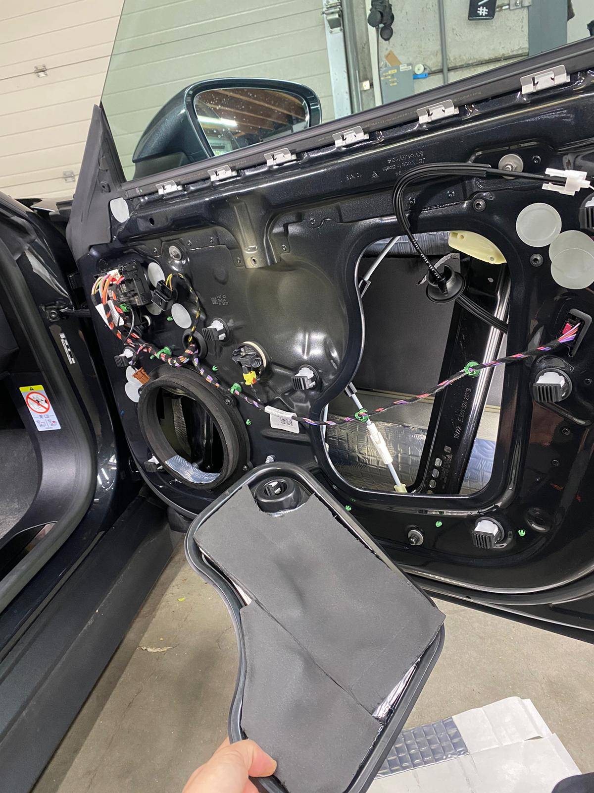

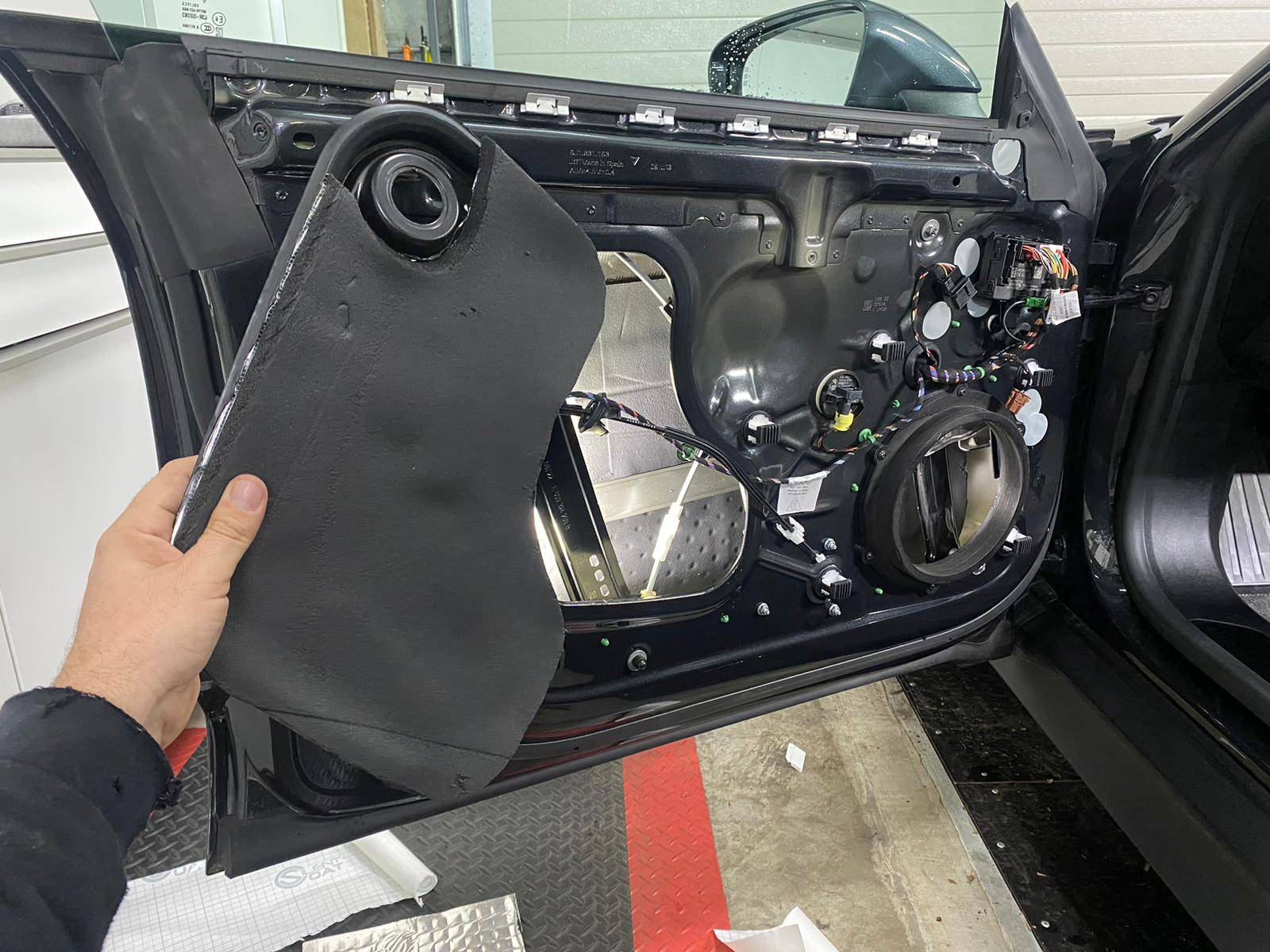

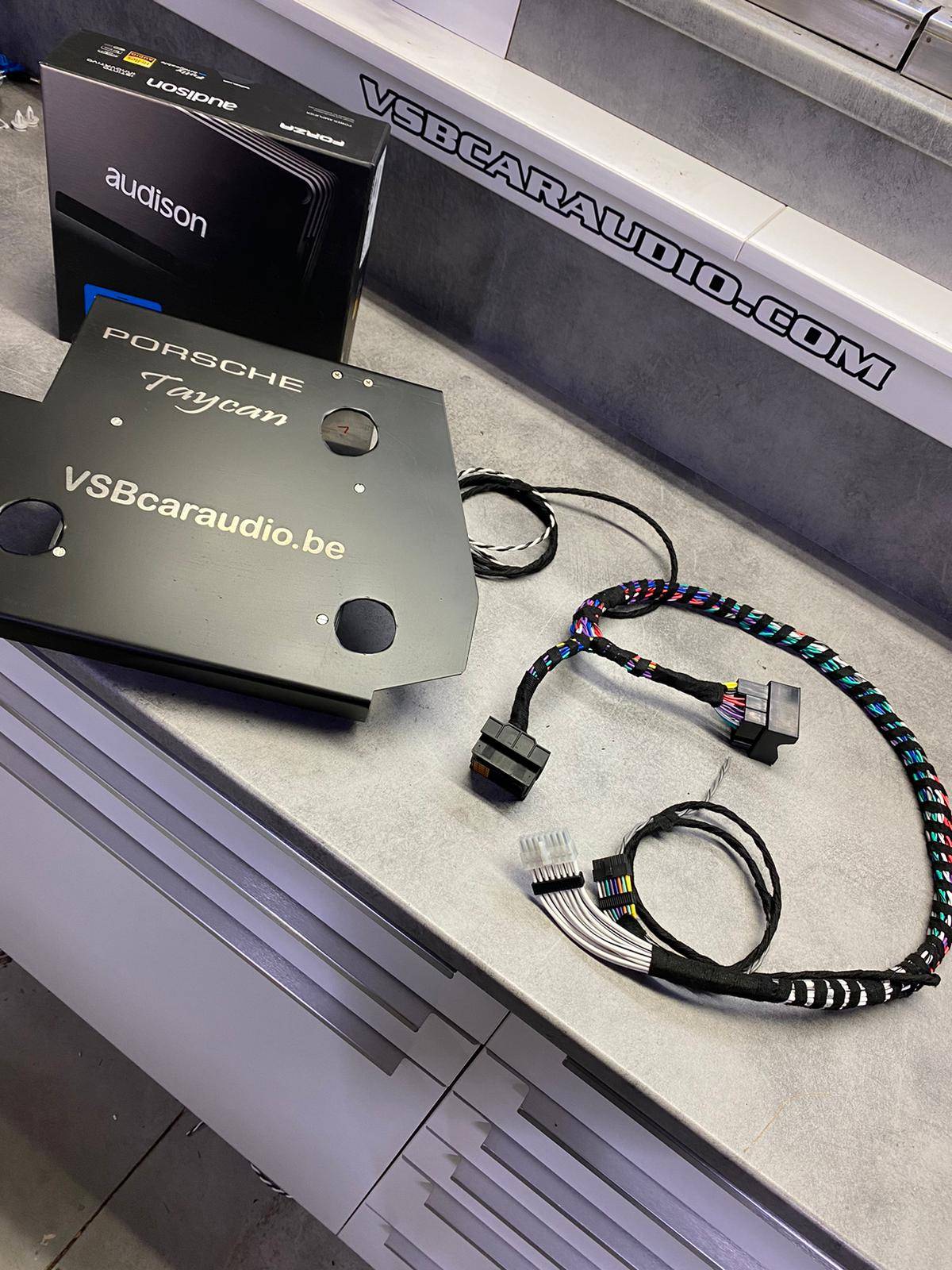

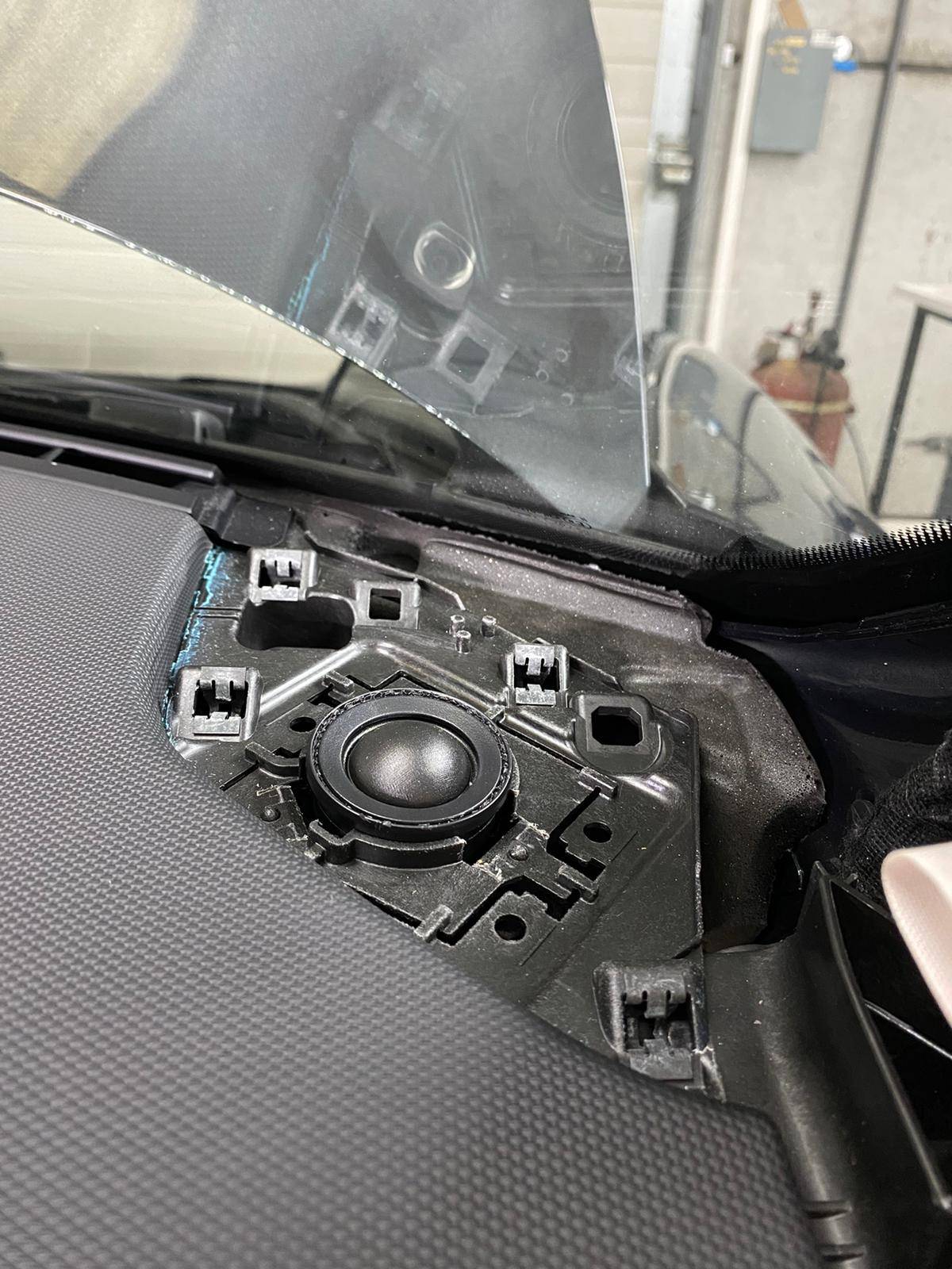

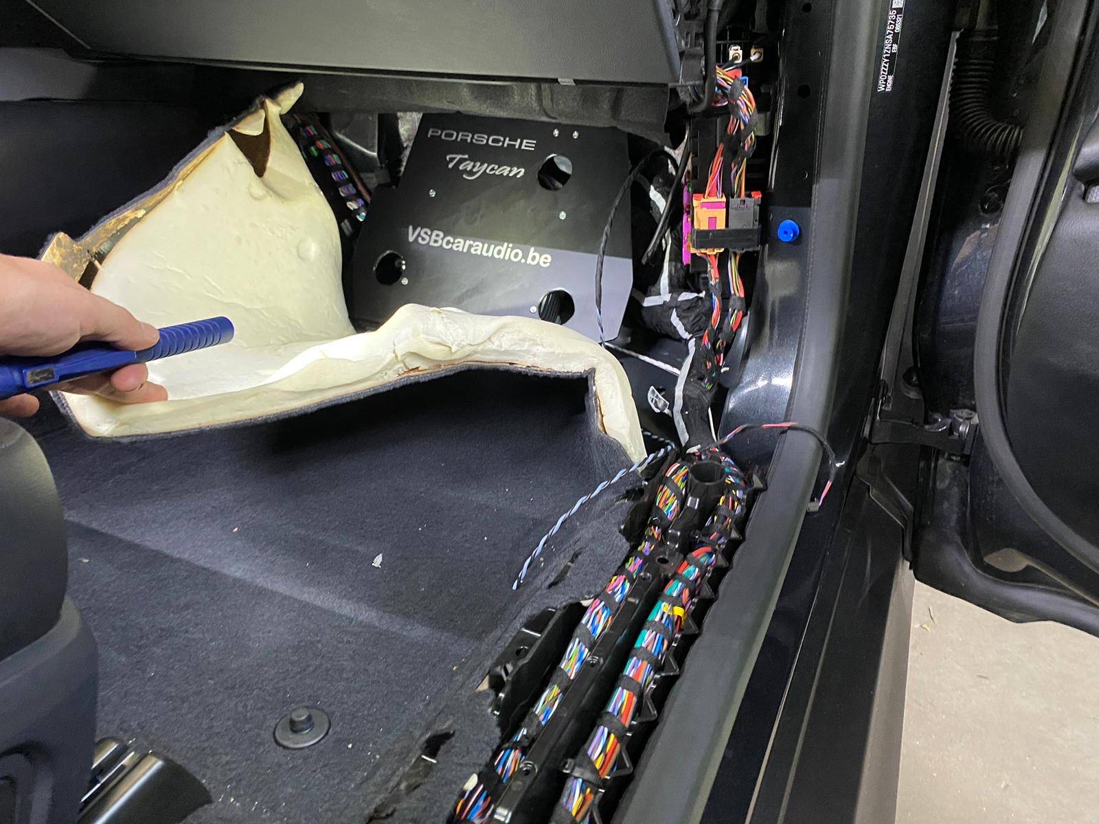

hello,
i just made the audio upgrade (it was the standard audio due to bose unavailability).
Hertz and Audisson front and rear speakers
Audisson DSP Amplifier
I have not required the subwoofer (to avoid the trunk space loss) and also because it is sufficient.
The sound is now really, really good and at the level you can expect for such a car.
Thanks to Jonathan (VSB Audio, close to Brugge) for the great job, very clean job.
He is doing a lot of Taycan for the moment.
JD

hello,
JD

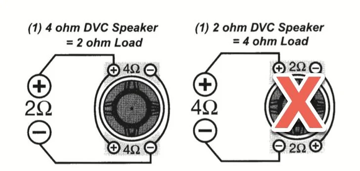

Find were it is and replace the subwoofer speaker with a Rockford Fosgate P3SD2-8 set wired 2ohms. Its almost plug&play and will improve the bass quality a lot. I've done it in my Panamera.
Can you share more detail on what difference in sound you got from the Rockford Fosgate? Was there more bass and was louder or deeper or you could feel it in the car more...? It sounds like an easier mod to just replace that speaker (subwoofer) than to add a box and amps like others have done.
