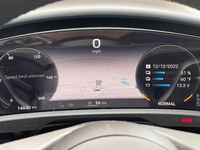

I bought/picked up my CT 4S right after the uPdate was done, but range has been quite poor. I've seen 1.7 to 2.4 mi/kWh as my best (2.4)with most of that being interstate driving with cruise control on between 70-80mph. I have the 20" tires with Pilot Spot 4's.
When I dropped the car off for a detail appointment and battery temp was 60 F, my range was only 96 miles with 51% charge (180 total range at 100% charge if extrapolated).
