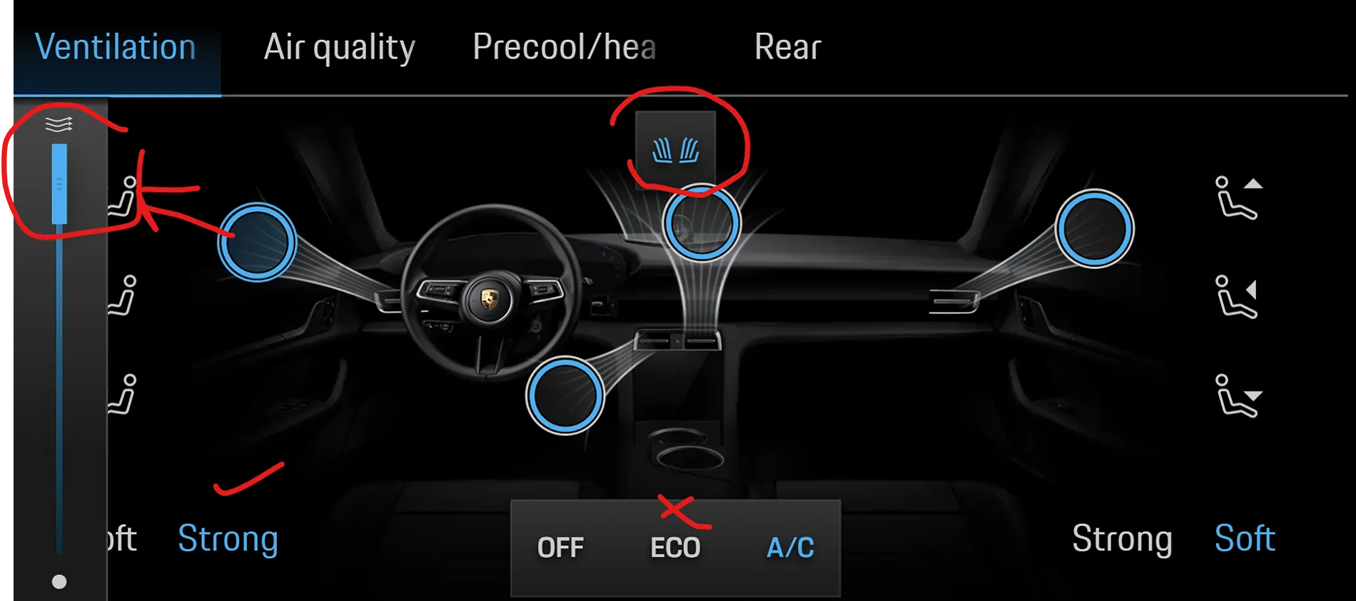

Possible heater issue but check:
Air vents are open and not just pointing in the direction you want. Hold the vent flow graphic to display the slider and adjust as necessary. Repeat for each vent.
Check top vent is enabled.
Check the airflow is set to strong
Check AC is not in Eco or Eco Plus mode.
The temp you set is the target temp and Auto should be the default.
100% that above and it is not complicated, but wanted to add:
Select each vent circle and ensure it is Open (graphic to the left or right appears to control how much open you want each vent to be)
This graphic is from the simulator, but I am sure with a 4-zone you can set footwell temp to be Warmer for example.
Porsche Taycan Taycan Heating Question 1770150499765-o9
