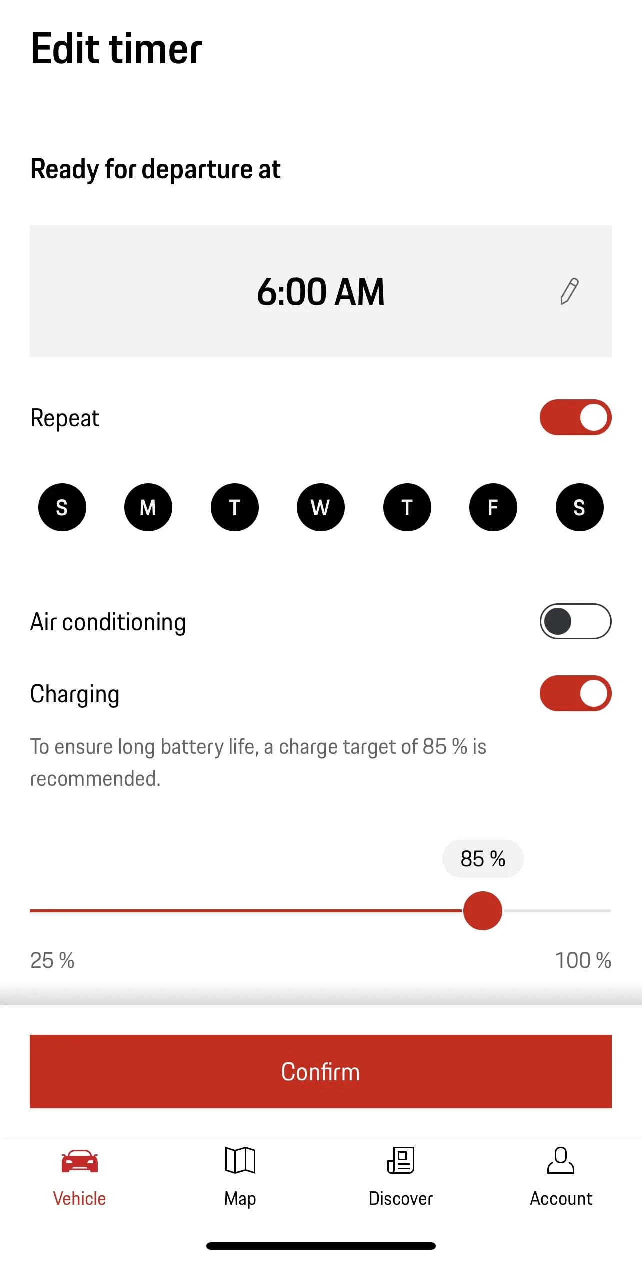

On my MY22, I’ve unchecked that box (pre cool with remote unlocking), keep my car locked in my garage, but EVERY morning I get a notification that “Air conditioning of your vehicle is complete.”
anyone know how to get this pre-cool of air con to be kept off? Thanks

Do you have it set on your timer / profile combination - sounds like you do?
ah got it - that was the culprit. I set the charging timer and just turned off “air con.”
I don’t charge every night so I would assume the pre-cool should only turn on if I’m charging via the timer, but sounds like even if I’m not charging via timer, the pre-cool turns on regardless. Thanks for the note

Good. A timer event can simply be to heat or cool the cabin rather than a charging session. Every day is a learning day.
