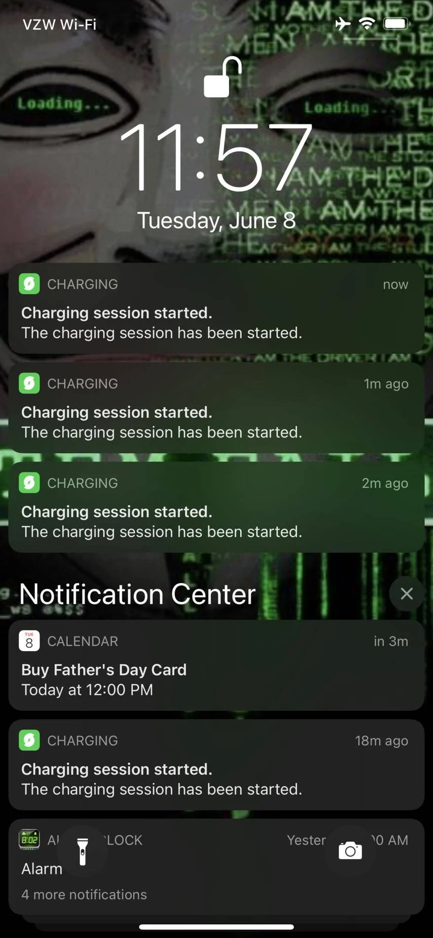

Pump 02 successfully started charging and I walked away. I monitored the progress online via the Charging app. It made it to 67% and then the KW indicator dropped to zero. From that point on, once every minute, the Charging app would send me a notification saying "Charging Session Started." Like it was caught in a loop or something. But no further charge took place. See screenshot from my phone:
Question: What exactly happened here? Is this the loop that leads to the dreaded 12V battery error if you don't break the loop in time?
