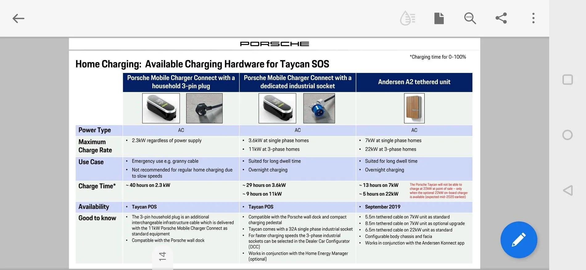

I was under the impression that the supplied commando plug only works at 3.6kw with normal single phase electrics in the UK.

No idea why that info says that. I can definitely get 7kw
Maybe there would have been no argument left to sell the Andersen Wallbox. Honestly, its only "benefit" is being wall mounted without additional parts. But it's extra cost and less funtionality. I really don't understand this sales sheet.

The Andersen guys were Adamant that with the Porsche charger I would only get 3.2 or something. I knew he was wrong. I. Single phase 32Amp you will get 7.2 on three phase you will get 11kw. The max on the Taycan.
