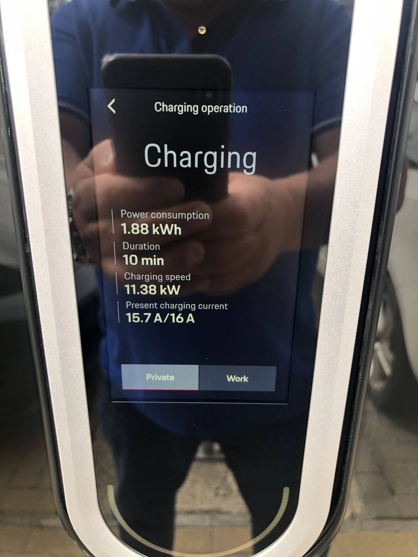

I'm using the Porsche Mobile Connect and have had a 32A fuse and commando socket fitted so that I can use the 32A dongle that came with the charger. However, it's limiting itself to 16A - says so on the screen. "Maximum 16A". This is at home on single phase, by the way.
Any ideas why it does that?
Did they deliver a 11kW version of the Charger Connect to you? Can you check the backlabel of the charger? Otherwise it does not make sense as the 22kW versions definitely charge with 7.2kW on single phase.
You're absolutely right...I seem to have a 11kW version of the Charger Connect, which does show 16A on the back.

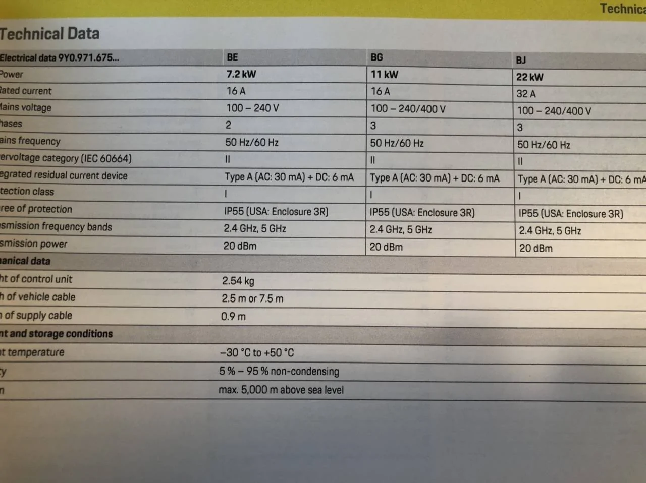

Not that it matters to have the 22 kW PMCC since the car can only support 11 kW.
But here is a photo of the manual. There seems to be three version around here in Europe. Ihave got the 22 kW with a 23 amp connector but can not use all of it. Afriends Zoe could though!
