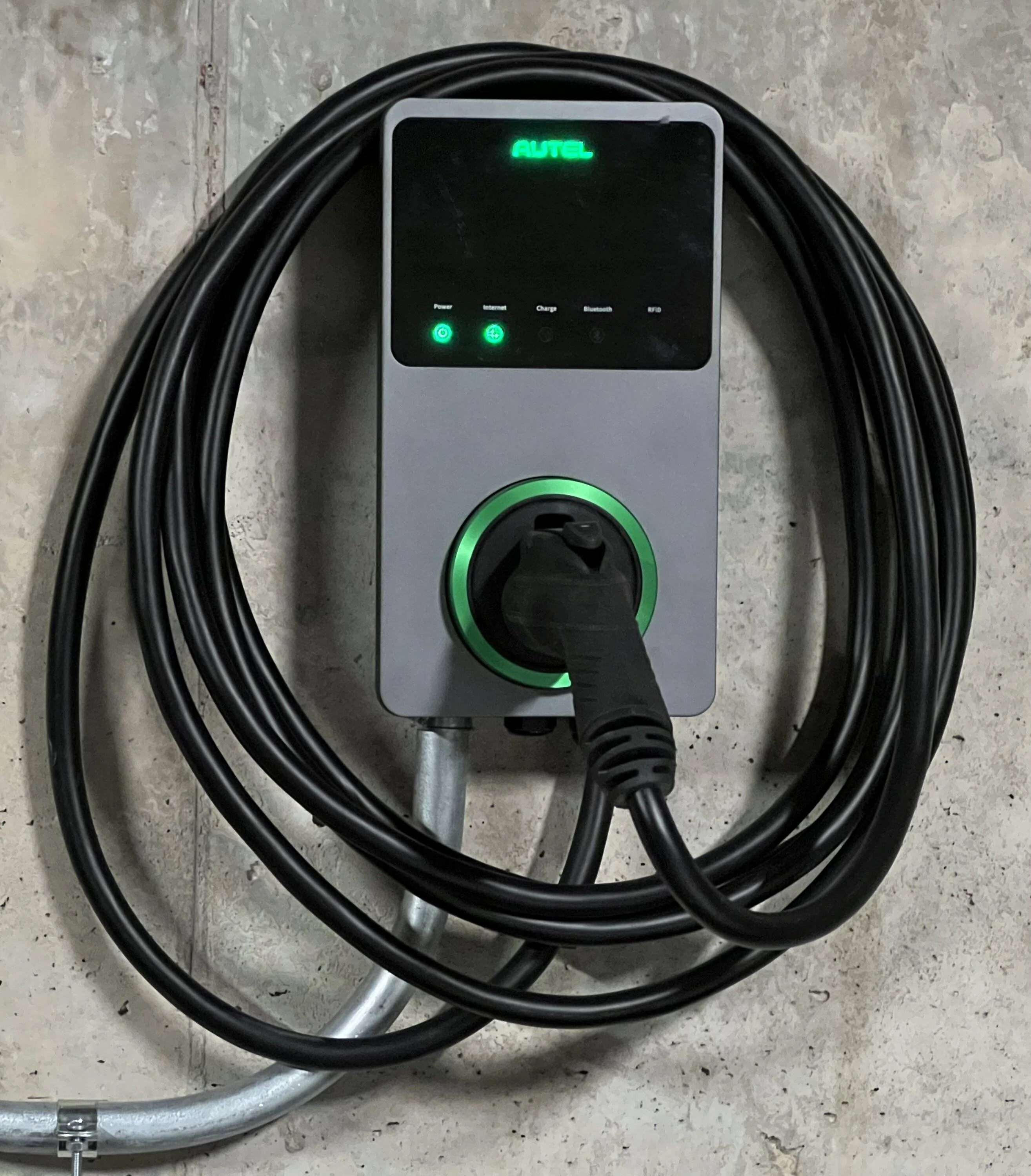

I won’t have my Taycan for another few weeks (due to arrive at dealer 12/2) but I’ve had my Autel maxicharger hardwired to a 70A breaker for about a month now and it’s awesome! :like: I have it set to 50A charging 12kW - yes I know the Taycan can only do 48A at 11kW .
What’s so awesome about it? Well, for starters it has pretty damn good wifi range, if that’s important to you. I live in condo building and share a big basement garage with 6 neighbors, who all have their own smart EVSE from Tesla, Juicebox, and Chargepoint. None of theirs can connect to the closest wireless router in our lobby common area, located 1 floor above through a concreteceiling (everything is concrete in the basement garage). My Autel, surprisingly does! It connects, and with a nice iPhone app I can check charge statistics and history remotely, set a price per kW to track charging costs, change amperage settings remotely, initiate charges remotely (though I will probably just set it to auto-start upon plug-in), and on top of that it has a full suite of features most people probably won’t need in an EVSE: bluetooth connectivity, ethernet connectivity, and RFID/NFC activation via RFID card or NFC chip in your iPhone to prevent unauthorized use when installed in a shared parking garage like mine (not that I don’t trust my neighbors). Best part is it only cost me $440 on amazon (amazon frequently puts these on sale since it’s new) versus the $750 for the Chargepoint unit I originally wanted but didn’t because it was out of stock. The one thing I can’t yet confirm about the Autel that actually works is… charging an actual EV! Yeah, sorry, the Taycan will be my first EV so I have yet to test what the Autel‘s main purpose is lol. ? I‘m sure it’ll be fine. I suppose I could bother my neighbors if they’d let me test it on their Tesla or etron, but just haven’t found the time.
