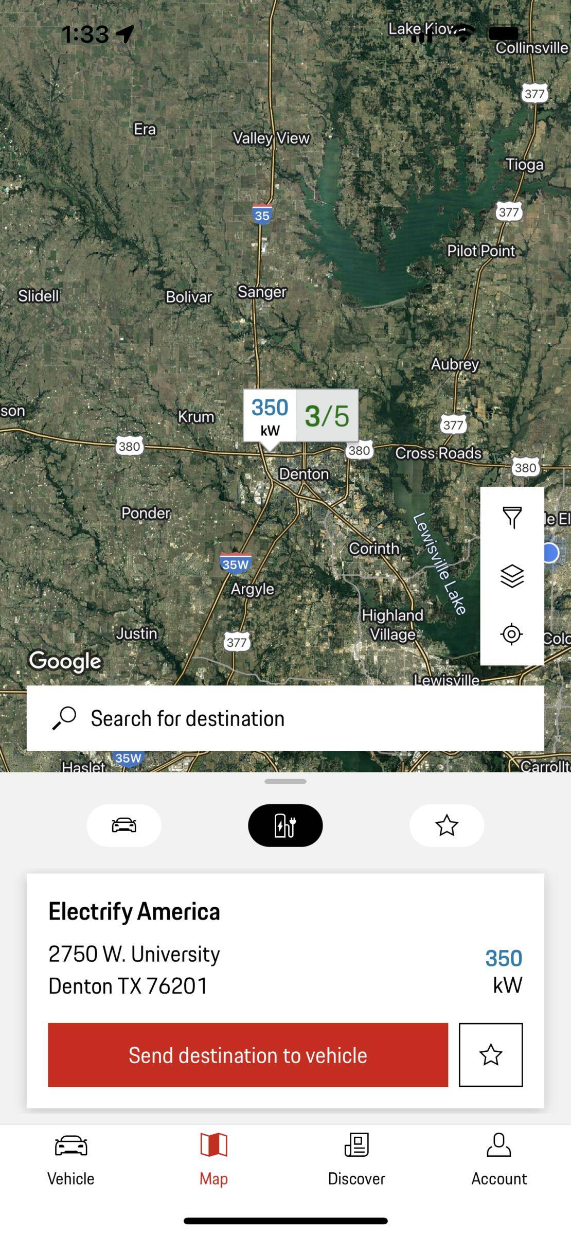

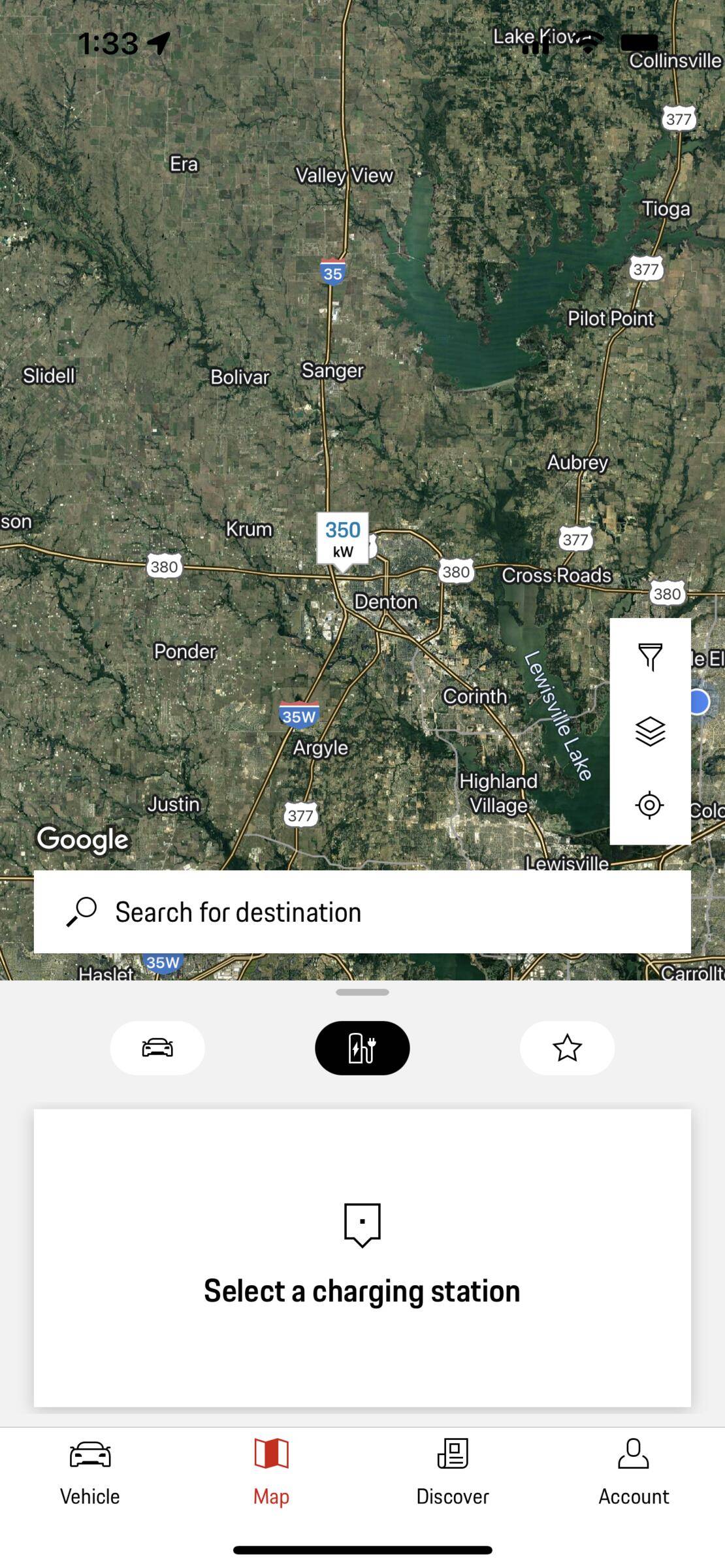

1. Select the map tab and click the e-pump (center button)
2. Tap the callout for the charger on the map. Note the bottom card changes to reflect the charger address.

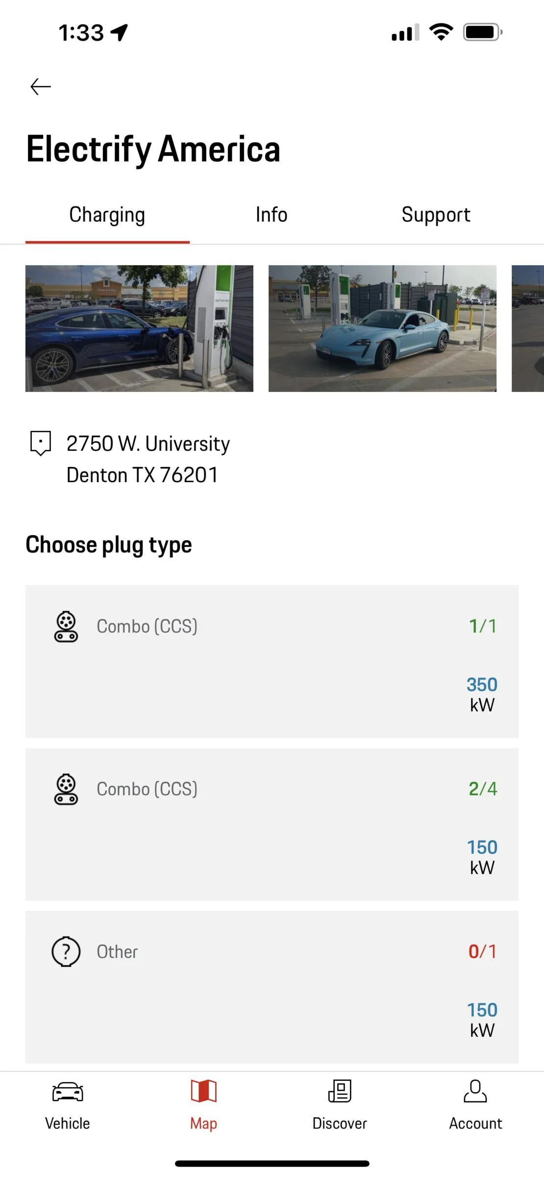

3. Tap the card (not the red button or the star to favorite it) - you will now see additional charger details.
Porsche Taycan Using Electrify America for first time IMG_0205

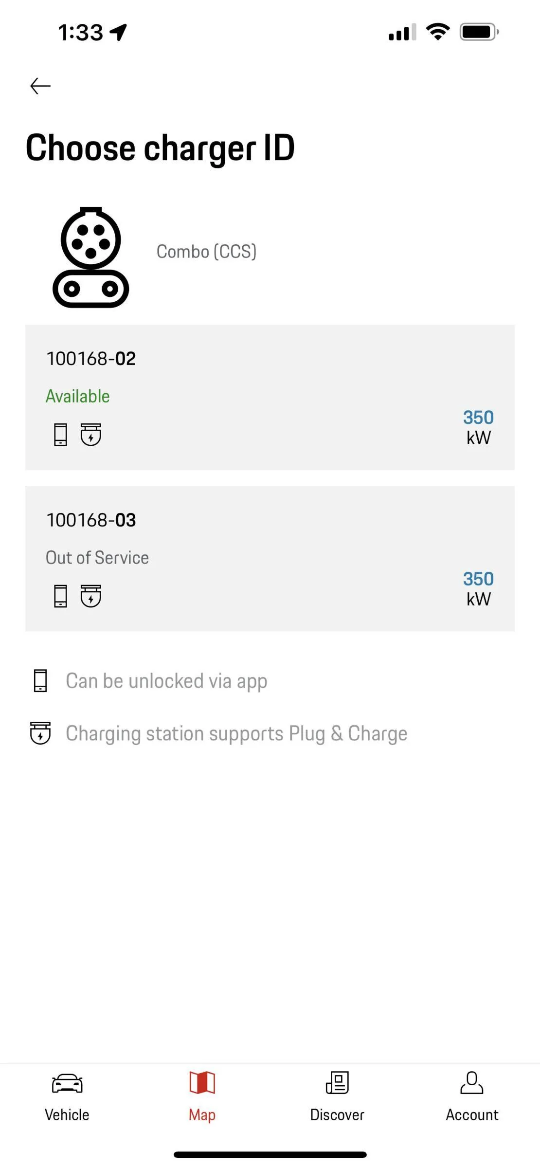

4. Tap the card for the charger type you're using, 350kW or 150kW. You will now see available units:
Porsche Taycan Using Electrify America for first time IMG_0206

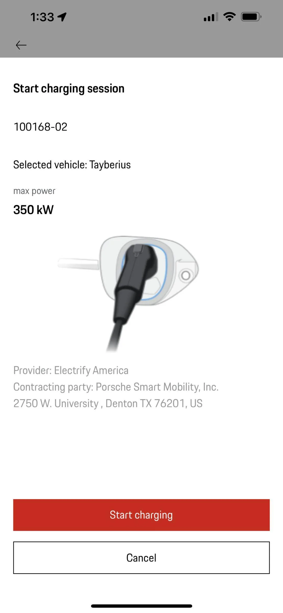

5. Tap the charger that corresponds to the one you've plugged into. You'll see this page with a red button to initiate charge.
Porsche Taycan Using Electrify America for first time IMG_0207
