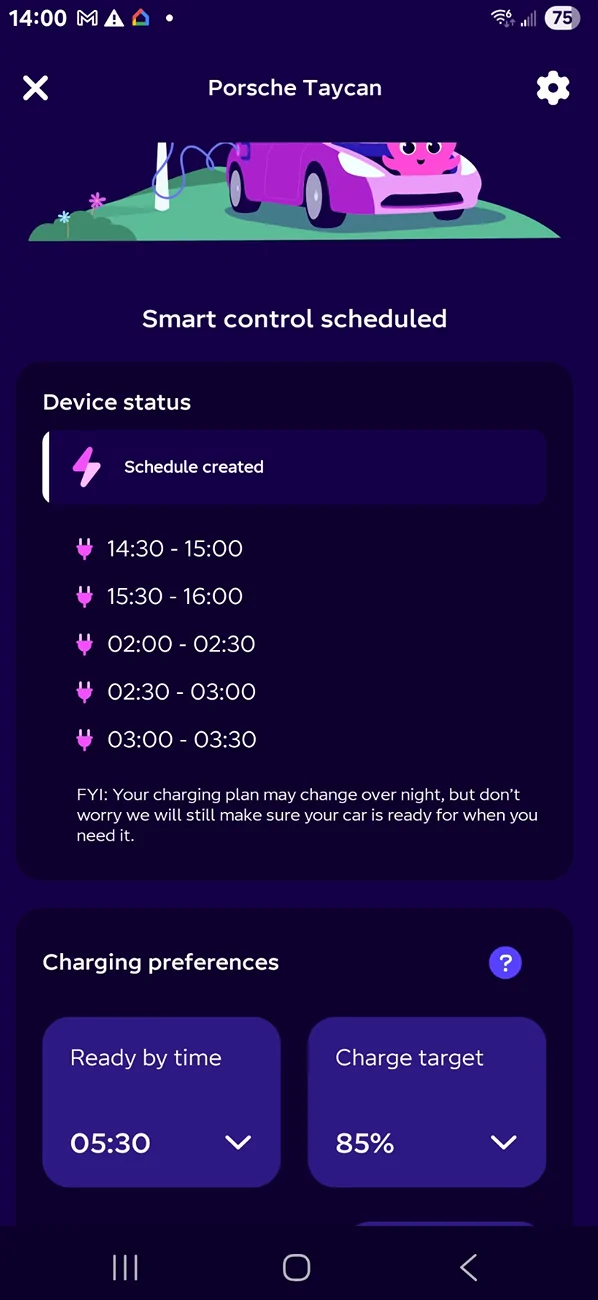

Perhaps I am not being clear tophamn.
I plug the Taycan in
Octopus sometimes recognises, sometimes not, but when it does recognise the Taycan is charging, a shedule is created - example below.
Porsche Taycan wall mounted charger 1757252759690-y3
The following day you can look at your electricity charges in the Octopus app and check the number of kW charged off-peak and peak, where it is very easy to see if the off-peak number matches the charge % increase and also if the peak charges are aligned with other days in the week.
As a rule of thumb every kW charged by Octopus should provide somewhere between 0.9 kW and 0.95kW to the Taycan battery.
The usable capacity of my larger 93.4 kWh Taycan 4S battery is 83.7 kWh, so for every kWh charged by Octopus, you get around 1.19% of additional charge at the Taycan battery.”
So much as it may surprise you that I am sometimes charged peak rate when charging my car, I can assure you that is my reality when checking in the Octopus app.

You _are_ being clear and thanks for the extra information - I wasn't aware that the app was clever enough to know when cheaper charging had been scheduled outside the usual hours. I've checked my own usage and see it clearly - so as they say: "every day's a school day".
I can't be sure but I suspect you're suffering from the effects of the poor communication between Octopus and the car. When I set up Octopus to contol the car I regularly experienced missed messages leading to either failed charging or a failure to stop charging. Have you been able to correlate the charging schedule provided by Octopus with the time the car is actually charging? - do they match?

It is sad to say that there is no correlation between the schedule that appears in the Octopus app and what happens at the car.
The times displayed in the Octopus app are I believe when they may charge the car, not that they actually will.
I also experience charging when the app advises there will be cheap electricity and I am charged at full rate.
I either need to go back to the old way charging which involved setting an off-peak timer and a preferred charge time profile in the Taycan app or car, or switch to OVO and experience the satisfaction that W1NGE describes.

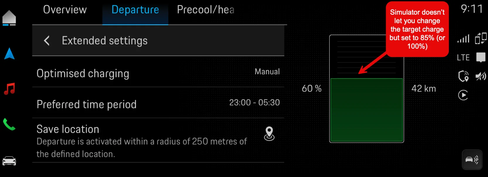

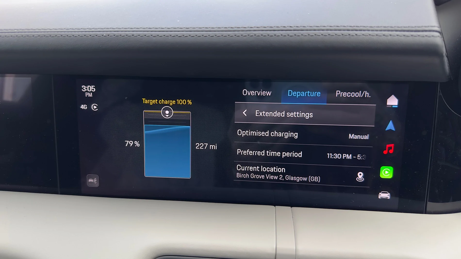

Given you have a J1.2 Taycan (facelift) then the concept of the 'profile' has been consumed into the overall 'Departure Timer' and subsequent advanced settings otherwise I'd be advising to use a location based profile, minimum charge of 25% and a target charge of 85% between the hours of your off peak. Providing that there are no other profiles or timers active OR programming set on your Andersen then it should just work like everyone elses.
For your car I would set the following:
New Departure Timer:
1. Ready by 08:00 (or whatever)
2. Daily repeating timer (doesn't matter if you don't plan to charge each day)
3. Extended settings --> Optimised Charging set to ''Manual'
4. Preferred time period --> 23:30 - 05:30 (your off peak period)
5. Set target charge level - 85% (or whatever)
5. Save location (call it 'Home')
6. Enable the timer (disable any other active ones)

appreciate you taking the time to explain all this. I'll follow your advice , which I'm sure will work perfectly.
Thanks again. 👍
