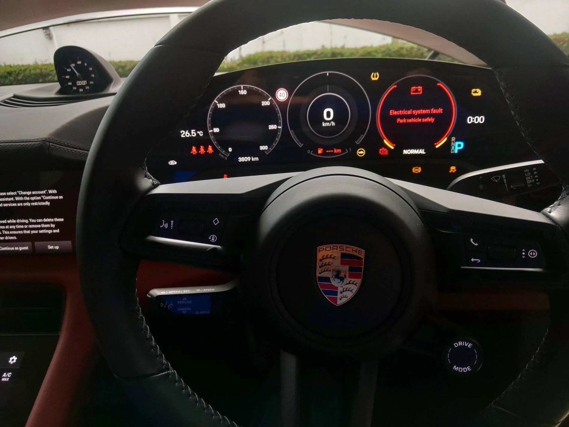

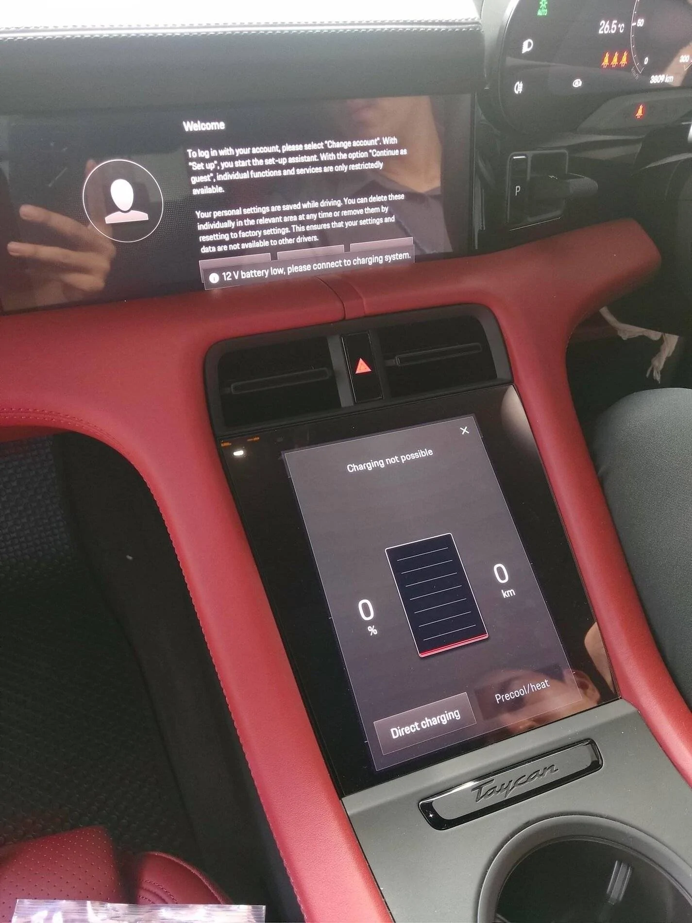

My car was dead, 12 v and driving battery were gone, I code AMB 5 re program power electronics
Woravich
woravich
Oct 4, 2021
Thailand
Porsche taycan rwd
I parked my car for 2 weeks, and I dropped my key in the car, then everything was gone, I tried to wake up the 12 v and plugged the Ac charger and then the red light button nearly the plug-in appeared charging not possible, now my car is in service centre, they told to do something that called campaign, or replacement inverter battery, how should I do?
