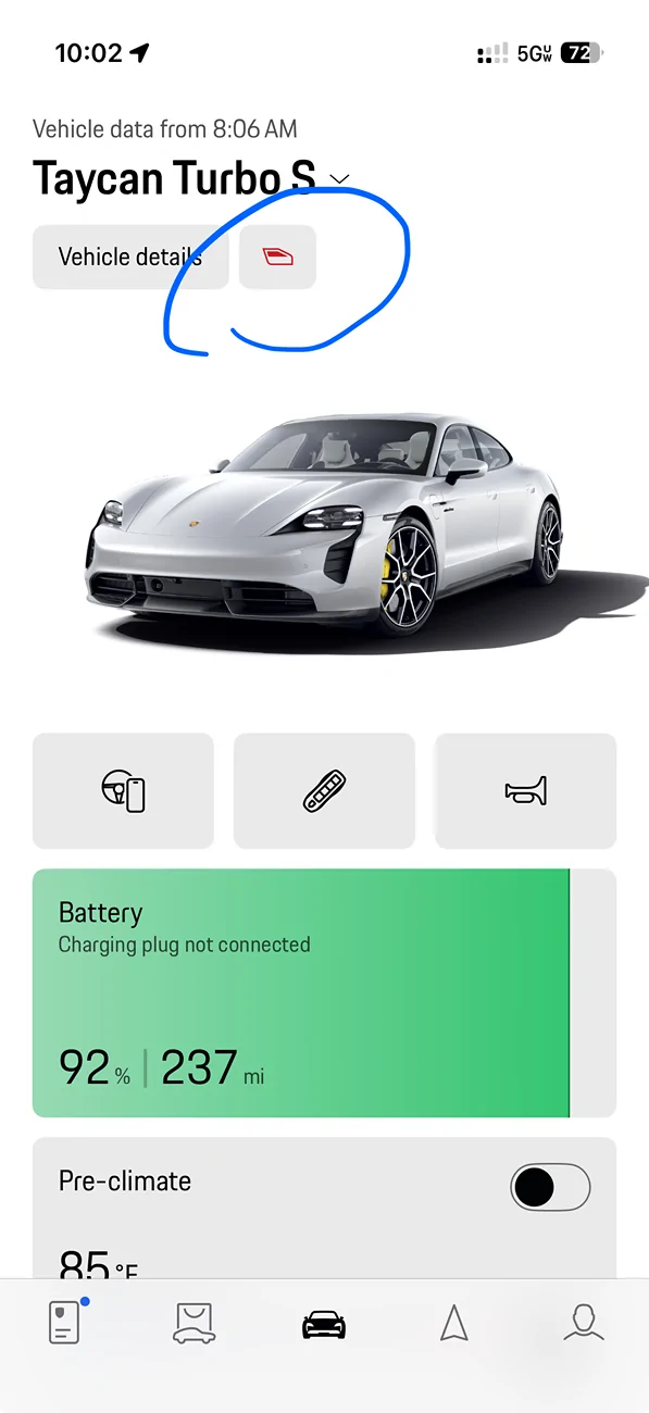

Does anyone else have the issue where their app states that the rear windows are open when they clearly aren’t?

Yes I do sometimes. It helps to open and close that window or just update status thru swipe in the app and it dissapears.

It was a similar thread recently. Lots of ppl have this. It is apparently a delay in the cloud.
you can for instance use the app shortly to update the cloud connection by honking or locking your car
I don’t know how to link to another thread. But this is the title: ‘Apps often says windows are open’

It’s a known “bug” in the sense that the stupid app assumes windows are opened until it updates itself.

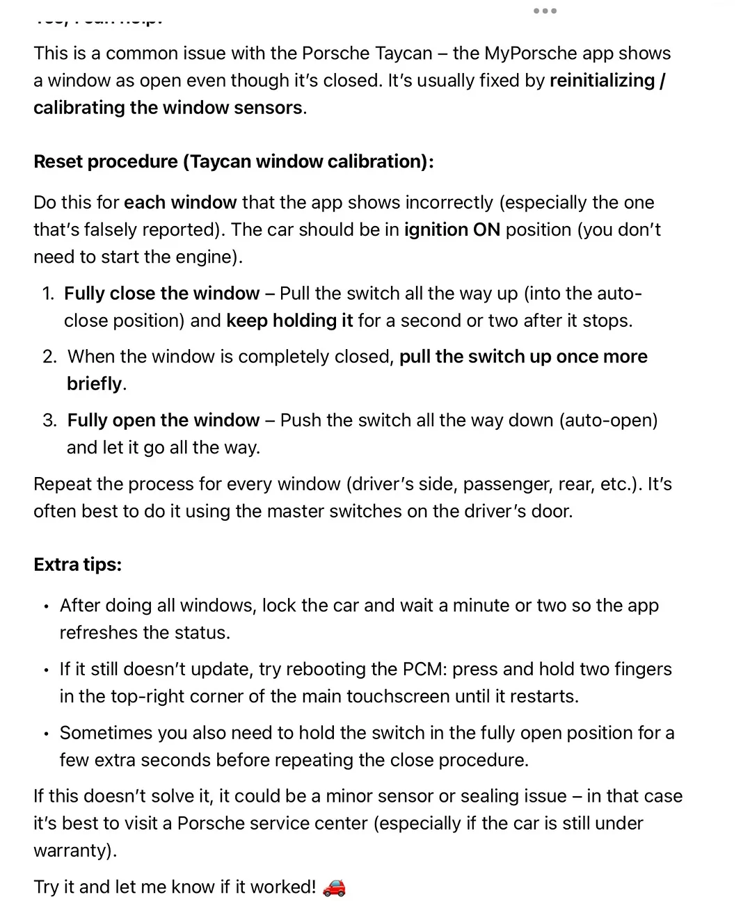

I had that issue a while ago,,, and i found somewhere a procedure how to reset sensors…but i couldn’t recall it 😇🤦🏻‍♂️
I just remember that it has to be done in the car, with window open/close button…
Grok helps:
In the linked thread above - I tried it but it didn’t fix it for me.

I had the same problem and described procedure fix it (without extra tips)🤷‍♂️

Thank you — will try!
