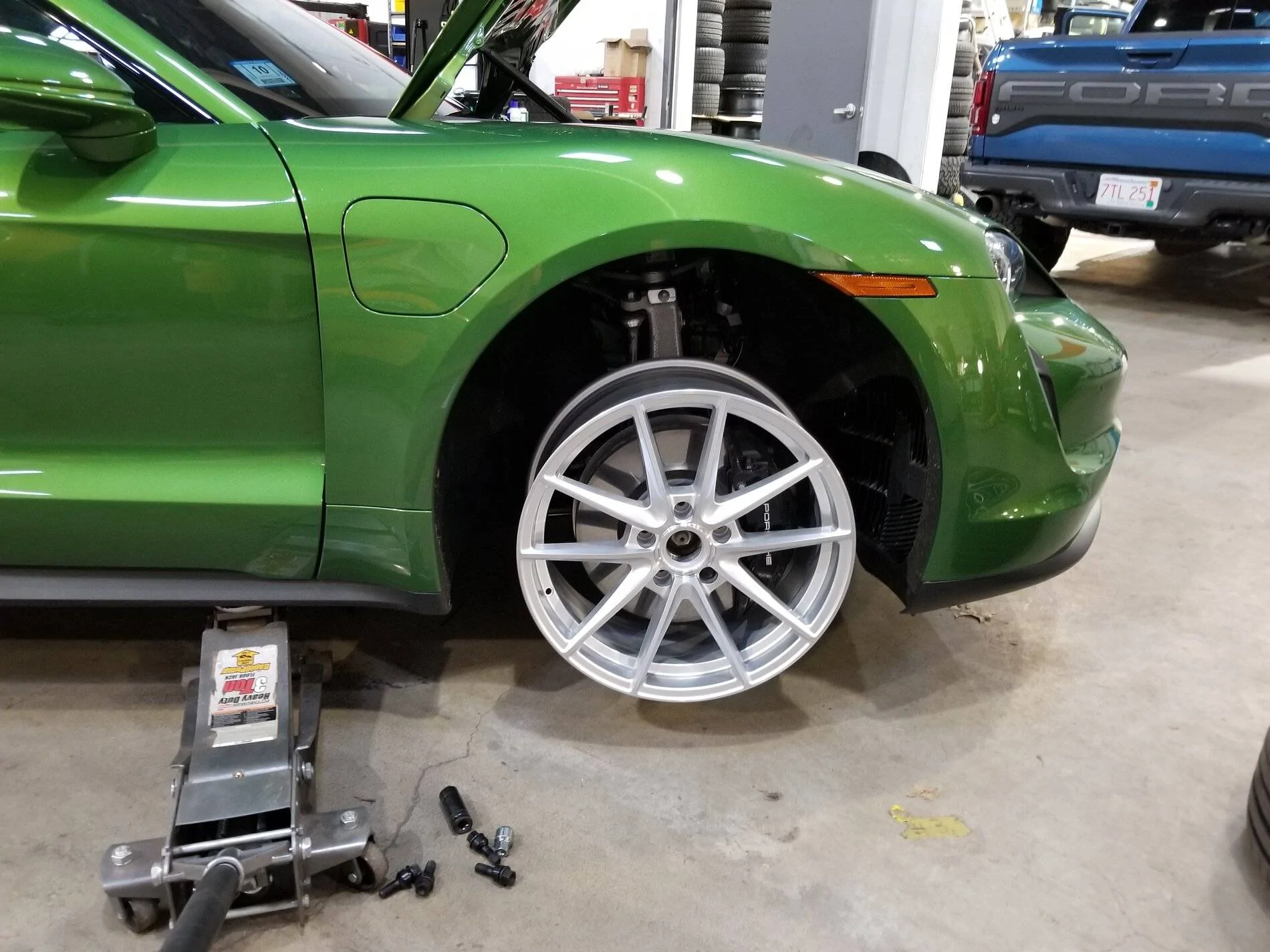

The Stabil was sold out so I am using the Zuffen wheel from Victor Equipment. I could only get silver (damn covid supply issues!) so will powder coat satin black. Offset and caliper clearance is ok. Stay tuned for the final product.

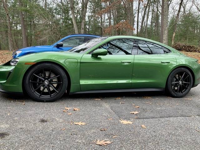

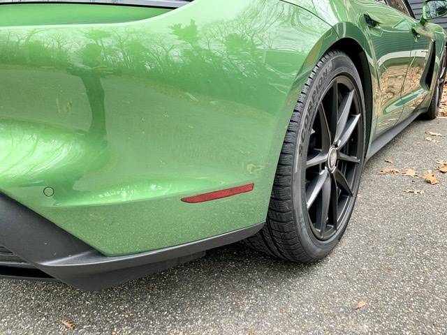

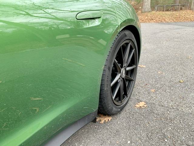

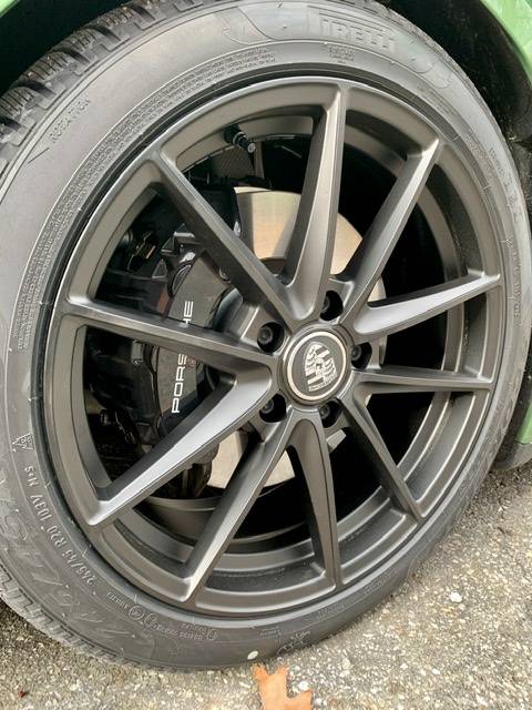

I’ve mounted up winter tires. I went with Pirelli Scorpions in the oem 20” size. The wheels were a bit of a puzzle to figure out and I found Victor Equipment Zuffen wheels -F/ 20x8.5 RO 45
R/ 20x10 RO 50
The matte black was back ordered so I had them powder coated semigloss black. Matte wheels are hard to maintain anyway. Victor Equipment wheels use the stock lug bolts so it was an easy switch. The offset has them sitting about 3mm farther outboard and the narrower rims should be better protected against curbs and sharp edged potholes. All in mounted and TPMS installed for about $4200
