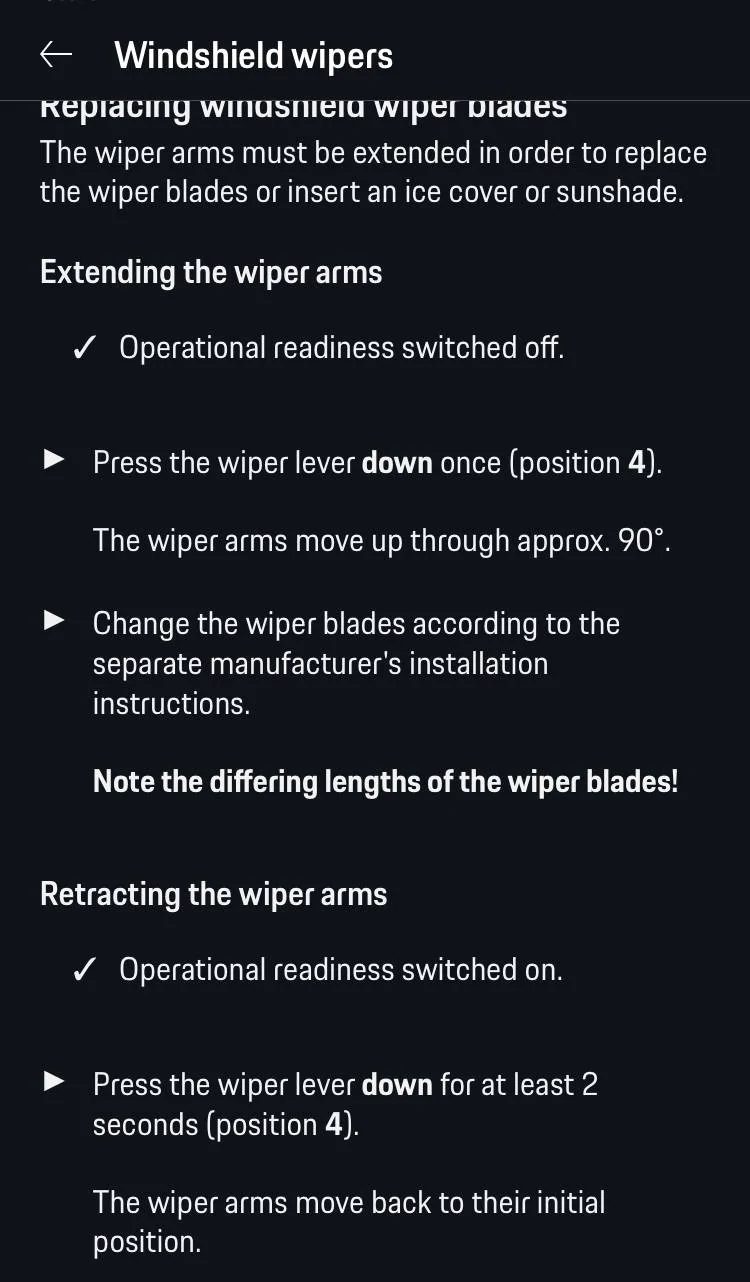

Sounds like a treatment was applied to the glass incorrectly leading to juddering wipers.
Try cleaning and polishing the windshield with glass cleaner. Additionally clean the rubber on the wipers (put wipers in maintenance mode to make the cleaning easy).
Tino82
Nov 30, 2021
151
86
Scotland
How do you get the wipers into maintenance position?
