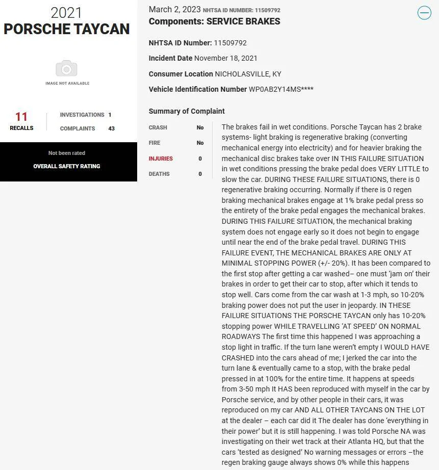

I too have suffered with this same issue, when I took the car to Porsche they claimed they had not heard of this problem before.
It's rather terrifying. Sadly I'm in the UK so cannot contribute to this NHTSA complaint.

I'm glad there's a complaint. Maybe Porsche will actually look into it.
I've witnessed a few times that the brakes didn't engage nearly as much as expected and I had a distinct "long pedal feel" followed by a panicky slamming of the brakes. Always happened to me during conservative driving early in the morning, in the cold and wet (ie when the car is 'cold soaked'). Not very reproducible, I'd say it happens about once a month when driving daily here in the PNW winter.
The reason that I'm not running to get it fixed is simple: the only thing I get from dealers is "well, we've never heard of this before" and "when we drive the car around the block it works fine".
I've had it happen often enough, and I've heard others report it frequently enough that I believe it to be real. If I had to guess, under some circumstances the car thinks it's getting enough regen braking so it doesn't "boost" the conventional braking, but in these situations regen braking actually isn't doing enough to slow down the car (bc of the cold). Then when it does pull in enough 'conventional braking' the disks are wet/cold/rusted and take a split second to get up to temp.
IIRC Tesla also faced an issue where the auto-regen braking in some cold conditions had unexpectedly weaker braking. I wouldn't be surprised if this is the kind of stuff all the different companies need to work through as they launch their EVs. Where Porsche is different from Tesla is that Tesla has the actual brake pedal always skip past regen into normal braking, so Tesla avoids the "oh shit" feeling when the actual brake pedal seems to be too weak.
