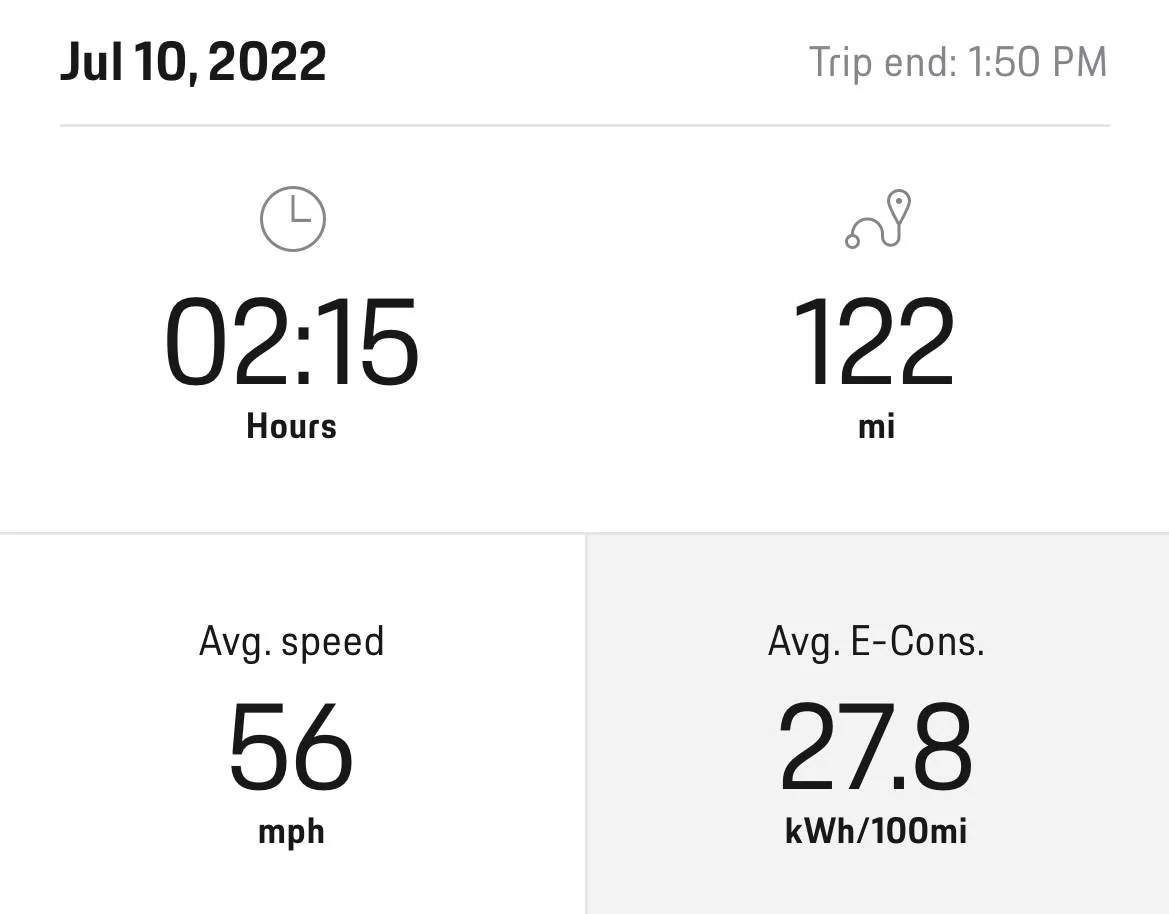

Trip out:
Porsche Taycan 244 Mile Round Trip Took 84% SoC 33362989-AE63-4F33-9416-704000FB5FDE

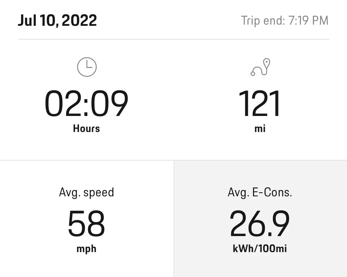

Trip back:
Porsche Taycan 244 Mile Round Trip Took 84% SoC 443DDD0E-7893-4C0C-8794-CF5E649720DB

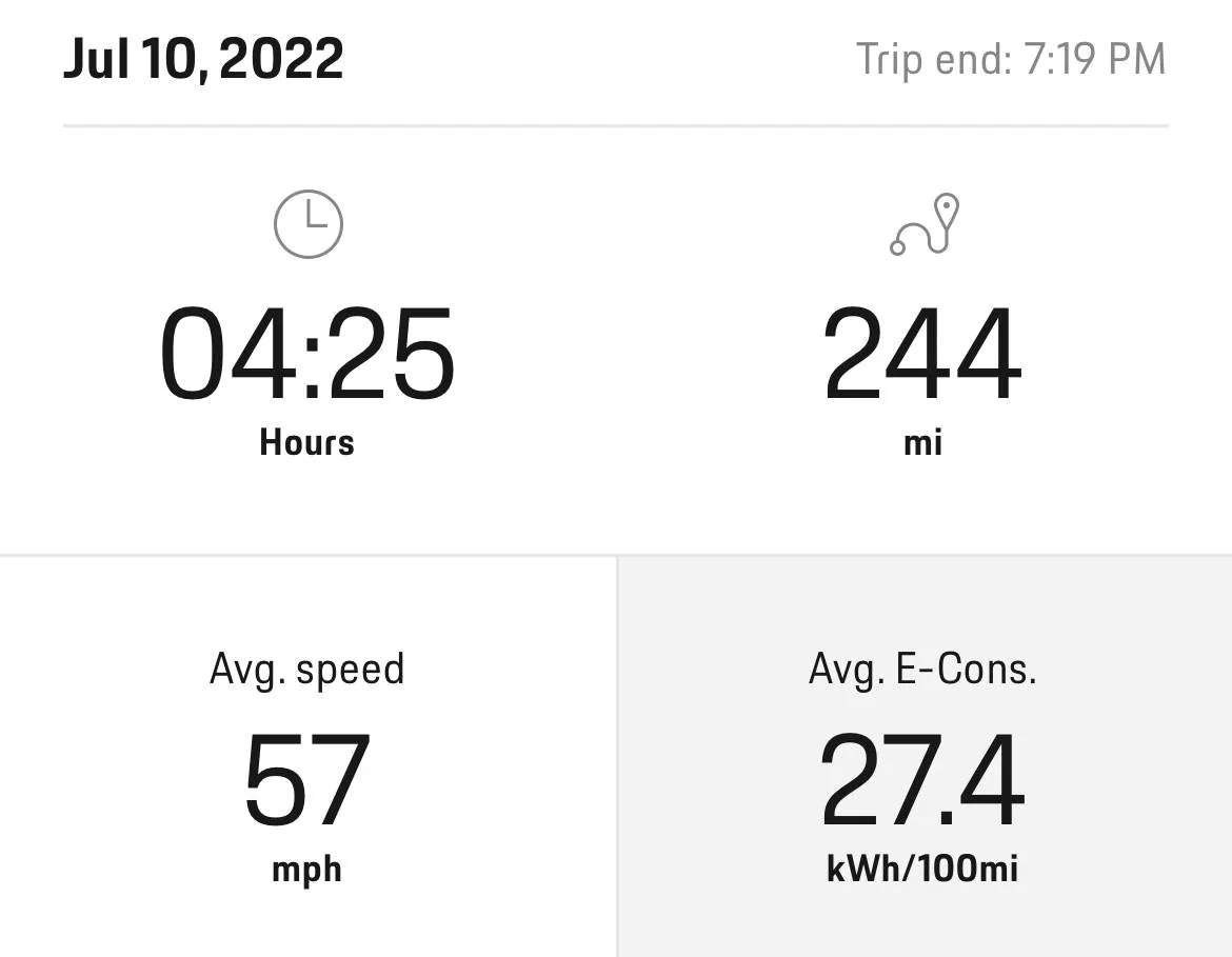

Full trip:
Porsche Taycan 244 Mile Round Trip Took 84% SoC 01B01473-85DC-4CE7-A6AE-F4962712393F

It took 40% SoC to go out (100-60) @ 27.8kW/100mi and 44% to come back (60-16) @ 26.9kW/100mi. Seems like there’s some missing information somewhere.

I would expect either of those to be reflected in the consumption rate.
My issues is, why would the same distance at a lower consumption rate use more battery percent?
I can only assume there is other missing information, or possible the better measurement can just be that far off.

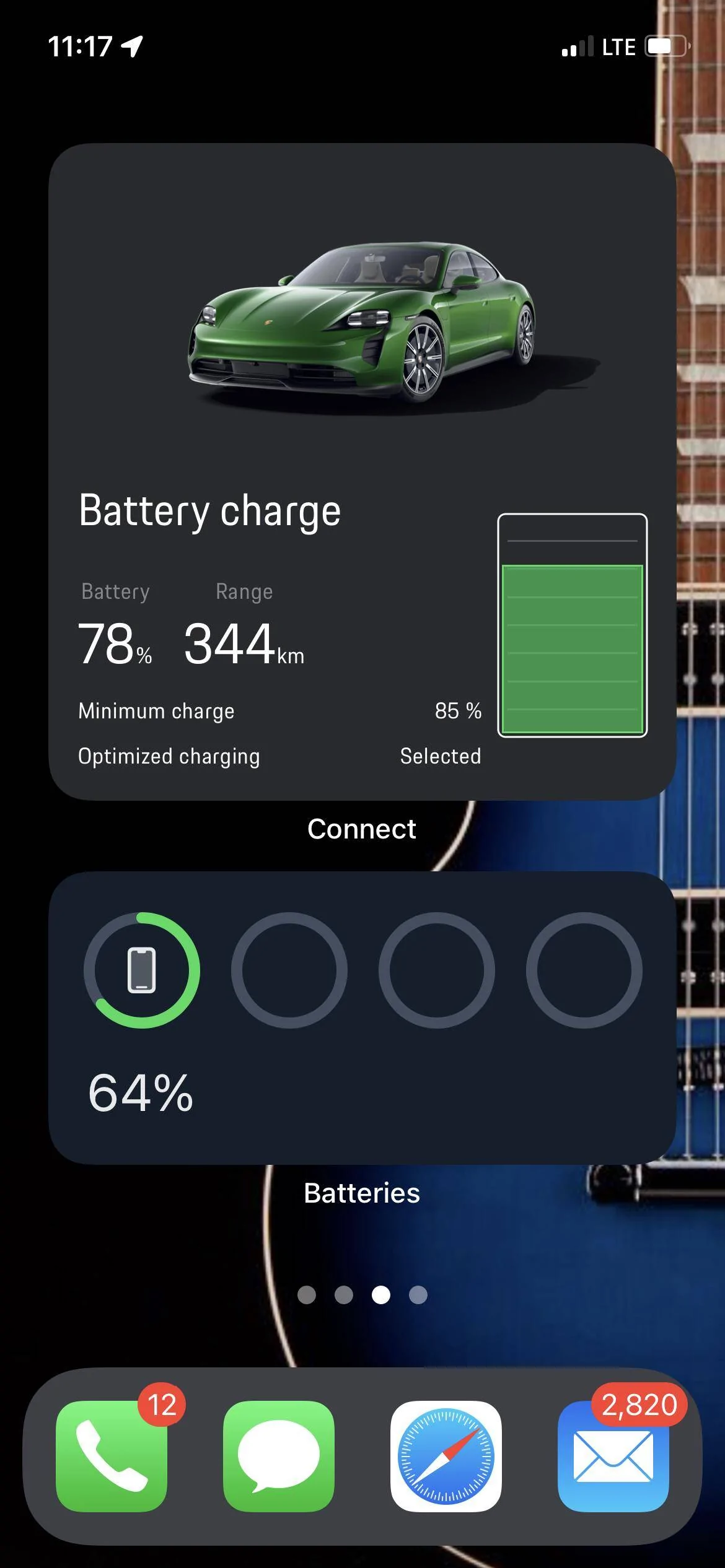

@Jhenson29 What was the source/app for the trip data images you posted?
Connect. it’s the old app before the newer my Porsche release. I still like it better, not least because it has a widget like this:
