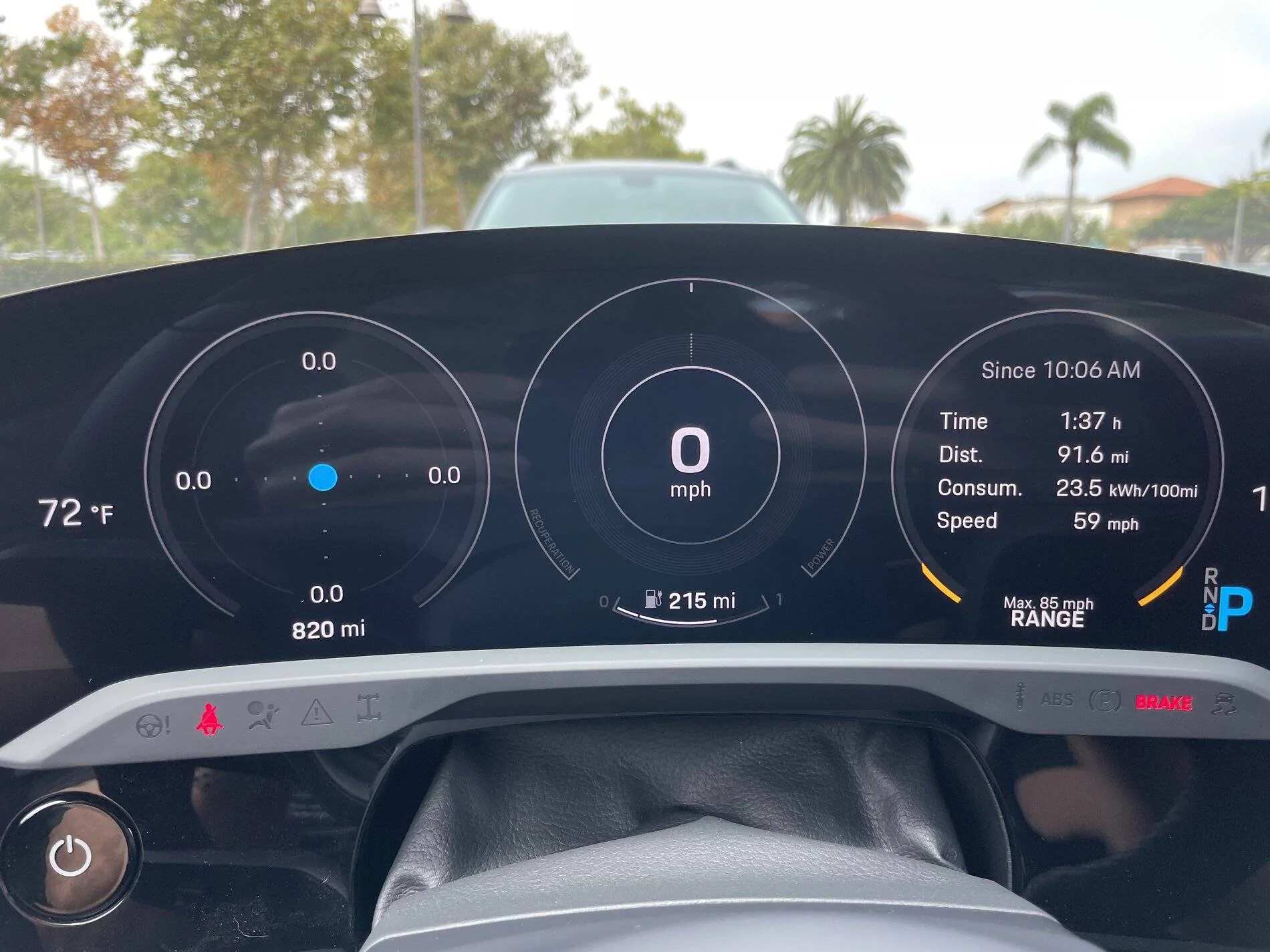

The entire drive was basically performed at 75-78mph with ACC/ALK enabled.

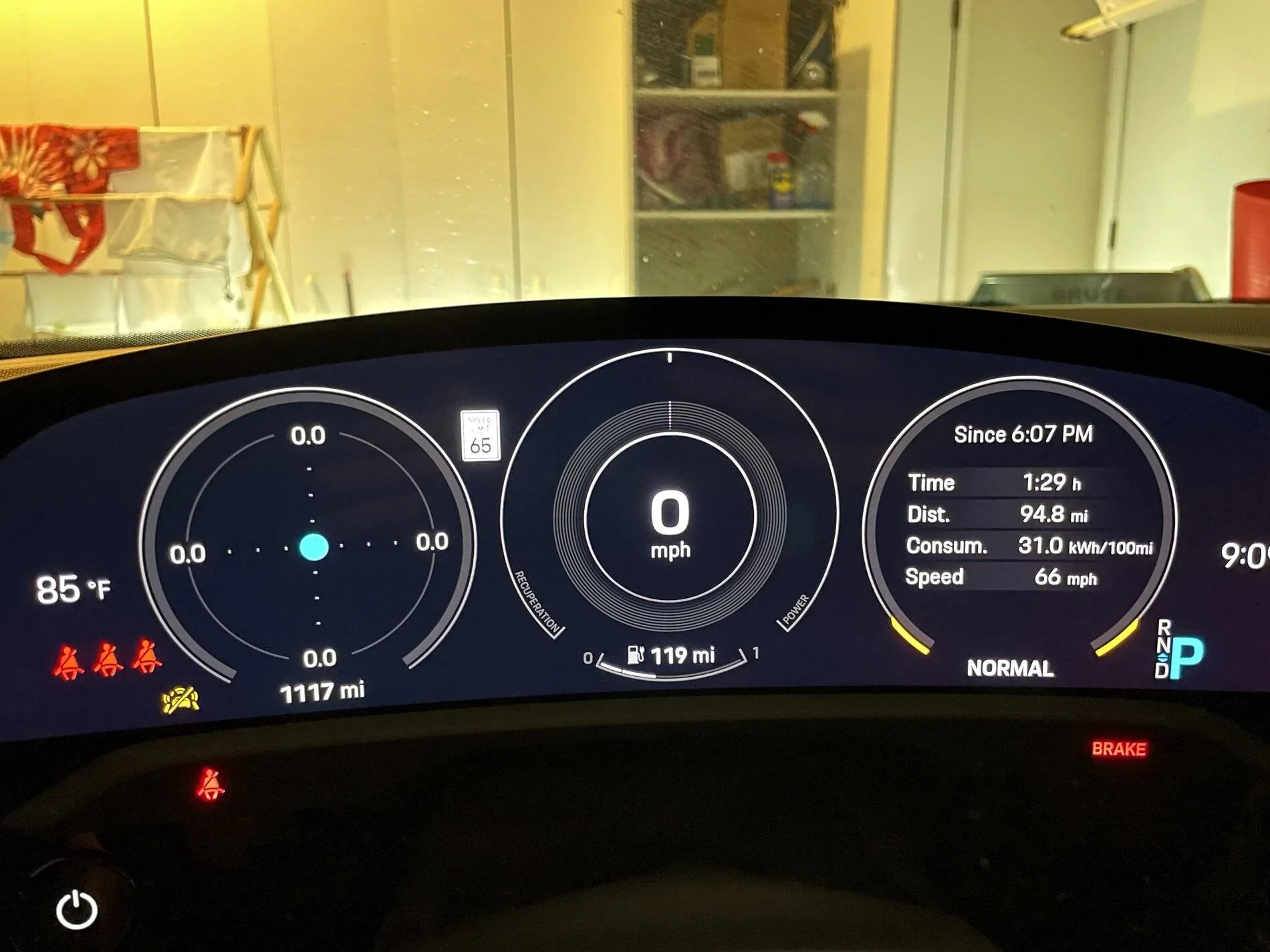

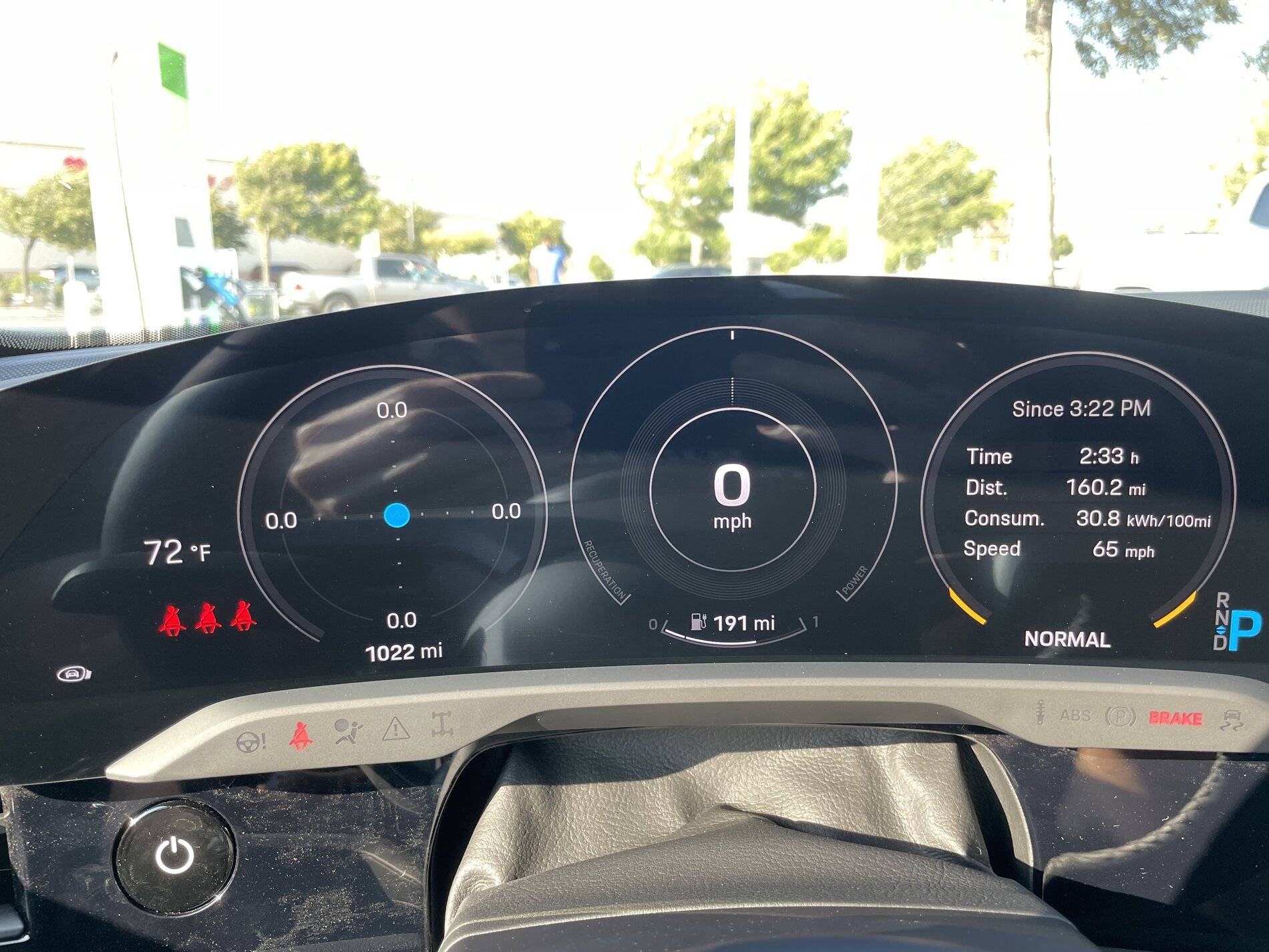

I planned my route assuming 330 Wh/mi, but in actuality the Taycan performed better than I expected. For the first leg from LA to Solvang, I got an impressive 235 Wh/mi:
Temperatures were in the low to mid 70s for this leg. As mentioned above, I used ACC/ALK for basically the entire drive, with Range mode engaged and A/C set to 70F eco mode.
For the second leg from Solvang to Soledad, efficiency was a bit worse, but still an impressive 308 Wh/mi. Temps were higher for this part, with a large portion of it being more inland and thus higher temps, reaching around 90F at the highest point. Some elevation gain as well, I believe, since I was going from the coast and driving more inland:
And for the final leg from Soledad to the Bay Area, a comparable 310 Wh/mi:

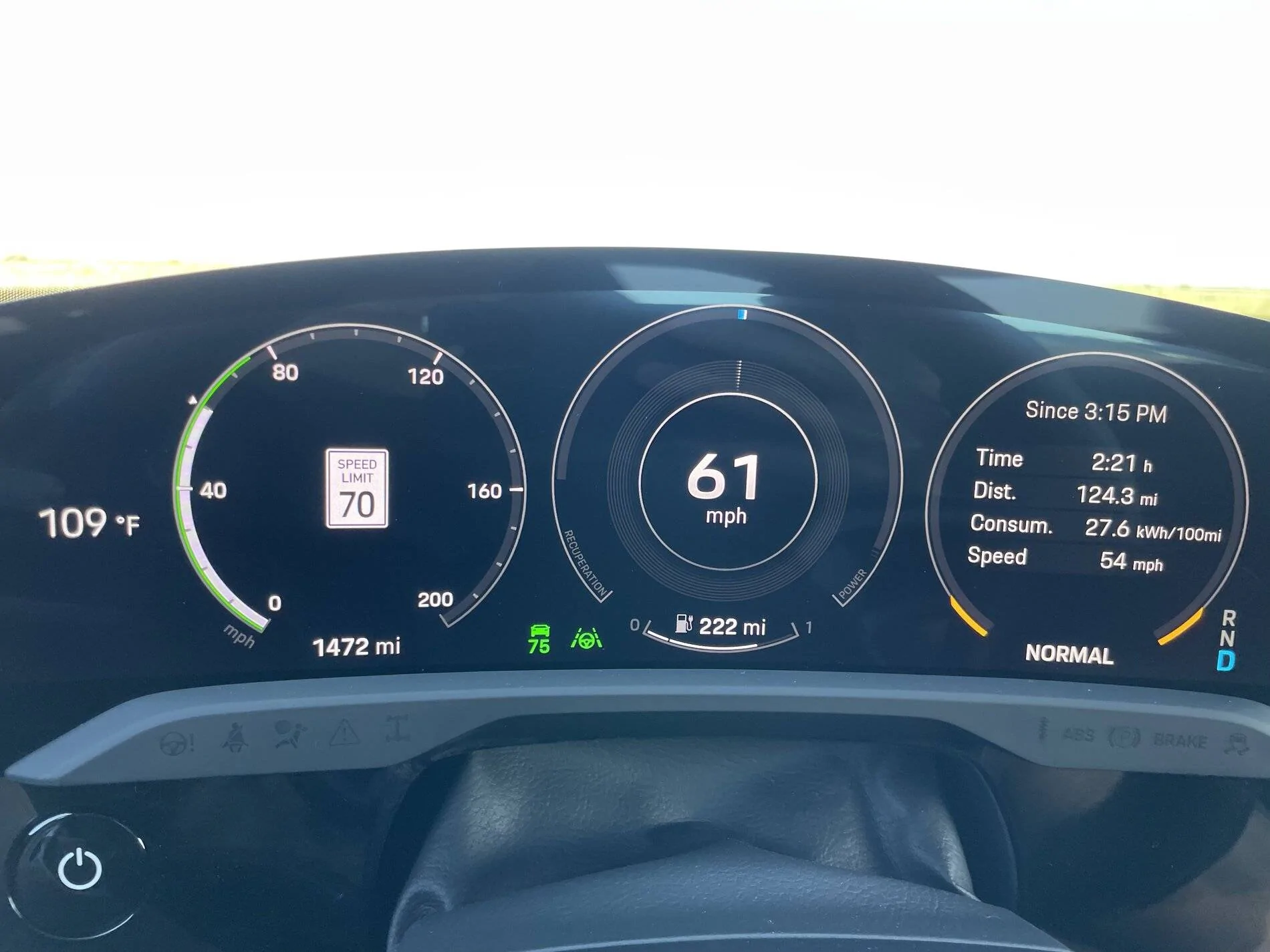

For the return trip, since I took the 5, the entire drive was in much hotter temps, ranging from 90 to 110F. The first leg from the Bay Area to Firebaugh was again, excellent consumption:

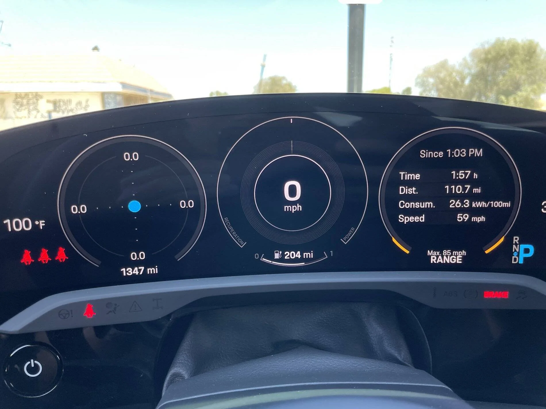

And from Firebaugh to Bakersfield, with temps ranging from 100F to 110F the entire way, an excellent 276 Wh/mi:

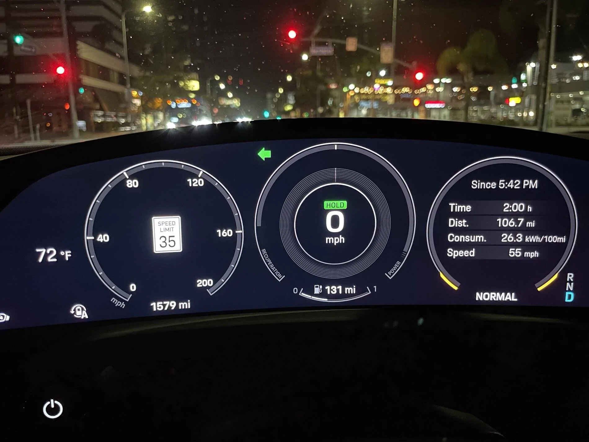

And finally, from Bakersfield to LA, again, an excellent 263 Wh/mi:

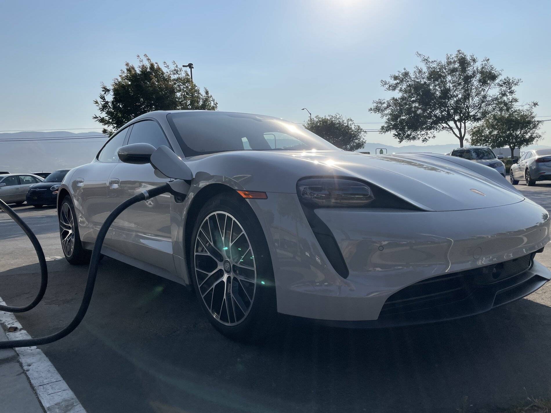

For the most part, this went well. As I've mentioned, I had 4 total stops at EA stations. I also charged at my destination in the Bay Area.

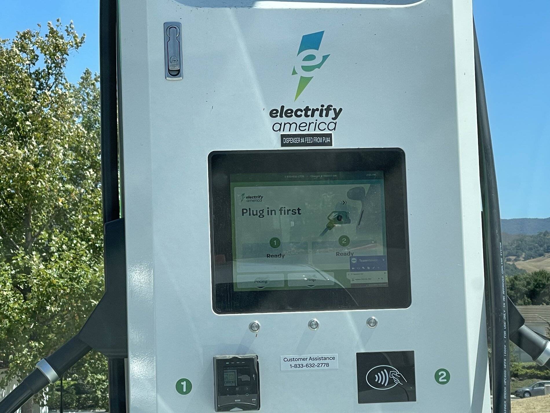

I've never been able to get Plug & Charge to work, and rather than even bother wasting time trying it on this road trip, I just had it disabled. I initiated all my sessions from the Charging NA app. The last thing you want to do when it's 110F outside is see if Plug & Charge will work, have it fail, and then find that you need to instead start the charge manually.

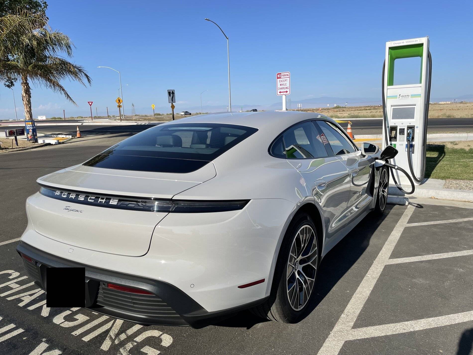

The only station I had trouble with was Bakersfield. There were 4 stations in total, and 1 and 3 were in use when I pulled up. I pulled into 2 and plugged in. I got to the payment screen, which is usually a good sign. I then initiated the session from the app as usual. It spun for a long time saying Initiating Charging..., but then eventually timed out and failed. I switched to spot 4 only to find that station saying it was Unavailable. At this point the other drivers who were charging noticed I was having issues and I ended up chatting with them. I ended up taking station 1 when one of them left, and started the session with no issues.

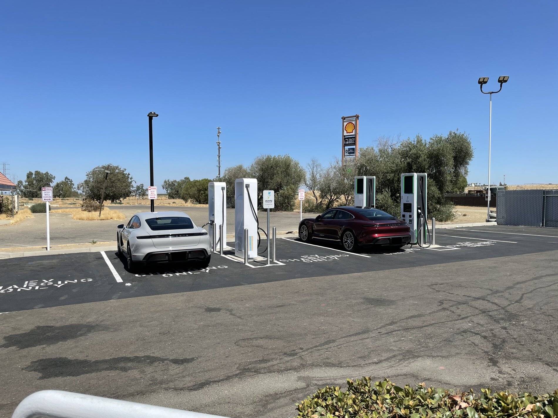

I also had the pleasure of running into @Torv 's Cherry Red 4S by pure coincidence when charging in Firebaugh, though I missed the man himself :) Due to the unexpectedly good efficiency of the Taycan, ABRP had me stopping Firebaugh and charging up to 70% before continuing on to Bakersfield, but I actually arrived with 70% charge and so it just ended up being a bathroom break plus surplus charging. It also helped me charge for less time at Bakersfield, since naturally I pulled up to that station with more charge than ABRP expected as well. My Chalk and @Torv 4S:

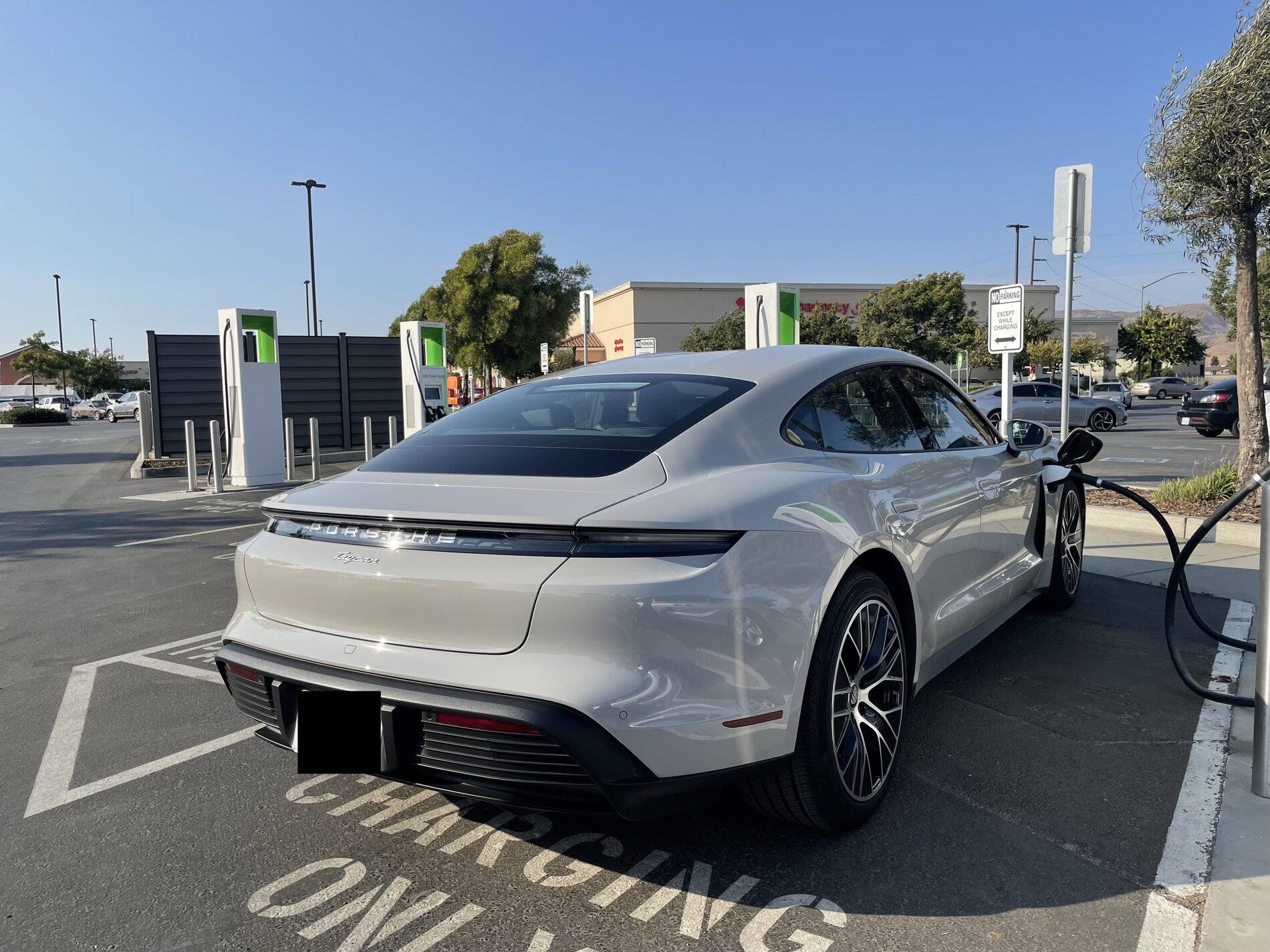

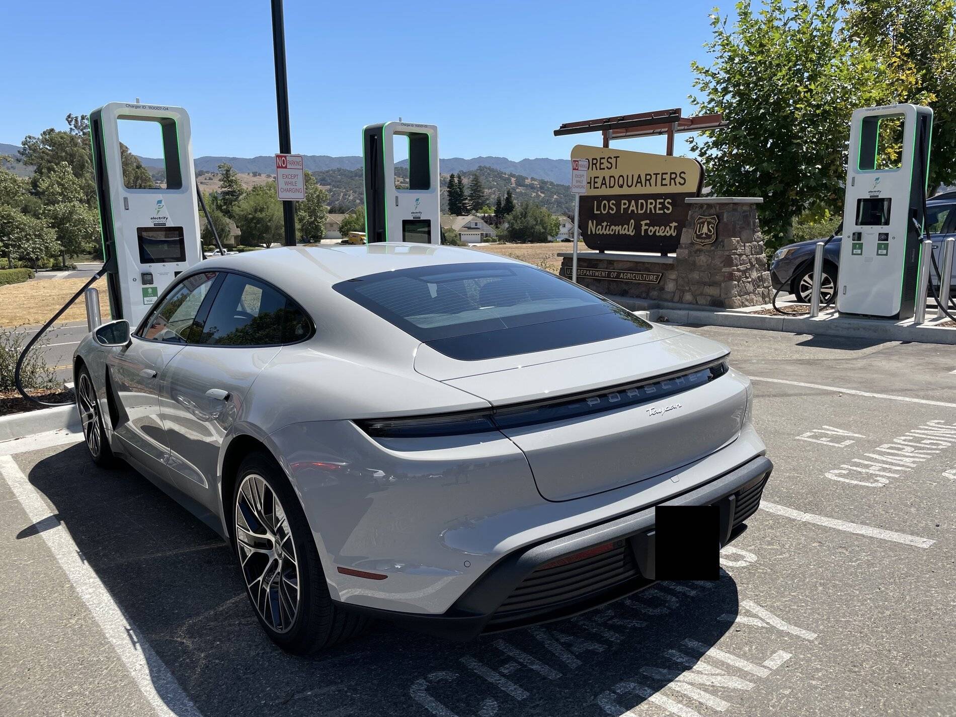

Charging in Solvang:
Spotted EA using Teamviewer to remote into the station? :CWL:

Charging in Soledad:
Charging in Bakersfield:

Great writeup. I just did the same trip. Some data.
Route: LA to San Jose area via i5. Left about 2pm.
Total miles: 336
Consumption: 310
Speed: 66 average, with many times much faster than that given the 70 mph limit which if you drive at, you are being passed .
Outside Temp: majority of trip: 100-109.
AC: 70 set at auto.
Charging. 1 stop - charged from 50 to 92 in about 25 minutes at a 150 charger which was enough time for a burger, frosty and bathroom break. Arrived home with 21 percent left. The battery temp was close to 100 so that probably helped the speed.
