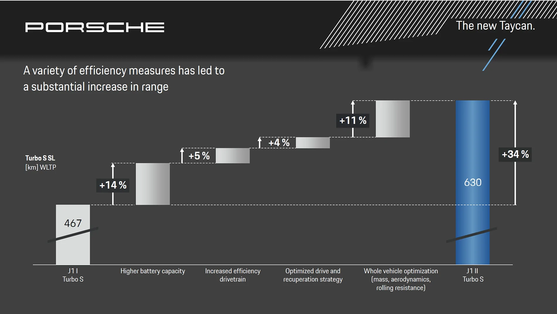

Range - This also is a surprise with very little gain that you are reporting where the increase should be in as high as 35% increase vs. J1.1. and I have corporate graphs that show how these gains were achieved.
I should have said I had a 4S with the performance battery and max range at full was 285+ depending on temperature. The GTS so far would work out at about 315+ with a full charge, but I‘m expecting that to improve with warmer weather and longer journeys.
I get it, this is not apples to apples if you stating your Range under different temp and potentially wheel/tire differences, but this is corporate claim below. I know this is all marketing and measured in unrealistic WLTP (why EU does that, escapes me if it has 25%+ error vs. reality or more). The point of the slide is that they worked really hard on the Range and I assume even tires are narrower now for better range. I like my wide J1.1 tires, except that there are really no choices in 21 inch All Season but Continentals.
