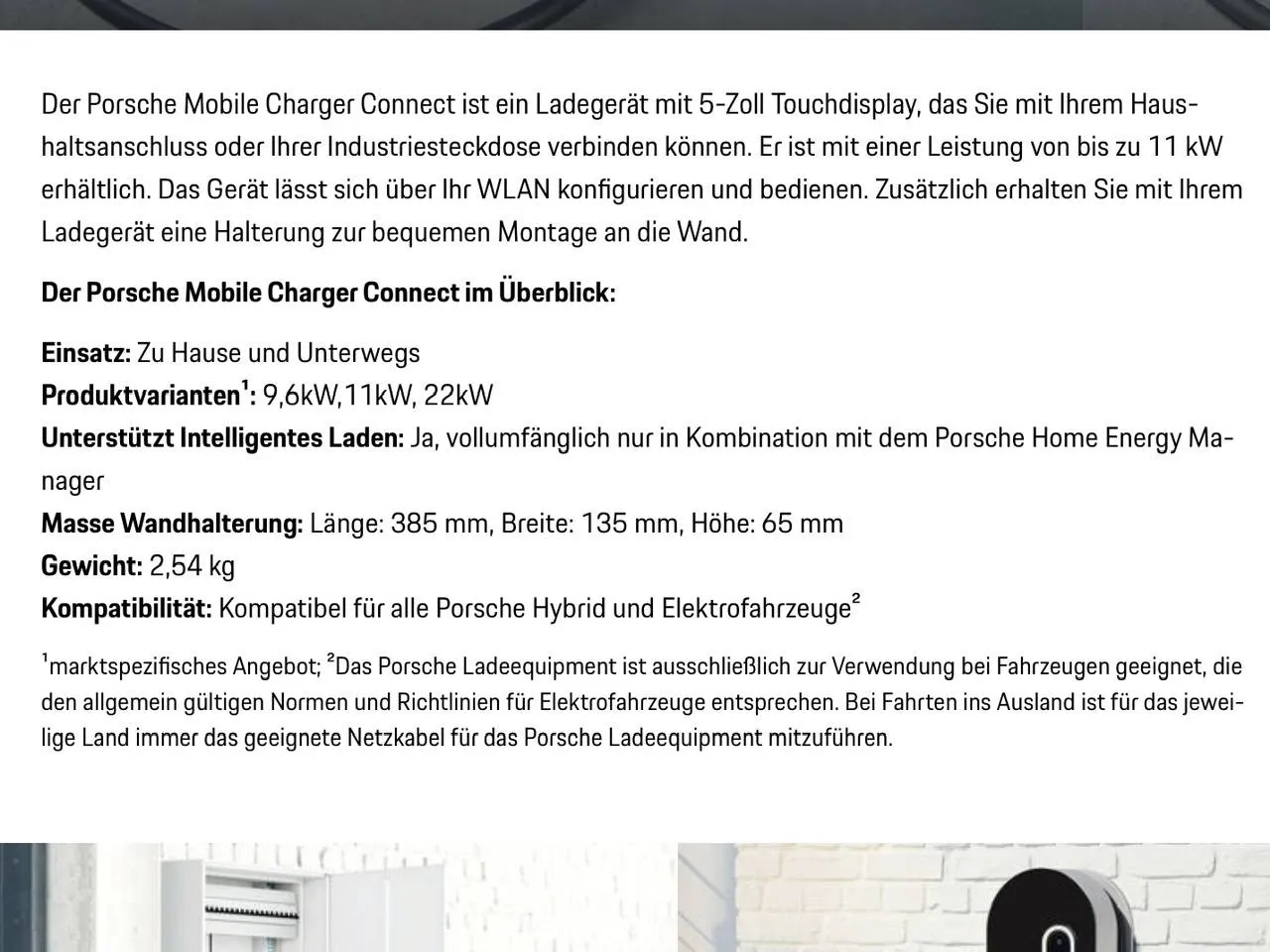

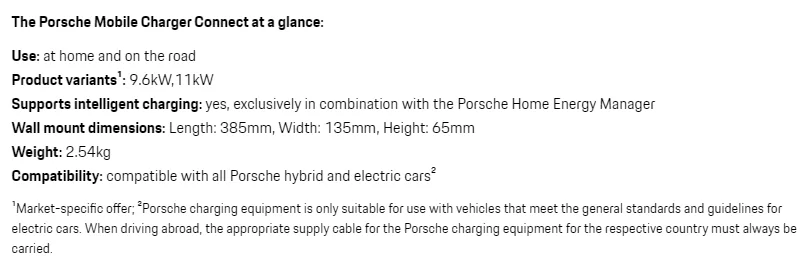

No this info is outdated. The PMCC can now do 22kW and why I waited on my order until now as I have 32A at home. So cuts charging time in half at home.
I was actually confused about the Porsche Switzerland website not listing this and they actually updated it after I asked the question :) .
That being said it is still incorrect in the second line but then correct and updated in the “Produktvarianten“ line that lists 9,6, 11 and 22 kW.
Porsche Taycan 400v 16amp.  or 32amp C2AB08ED-002F-4232-8BF8-B3D7449DD3CB

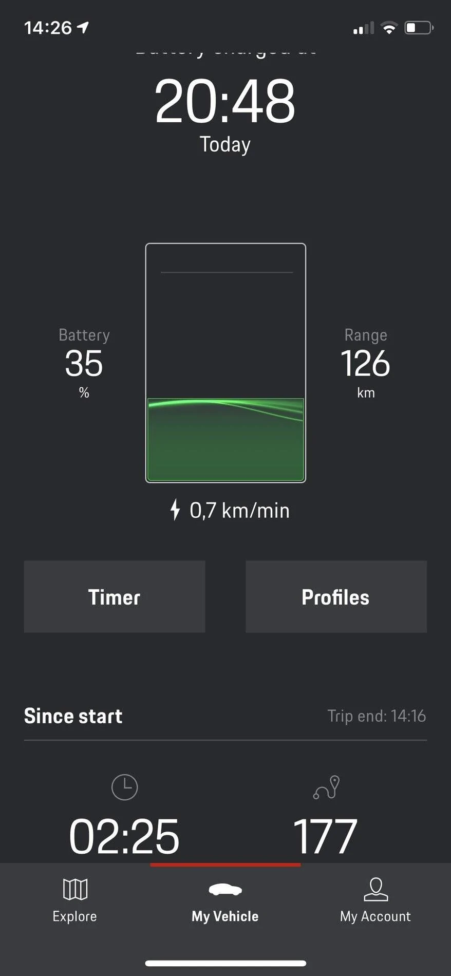

3,081
2,678
There are as you say a number of different PMCC available. I have one that came with the Car from March of this year and it can charge at Max 22 kW. I have tried it with a friends Zoe and it worked just fine. Zoe is well known to be troublesome to charge as well.
For me the limiting factor is the charger in the car.

0.7km/min
this in my 400 triphase 16 amp and 11 kw
