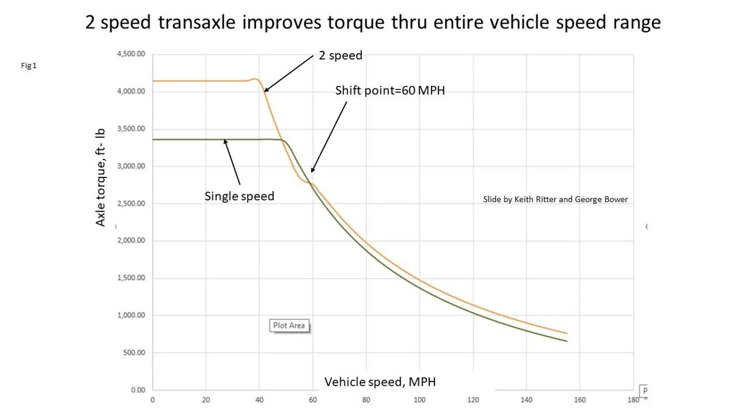

I think the 2 speed transmission makes sense if you need high efficiency and high torque at high speeds ( >100 mph)
The wheel torque will be the same in either gear once you reach the constant HP range of the motor. This is around 30mph in first and 60mph in second. So, the most wheel torque is available below 30mph and starts to drop off from there. And by 60mph, wheel torque is the same in either gear.
But…the motor also has a max speed. In first, it can’t even reach 100mph (I don’t think it can even reach 90).
Really, IMO, I think that if Porsche only had one gear, it would be similar if not identical to the existing second gear.
That makes first gear the “extra” gear, and the purpose is increased wheel torque at lower car speeds for higher acceleration. Basically, optimizing acceleration for the available power.

Totally agree with you regarding the effect of gearing (or lack there of) once the motor is in the constant power band (torque x rpm = constant). I suspect the gains are predominantly in the lower rpm range where the torque is flat (power goes linearly with rpm). Here is an interesting article that talks about the impact of the 2-speed transmission on overall performance:
https://insideevs.com/news/343827/porsche-taycan-2-speed-rear-transaxle-performance-modeled/
The axle torque vs. speed graph from that article is pasted below:
Porsche Taycan 6200 miles and counting: 2021 Taycan 4S impressions 1657138805580
Interesting to note that outside the ~50-60 MPH band, the 2-gear option does seem to deliver more power at any given speed (using the gear ratios used in their model). I think gearing or other power delivery optimization tricks will boil down to efficiency/performance/complexity(cost) trade-offs that each vehicle manufacturer decides to optimize. All this may be entirely academic and we will very likely choose a vehicle based on our transportation needs, driving taste and budgets 😃.
