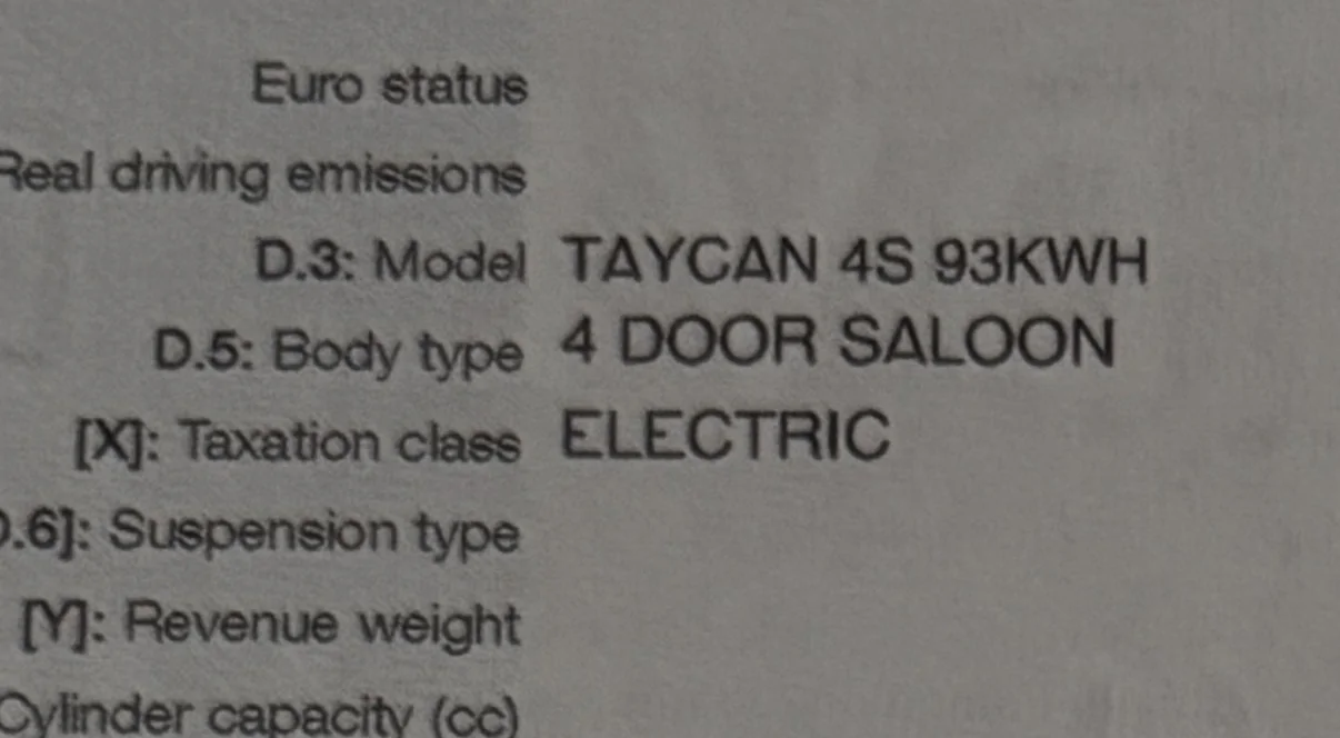

As mentioned by the others, go to the app, click on the garage icon on the top right. Then technical details and options.
Porsche Taycan 79KWH or 93KWH battery ? Log book IMG_9513
In the uk the v5c also states the 93kw battery
Porsche Taycan 79KWH or 93KWH battery ? Log book IMG_9514

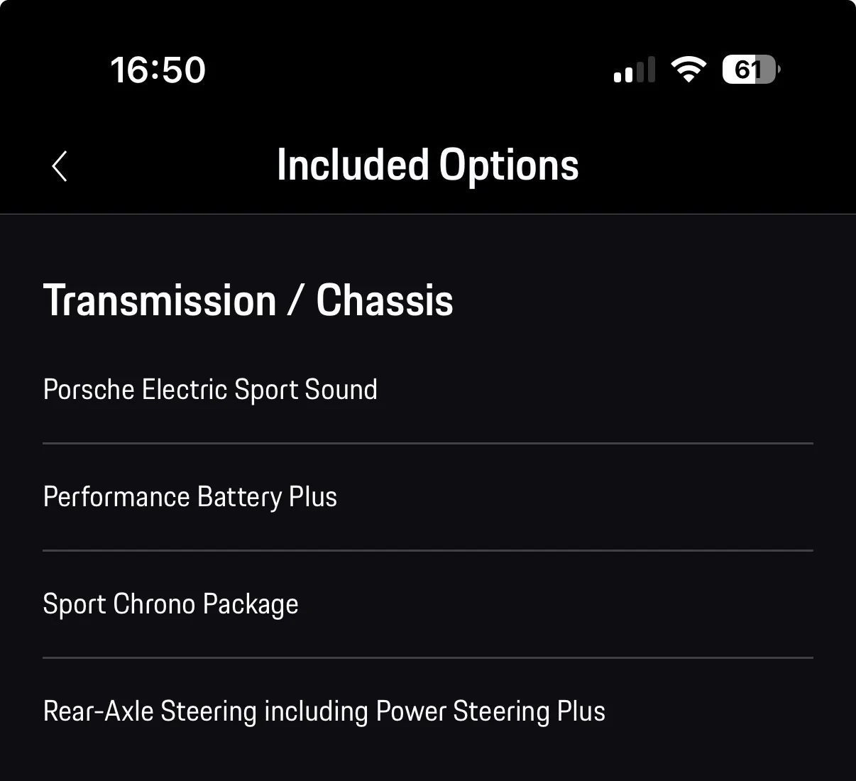

Ok so thanks for the advice to check the garage icon In the app, as it does state PBP see screenshot / but it also states 79KWH. Could do with some decent advice here - See screenshots-
Porsche Taycan 79KWH or 93KWH battery ? Log book IMG_5095
Porsche Taycan 79KWH or 93KWH battery ? Log book IMG_5094

Standard equipment is ofc the 79kwh one. You just proved that you have the bigger one since it is listed. Share your VIN as @prj is suggesting so we can confirm it for you.
If you don't want to share, just enter trip data since last charging into chatgpt and let it calculate it for you. You need to know the SoC before and after. The distance and the consumption.

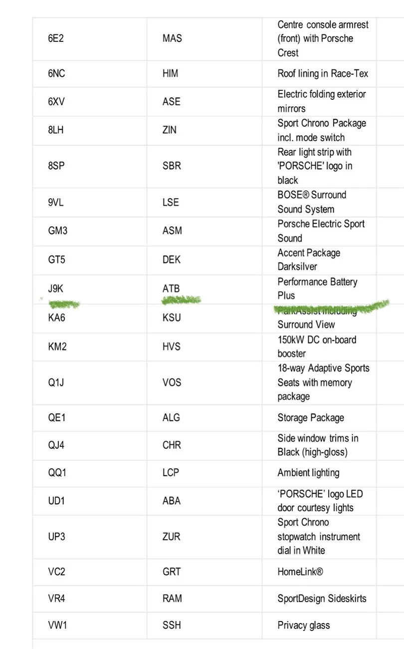

Does this help with checking the code ?
Porsche Taycan 79KWH or 93KWH battery ? Log book IMG_5074
