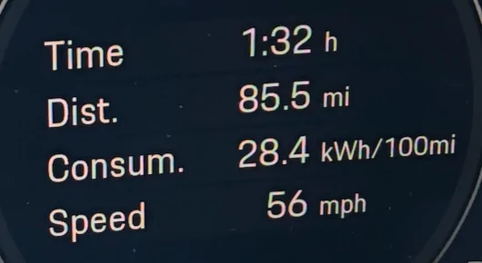

Yesterday my wife and I had a small project to do that was about 85 miles away so decided to experiment with two different driving styles there and back to compare range. This is certainly not a scientific study but here’s what I found. The drive is mostly flat, about 80% highway and the remaining 20% on side roads with 35 – 45mph speed limits and relatively few stop signs/lights. On the way there, I drove in a style to get good ‘mileage’ and on the return I did a spirited drive. I have a 4S with 20” all seasons. Weather was clear and about 58F both ways. Battery was not preconditioned either way and the car sat for about 3 hours outdoors charging on a Clipper Creek in between. Battery was 66F starting the first leg and 78F starting the return leg.
Implied total range on the drive there was about 300 miles and on the return was about 250 miles. This is really pretty encouraging to me knowing that I can count on total range between 250 – 300 miles in decent weather and that I can control where in that range I am with driving style.
On the way there, I ran in Range mode, mostly on cruise control and stayed under 70mph. – total trip duration of 1:32hours and 28.4 kWh/100miles. I left with 85% SOC and arrived at 57%. Total implied range of about 303 miles. I was mostly between 65 - 70mph, so maybe I could eek a bit more range out if I stayed closer to 60-65mph (which is really hard to do lol).

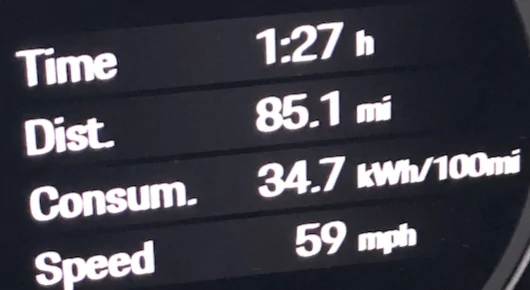

On the way back, I ran in mostly Sport+ mode at higher speeds. Total trip duration of 1:27hours and 34.7kwh/100 miles. I left with 85% SOC and arrived at 51%. Total implied range of about 250 miles. The battery was a warm 78F to start the return trip so probably that helped improve range some.
