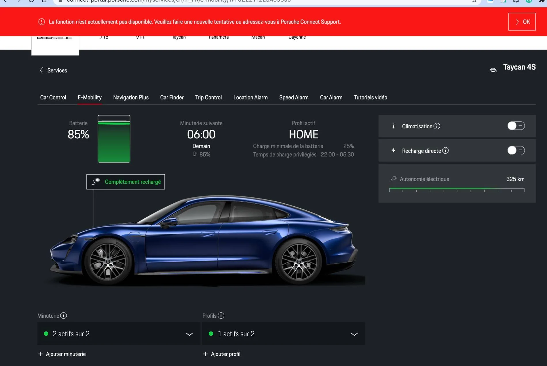

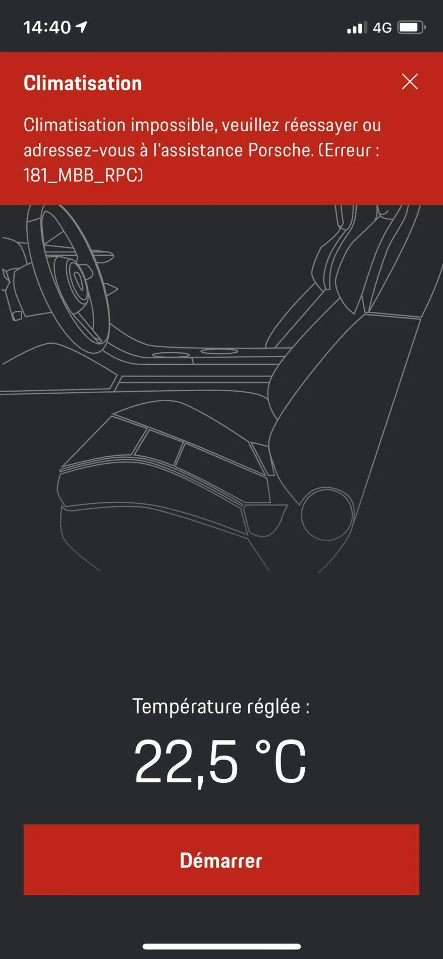

Hi, does anyone experience an issue with the AC. Since last Saturday, my AC is U/S or not available. Not sure if in relation, but Connect is also for quite some time very slow, not connecting, or only randomly to the PCM, but data of the last trip, charge are still updating.
When trying to start the AC via the Connect, App I got the following fault code: 181_MBB_RPC
PS: is there a way to reset the PCM or dig deeper into the system for troubleshooting?

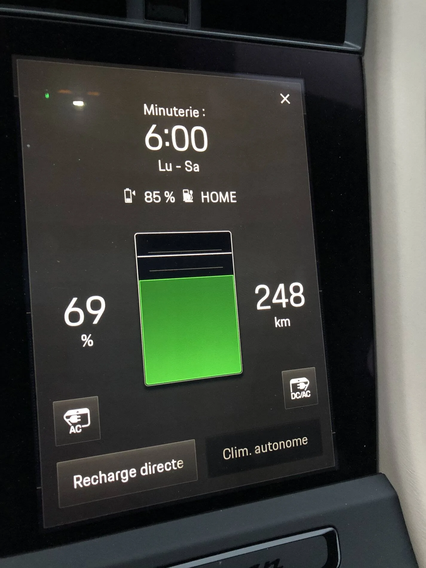

Could it be related to a software issue deactivating the AC? As you can see in the picture with the pedestal, the remote heating is not available. Also, direct charge via Connect is not working, even when the connection to the server seems ok.
I recently experienced, that the target charge was not respected. i.e. 85% and finally the car was charged at 91%. Solved the issue by deleting and setting new ones.

eco mode ac is the problem
I tried all possible settings, but at that stage no way to confirm whatsoever... the only thing I see is that remote AC in the car can’t be selected (not talking about Connect, which is at current time useless). When you read the different post, it looks as this is just the point of iceberg.

Yesterday, less than 1,5 days later, I got my car back from the dealer. That was quick one, and all my issues are solved. For the heating, it was an internal failure of HV heater (low voltage side), and for Connect, they had to reset/unlock the SIM card module (I guess it’s combined with the OTA) by using the diagnostic computer.
Now I have almost instant access to the car via the App, even with weak cellular network.
