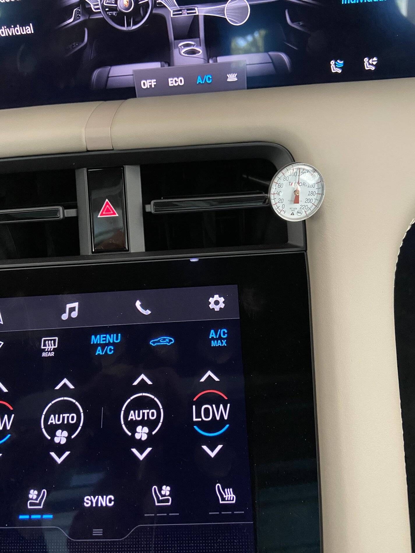

New 4S. 82 degrees outside and Max AC blowing 100+ degrees inside. Think I have a problem. Photo above
You do. 88 today in MN, just took a 100 mile trip. In range mode with AC in Eco temp inside was a non-issue - to the point that I actually increased the set temp from 70 to 72F.
